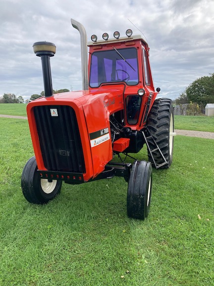

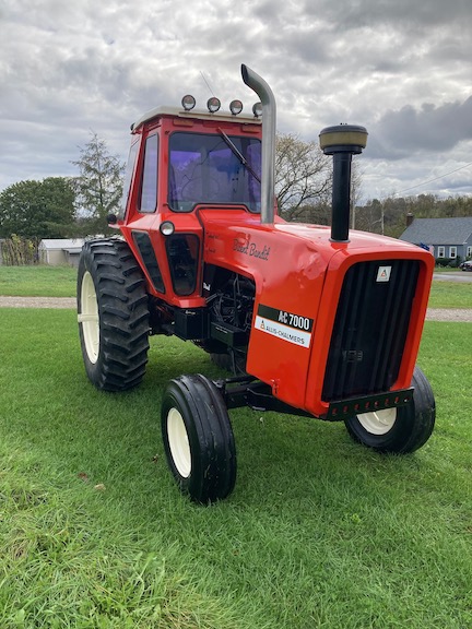

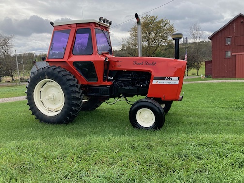

Looks good. Did you get your leaks stopped? what were they?
Posted By: Mikez
Date Posted: 04 Nov 2021 at 10:55pm
nice.
Are the windows tinted

wasn't there an update for the valve cover bolts? my gasket was leaking some on my 7010 and when the dealer replaced it, they put little springs at each hole that the bolts went thru. and that's a mighty nice looking tractor Capt!

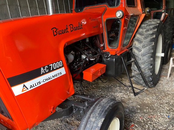

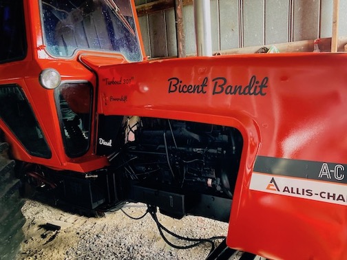

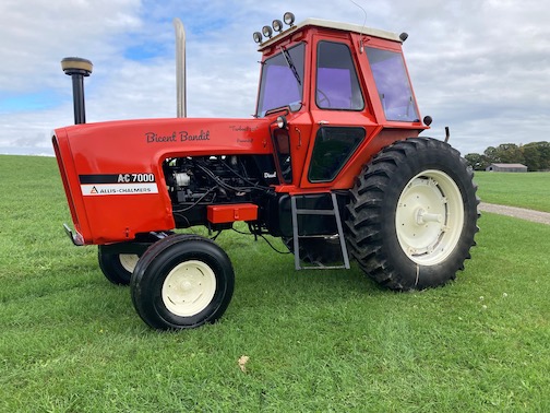

Hello all I’ve been waiting on parts…plus flying too moch plus working on her big sister 7020! Words of wisdom…do not buy 4 tractors in 2 months and try to make ‘em all brand new at once while working full time!! I installed a new PTO in the 7000 (custom made by bunker hill) and am awaiting new brakes, belts and valve cover gasket with improved fasteners. She has new front tires now and a new BL rim. As for the ‘20 Brenda just shipped the belts, trans filters, lots more. I bought 2 newer rear rims for her also and will buy a new air ride seat. Hey I gotta go and fly to Mena Ar. See ya. Dana

One sharp looking machine !!!
