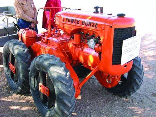

How 'bout a skidsteer variation?
Posted By: Reindeer
Date Posted: 13 Sep 2010 at 4:36pm
There were some tandem tractor setups done prior to the advent of the large 4WD units.  I found some video of different models at:
http://www.youtube.com/watch?v=F-YK_rF1CB4&feature=related - http://www.youtube.com/watch?v=F-YK_rF1CB4&feature=related
Something like this perhaps?
Posted By: MNLonnie
Date Posted: 13 Sep 2010 at 4:55pm
I've seen pics of that Power House version before, would I ever love to have one of those.
Posted By: AllisChalmers37
Date Posted: 13 Sep 2010 at 4:59pm
Is the Power Horse  custom built? If so they did a good job.
Posted By: MNLonnie
Date Posted: 13 Sep 2010 at 5:10pm
If I remember right a company in Nevada or Utah built them??

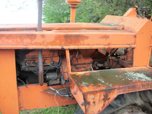

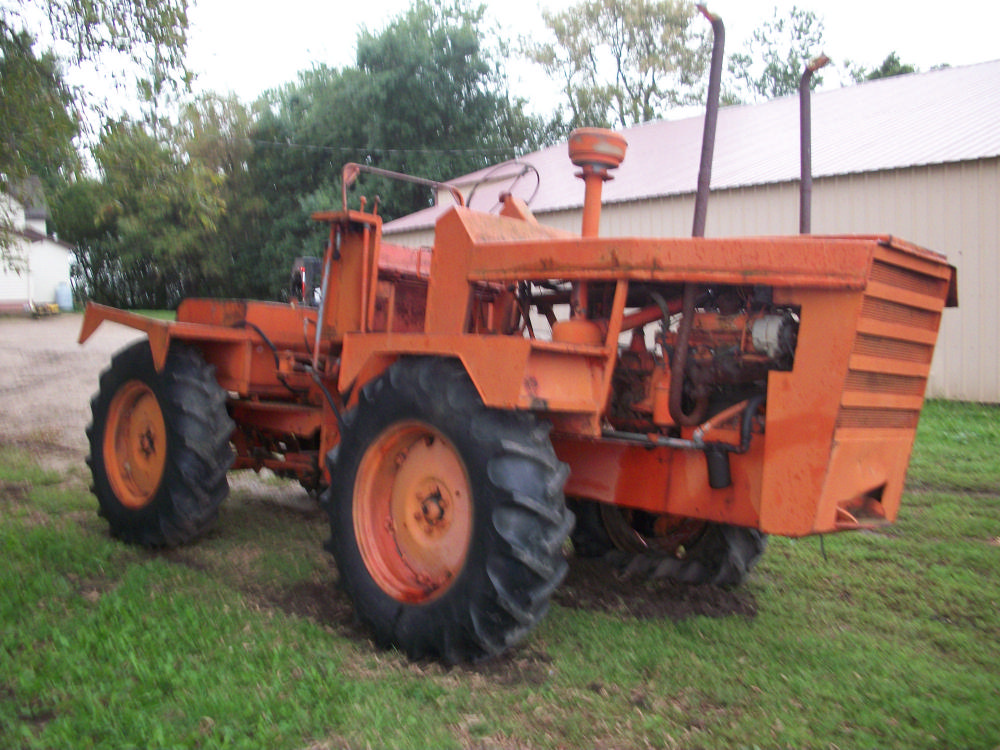

Posted By: 40chevmudder
Date Posted: 13 Sep 2010 at 7:16pm
Date Posted: 13 Sep 2010 at 7:17pm
Date Posted: 13 Sep 2010 at 7:19pm
hey i figured it out!!!!!!!
Posted By: MNLonnie
Date Posted: 13 Sep 2010 at 7:44pm
That looks a lot like the first one pictured in this post. Looks like a real work horse. Are you going to make it to Albany this weekend?

Posted By: CJohnS MI
Date Posted: 13 Sep 2010 at 8:04pm
Originally posted by 40chevmudder 40chevmudder wrote:
40chevmudder, that looks like the real deal!

Date Posted: 13 Sep 2010 at 8:05pm
No, they were an actual manufacturer. Here's the link to the article I borrowed the picture from:
http://www.hemmings.com/hmn/stories/2009/10/01/hmn_feature23.html - http://www.hemmings.com/hmn/stories/2009/10/01/hmn_feature23.html
Date Posted: 13 Sep 2010 at 8:08pm
YES!!! There it is. Looks different but good.
Date Posted: 13 Sep 2010 at 8:19pm
Wow! Your memory is working very well - a lot better than mine!
The Power Horse was considered one of the first ''skid steer'' tractors.
Albert Bonham of Salt Lake City, Utah, designed the original Eimco Power Horse in the mid-1930s. They were only produced under the Eimco Company brand name for a few years. They were then sold under the Bonham name until the early '40s. The Power Horse tractor was built at several different facilities in Utah. Parts for the Eimco and Bonham units were purchased from Allis-Chalmers, including the hood, transmission and their model B-125 engine. The Chalmers B-125 engine had a 3-3/8-inch bore and a 3-1/2-inch stroke rated at 22.3hp at 1,400 RPM. The hood of the Power Horse closely resembled the Allis Chalmers B and WC model tractors of the '30s. Allis-Chalmers showed some interest in the design from their previous dealings with the Bonhams, and eventually bought the patent and hired Albert Bonham in 1942 in the hopes they could produce a more marketable Power Horse by war's end. Allis-Chalmers built only one known prototype and never produced any of the tractors under the A-C name. The Harris Manufacturing Company of Stockton, California, obtained production rights and began marketing the Power Horses in 1949. Production continued up into the early '60s.

Looking at this, the engines are coupled, but they have exhaust on opposite sides?
Charlie
Posted By: DREAM
Date Posted: 14 Sep 2010 at 9:34pm
389 Pontiac V-8. Was it governed I wonder? Did they make an industrial/power unit engine that had governors like Ford/Chrysler/other GMs? I supposed a governor could be adapted to almost any engine. Looks like it is a hoss. Really would have been in its' day i'm sure. Fun project. Keep us posted with progress pics.

the 389 has a pully ran governer on a 2 barrel carb, my plan is to get the tires on it and intot he shop, i have 1 other project to finish before i start this one.
