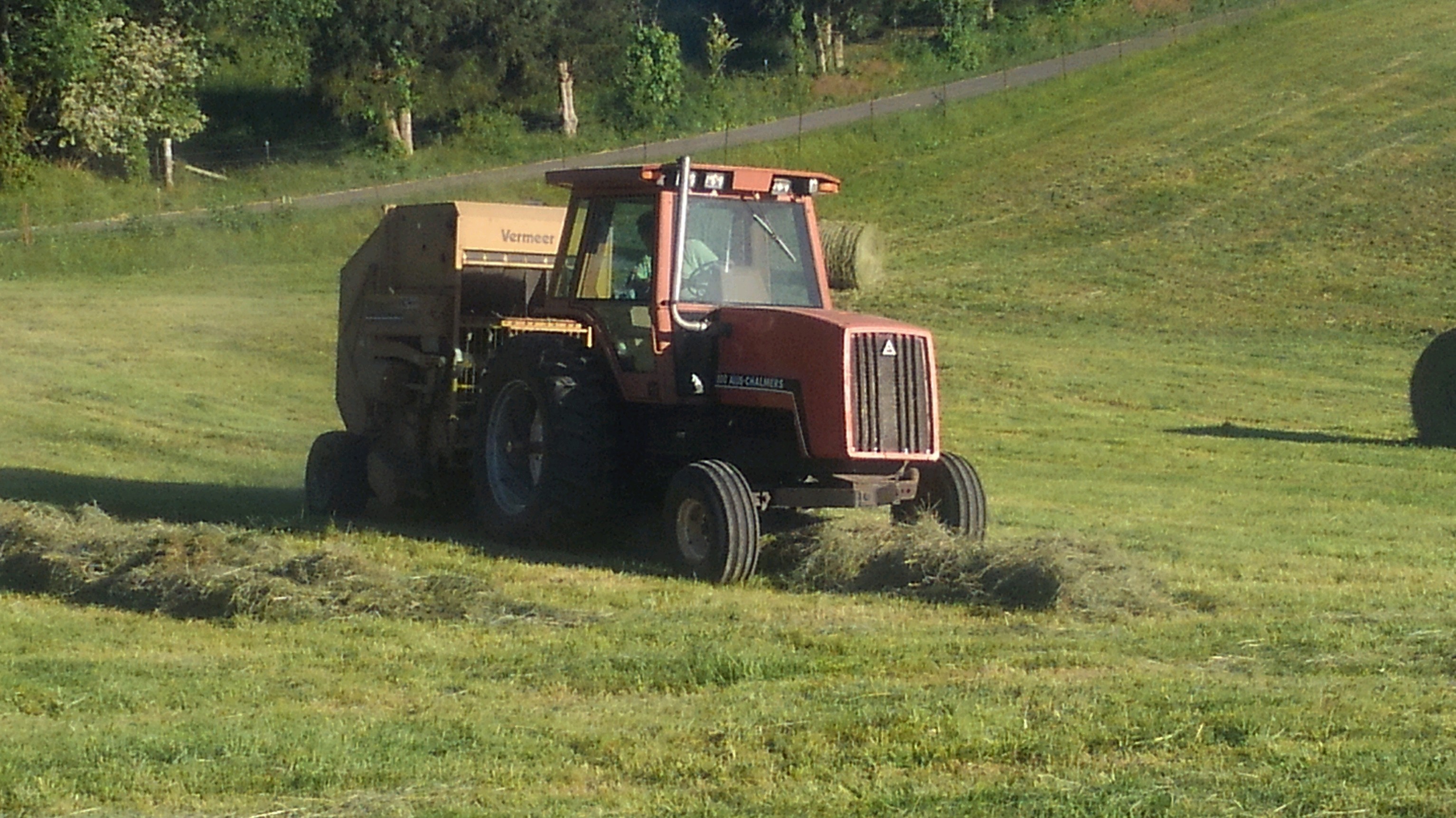

8030 I use a 8010 4x6 and like it but if I was looking at another 8000 series it would be 8030 P.S. period. Just my opinion. We are talking 38 year old tractors. If you find either with low hours ya better jump on it.
Posted By: Moneypit
Date Posted: 11 Jun 2020 at 11:11am
Yes just keep the rpms up. I use this he foot control a lot
