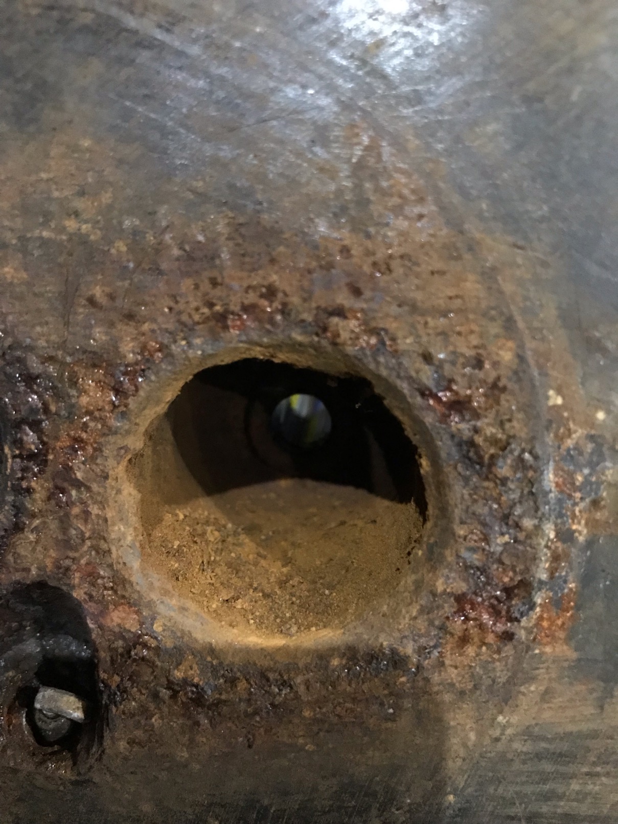

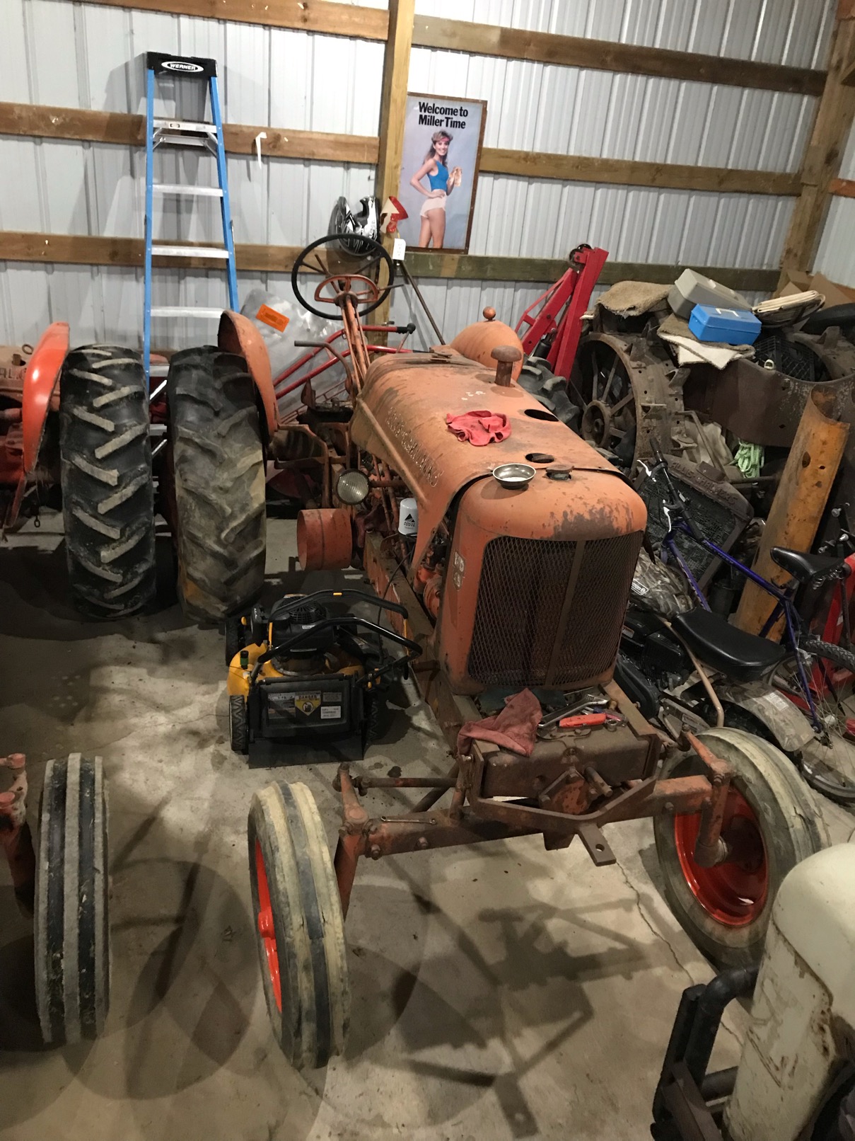

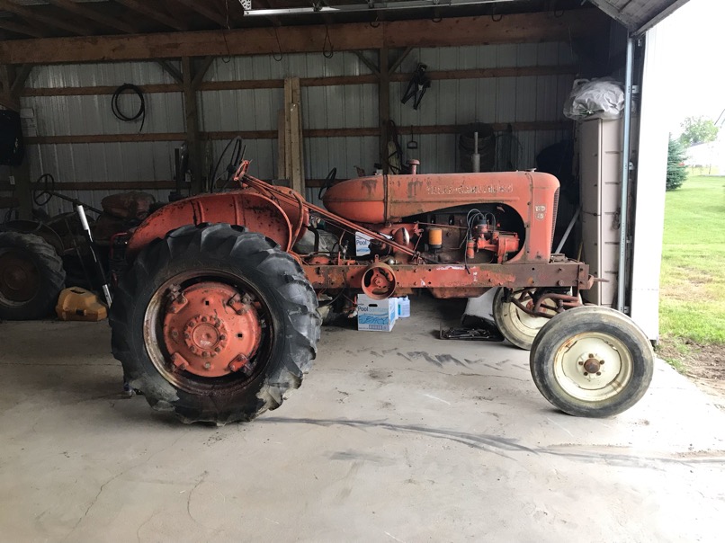

Got my wd45 I lost at the auction back in November the man who out bid me and lost interest put it on the trailer and sat there until now. Took off and sold loader and the other bad thing was told that the trans and rear end where seized up but it was both brakes froze up the trains and rear are of the cleanest I’ve ever seen. Motor on the other hand is wow bad so as soon as a get a couple extra bucks I’ll get new sleeves and pistons. Reason I wanted this tractor so bad is the backstory. The coolest thing that not many tractors have is the complete history from new. This 1954 wd45 was bought new late summer of 1954 in Yale Michigan at tenniswood equipment. The original owner had a chopper that him and a neighbor bought and his John Deere b and the neighbors framall h couldn’t run it good enough. So the owner to a trip to Yale and they had this in the showroom and he told them to bring it out and if it would run the chopper he’d take it. His son said it came about dinner time and the salesman told him to eat dinner he would hook it up and adjust everything and have it ready when he was done. It was awesome and it stayed on the same farm in avoca mi until now. It was rebuilt in the 1970s and was given d17 engine upgrade then I was told. But not used to much after that. It had sat in the bushes completely covered from the late 90s till now. I’m going to stop and visit next week and see if I can find out any more info on the tractor from it’s work days. But I do know it will be getting a new rebuild and will run for the first time in 20 years. And next year will get some nice new paint.
Replies:
Posted By: DrAllis
Date Posted: 19 Jul 2019 at 6:39pm
Given a "D-17 engine upgrade" is interesting. Those look like WD-45 pistons to me unless they are 4 1/8" bore. A D-17 gas engine as-is will not fit in a WD-45. The water pump and crankshaft pulley have to be changed, along with the flywheel and clutch assembly.
Posted By: ryanschott
Date Posted: 19 Jul 2019 at 6:45pm
The pistons have a smooth easy bowl not like the wd45 where there is a large around outside of piston then drops off deep fast. These drop of right away but are gradual like lenses for glasses
Date Posted: 19 Jul 2019 at 6:46pm
Not deep either so I assume that would raise compression and give you more hp
Posted By: DrAllis
Date Posted: 19 Jul 2019 at 6:55pm
WD-45's are a smooth "cereal bowl" design. The D-17's were a flat bottom with a thick ring around the outside. Are they 4 inch ?? or 4 1/8" ?
Date Posted: 19 Jul 2019 at 7:03pm
I will have to measure at work right now but ya I would say cereal bowl.

Maybe a case of not remembering or someone got ripped off but as drallis says it looks to be regular wd45 motor stuff and it is a 4 inch bore
Date Posted: 19 Jul 2019 at 10:49pm
But I learned some stuff today I once had a wd45 that had the deep bowl pistons and I thought that was what a wd45 was supposed to have but I see now that the 45 has the easy slope pistons
Posted By: DrAllis
Date Posted: 19 Jul 2019 at 10:59pm
The original design of the famous "Power Crater" bowls in the WD-45 were the smooth cereal bowl dish design. When the D-17 came along they redesigned the bowl to be flat on the bottom and the ring design on top.  There have been after-market pistons made with the smooth cereal bowl design, but they are usually 4 1/8" bore.

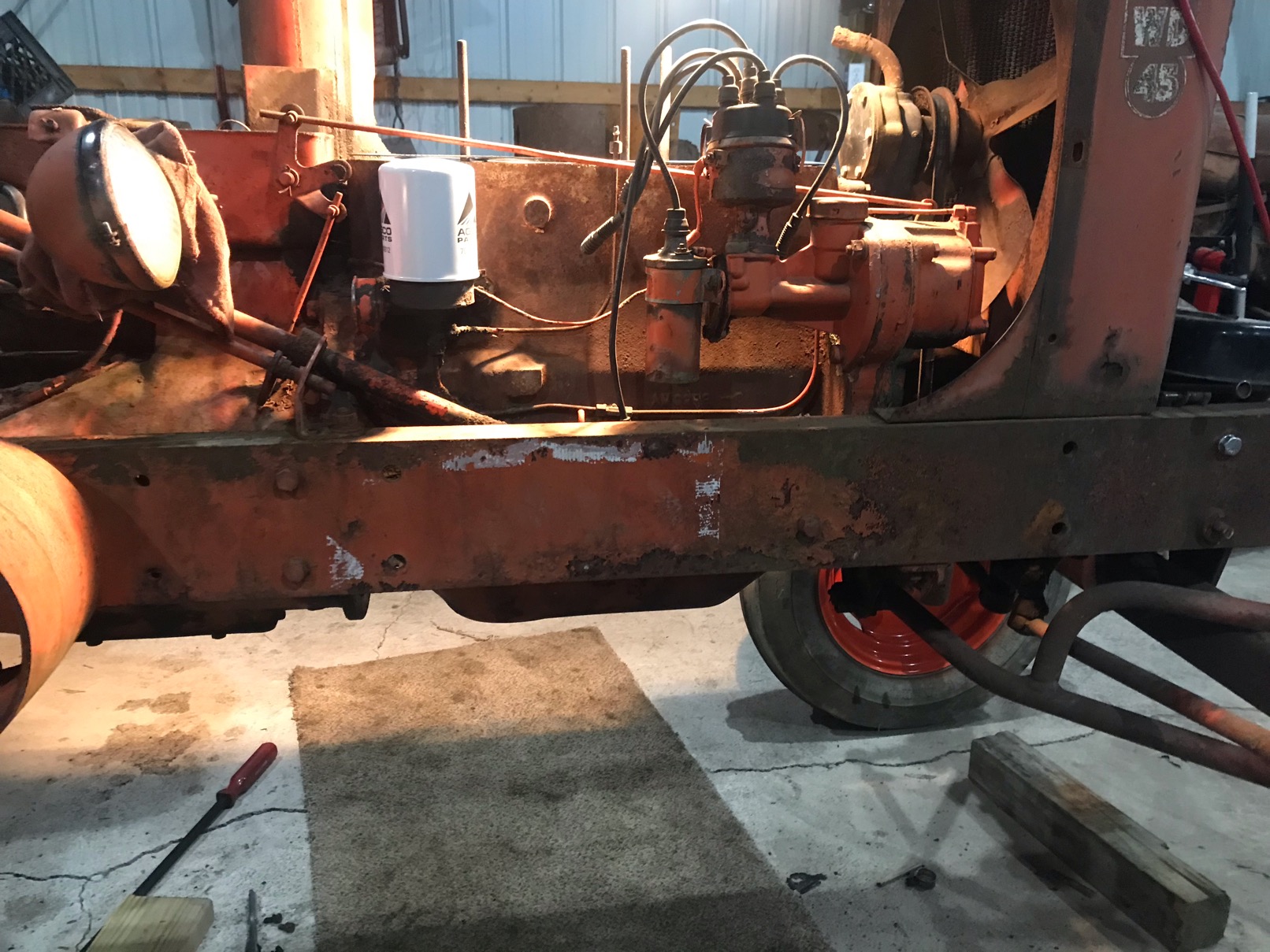

Cleaned up a bunch of parts like the oil pan and rods and a few other parts on the motor. Been working a lot of overtime so hopefully in next couple weeks I’ll be getting the pistons and sleeves. The $250 set on amazon is now $450so have been looking at a couple other piston sets. When I do get this back together is there a way to prime the oil system. Getting kind of excited to hear this tractor run. Took out the cloride out the tire since was leaking all over my barn and put in a new valve stem. But will need a new rim when I restore it cause the one is beyond the point of saving. Other rim is loaded and is spotless rust free. That too will get emptied.
Date Posted: 27 Sep 2019 at 3:40am

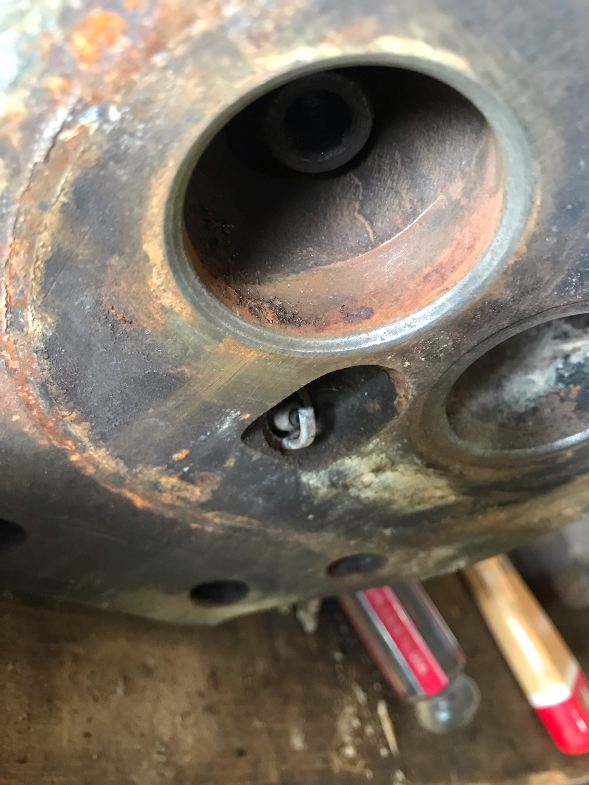

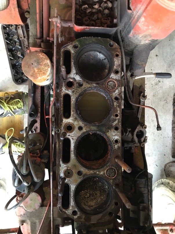

Also going to send head out to get cleaned. Looks like some one has been here before and put new seats in a few places I too will need some new seats on a couple. Also going to have him deck head just a little to clean up and make sure it’s straight. Valves don’t look too bad so going to let them ride. Don’t know if I said earlier but was told that it was rebuilt in the 70s and the bearings have 7 76 stamped in them.
Date Posted: 27 Sep 2019 at 3:45am
In first pic the exhaust valve looks sunken are they all like that or has it been replaced. Has anybody ever port and polished heads before or is it so slow reving that won’t make difference
Posted By: DrAllis
Date Posted: 28 Sep 2019 at 6:37am
Not worth the time and effort. Your mind will be convinced it runs "better", but only a dyno test before and after the porting and polishing would tell you for sure.
Posted By: SteveM C/IL
Date Posted: 28 Sep 2019 at 10:13am
I was thinking the seats were a bit short like show and staked around OD to hold them in place.....not certain but know they need staked.

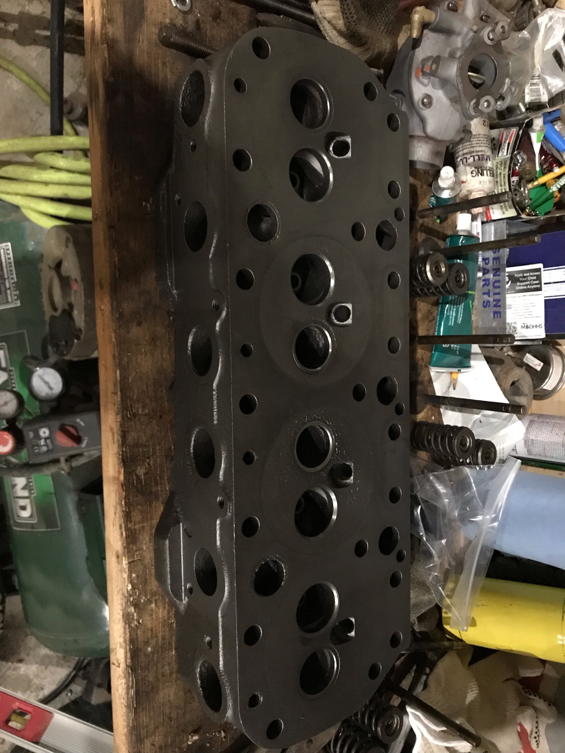

Date Posted: 15 Oct 2019 at 6:56pm
Just got head back from machine shop. Checked out good and he shot peened it and cleaned up good with some new seats and grounds the rest. Now have to seat the valves and put back together. Is very nice almost like new was lots of rust and crap. Now just need to find some money for the pistons and sleeves.

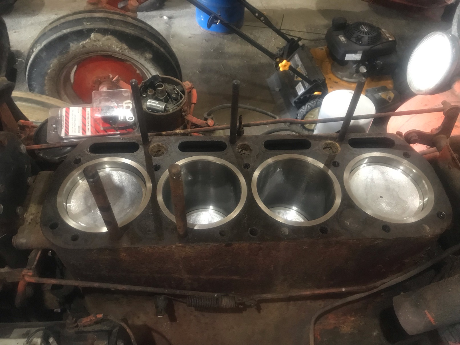

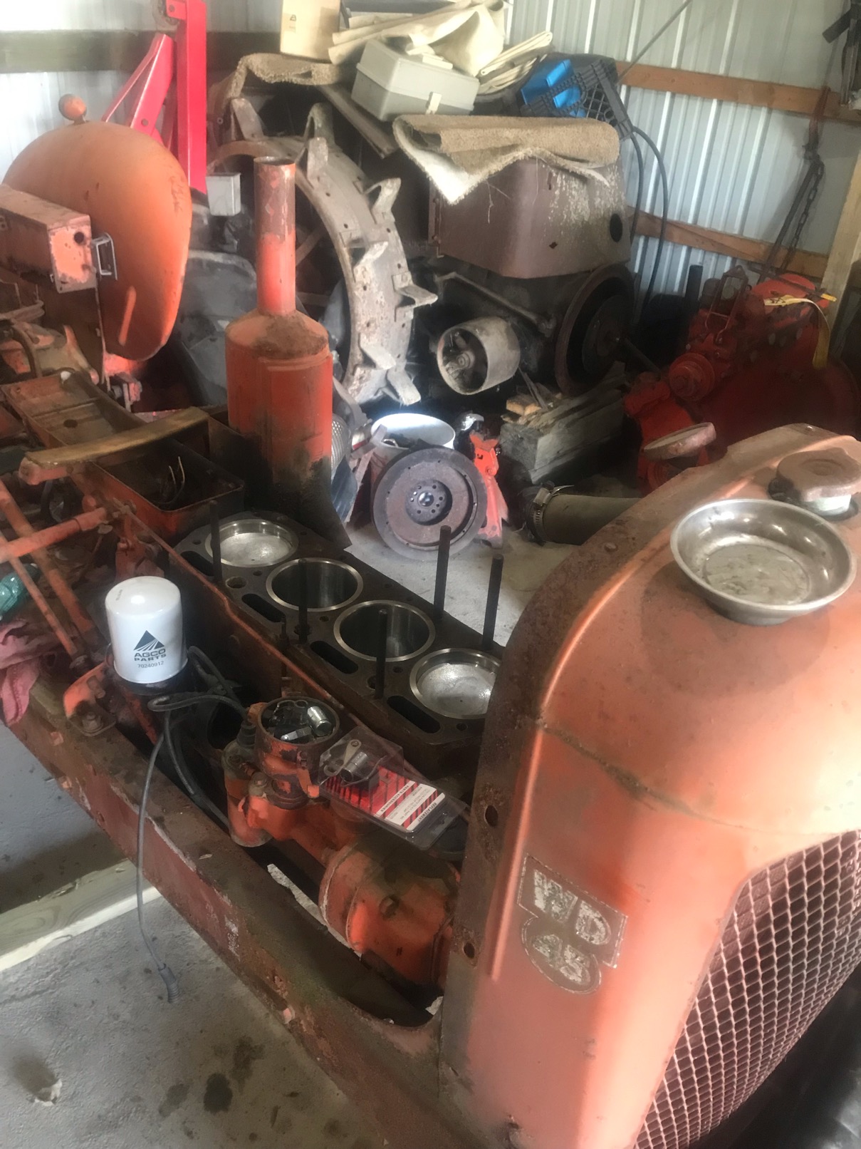

Date Posted: 27 Nov 2019 at 7:43pm
Ok progress is coming now got the sleeves and pistons in and hopefully tomorrow will have the pan on might be next week but should be done with the head and put that on. A little setback is the gas tank had some rust in it so took of to dip and clean and when I first looked in it now out in light there lots of vent holes on the bottom so not sure if I’ll will put patch on the bottom and line or buy another tank. Still also on the fence is 6v or 12 v the generator looks nice but all the wireing is junk and coil looks bad too so am leaning towards 12v. Also other motors I have done in the past the pistons seem to come almost flush with the top but these are as high as they go in the pics. All in all it went together very good and feels good. Used assembly lube on this motor i like it better then just oil. Am very pleased with the progress so far
Date Posted: 27 Nov 2019 at 9:50pm
Don't have much experience with these engines so I can't say if piston height is weird or not. Does seem a little low. Where'd they come from and whats' advertised C/R? Overbore or STD?
Date Posted: 28 Nov 2019 at 2:27pm
4 1/8 bore not sure on ratio. Can’t wait to hear it run
Posted By: JC-WI
Date Posted: 28 Nov 2019 at 2:47pm
Were the other engines with chambers in the head or were they flat like this engines head is...?
 Looks about right for piston height, but, if you put WD pistons in that WD45 crank... you will be high compressioned.  Shocked  Pullin tractor timeLOL
 and just buy 4 new exhaust valves and put in.
Date Posted: 28 Nov 2019 at 3:03pm
Just a lot off b or c motors seems like those pistons come right to the very top. Haven’t done a 226 motor in awhile and can’t remember must be getting old.

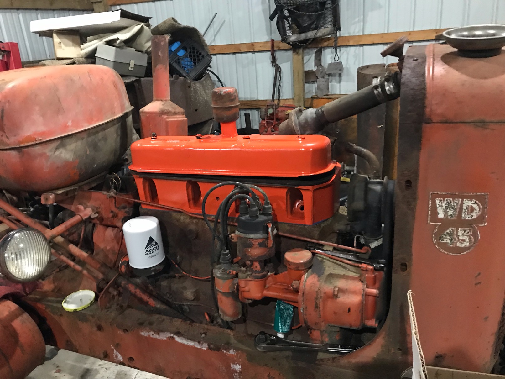

Date Posted: 09 Dec 2019 at 11:32am
Got the head on and rocker arms bolted down. Now need to set the rocker clearance and can finish up the motor. Found out the gas line is plugged solid with who knows what. Air wouldn’t blow threw it then have to work on manifold, wiring, and fuel system. Going to order a one wire alternator and brillman’s has a nice wd45 wire harness made for one wire alternator. Just need to save up a little money. Got new gas tank on there looks very clean inside but doesn’t have the numerous vent holes on the bottom side. Anything else you guys can think of I need to check I may have forgotten. Oh the air filter was filled with tons of crap what a mess. Might have original tar oil in it.

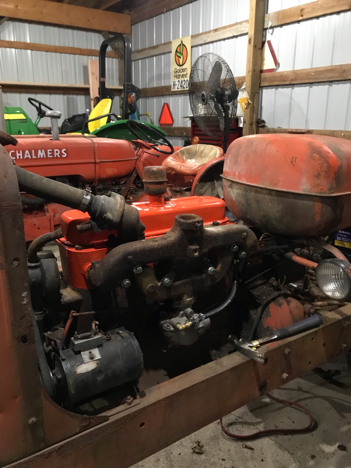

My son put Ford 302 exhaust and Chevy 350 intakes in my 45. Some he had saved back. (used) I couldn't believe how much better it started and ran.

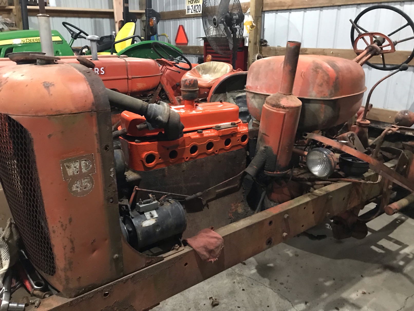

Date Posted: 18 Dec 2019 at 10:19am
Have the fuel delivery system all together. Just need a muffler, plug wires, a hotwire, and need to seal hand clutch cover and it should run. But all those things on Xmas list so might have to wait till then

Date Posted: 02 Jan 2020 at 8:40pm
Hopefully next week will have tractor running just waiting on a muffler now. Was going to buy a new one but the boneyard near me has a gleaner d17 motor on the skid still out of combine and looks good and has good muffler and Vinson manifold for cheap. . So going to wait till pay day next week and get that. Maybe do a gleaner powered puller like sugarmaker is working on. My thought where to do wd and strip it down to extreme lightweight class. I will get new muffler when I repaint tractor but for now use what I will have. But Tractor is coming along good just anxious to get it started and make sure everything gets lubed up and no problems. Then next thing will be to do electrical system which will be 12v with one wire alternator found a awesome wire harness from brillman at good price looks original and wired for the one wire. Plus I think headlights will get led inserts under the glass bulb. Look old but new. So hopefully will have a awesome update next week. Hope everyone had a great new years
Date Posted: 11 Jan 2020 at 7:55pm
It runs good had it running for over an hour today. Fired right up everything sounded great. A little louder exhaust wise but I’m the barn. Has a small manifold leak cause the far corner is rusted a little so might put an extra gasket in or get new manifold. Drove it around the yard feels very powerful compared to ones I had in the past. You can dump clutch and it doesn’t stutter just goes. Next I guess is work on the electrical system which needs to be completely replaced cause every bit of it is junk. Am very happy with how it turned out. Will put up a video when find out how.
Ryan
Posted By: Sugarmaker
Date Posted: 11 Jan 2020 at 8:25pm
Ryan,
 Congratulations on your WD45 engine overhaul! Looking forward to the video too. Those manifolds get washed out on the ends. That's pretty common. A machine shop can true it up for you.
Date Posted: 01 Feb 2020 at 11:28am
Just got some time to mess with it yesterday. It rust good but seems louder and harsher then should be. So I tried a little timing adjustment and it purrs. Wow what a big difference a few degrees makes. Just waiting to make a little extra cash and will be getting a new alternator and a wiring harness cause absolutely nothing is savable with the wires. Plus I’m going to get anew exhaust manifold cause the one end leaks and manifold is just ate out a little on the end. But local junk yard has a old d17/combine motor with new looking Vinson manifold and going to grab distributor too
Date Posted: 01 Feb 2020 at 6:16pm
Ryan,
 You will really like the upgrades to the electrical system too. I wire my own but Steve @B&B has complete kits too.
All those little details add up to smooth running tractor for a long time!
