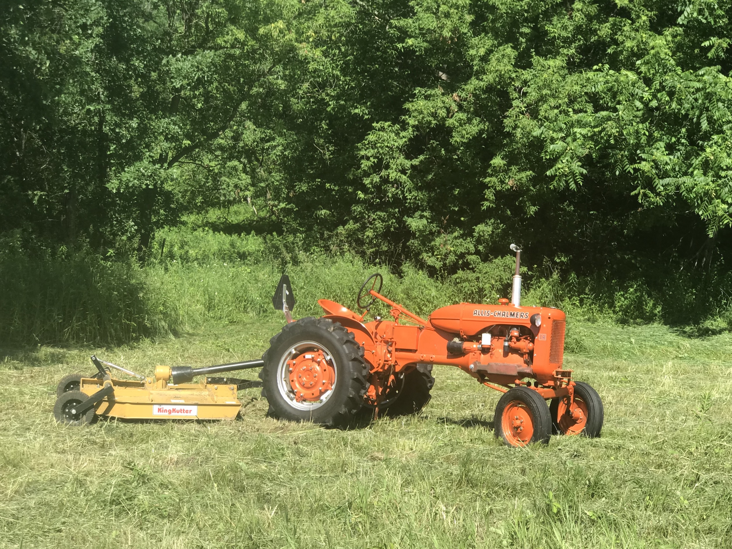

To mow in the orchard and back swathes we have run an offset, 5 foot PTO driven tow behind type with our CA, no problems. 3pt type is likely going to be heavy enough to make your front end light if not lift off the ground, unless you have the front well weighted.
The ORC will prevent the inertia of the brush cutter, through the PTO, from pushing/driving the tractor when you push the clutch. Accidents have happened where things were run into, tractors went into ditches etc. when that occurred. Using the hand clutch will overcome that problem as long as you remember to pull the lever.
Posted By: Jim.ME
Date Posted: 30 Jun 2019 at 4:41pm
Here are photos of a couple PTO driven trailer type rotary cutters/brush hogs. You can see some are set up with a remote cylinder on the mower to lift them some if needed while mowing. The ones with a turnbuckle or screw jack can't be changed without stopping mowing. Most can be changed to cylinders or screw jacks depending on what people want.

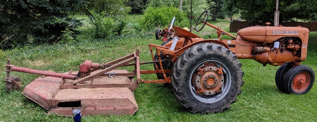

I grew up on a D10 with a 5'AC bushhog.
It would cut two rows of tobacco stalks off at the ground in 3rd gear but when you raised the lift you were never sure if the bushhog or the front end was going to come up. You learn to deal with it. CA has about the same power as the D10.

I run a light duty Howse 5 footer on a C with a work saver 3 point, it carries it fine and is a pretty good match. The tractor will pick it up but it gets light in the front end, the CA with its rear set axle and bigger hydraulics should be just fine even with the hand clutch get an over running coupler it will protect your pto & you. I am in the middle of fixing up an old Woods tow behind 5 footer, but they are a lot more expensive around here than a 3 point unless you find a project like I did. TJ

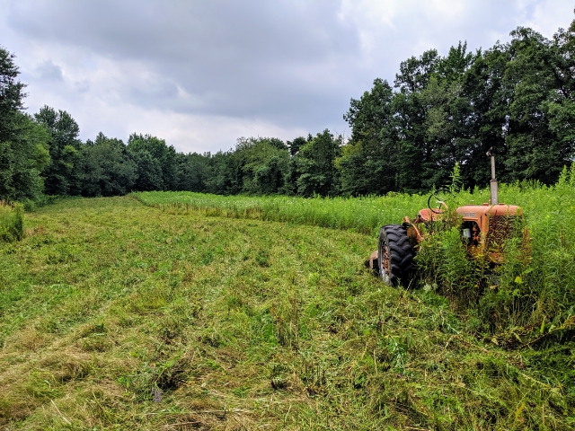

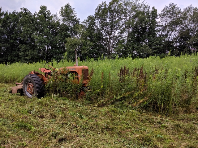

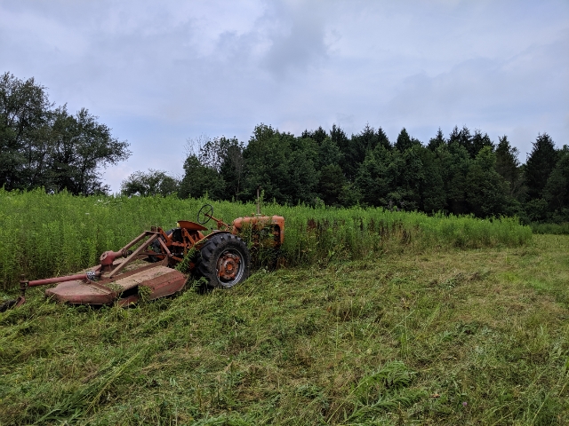

I just finished a few acres cutting with a 5' tow behind King Kutter in very hilly ground. I mostly use 2nd gear with the throttle about 3/4th open. The vegetation was thick, wet and about 4' tall.  I am totally confident in the CA's ability to finish mow and have never had a problem using the hand clutch and find first gear more than slow enough if the going gets tough.

Posted By: Hunt4Allis
Date Posted: 04 Jul 2019 at 1:32pm
Originally posted by Cernunnos Cernunnos wrote:
I just finished a few acres cutting with a 5' tow behind King Kutter in very hilly ground. I mostly use 2nd gear with the throttle about 3/4th open. The vegetation was thick, wet and about 4' tall.ย  I am totally confident in the CA's ability to finish mow and have never had a problem using the hand clutch and find first gear more than slow enough if the going gets tough.ย ย
Thanks for the optimism oh, it's hard to find sometimes when you ask a question sometimes it seems like everyone wants to give you the negatives instead of possibly letting you know that it's able to do it.
I do notice that you have a wide front end on yours which add some weight and you have weights at the front which mine does not (I do have a wide front end I'm going to put on the front of it and also a front loader so it should be balanced better and not lift the front off the ground

Here's a picture of my CA with the brush hog connected finally today. I did run a couple tests on it and everything seem to be going okay other than at one point I raised the unit up and I could not lower it back down it's almost like the hydraulics got locked up and would not lower but I checked them before I even connected to it, what do you guys think that could cause this?
I don't know if I can change the settings like in the shop manual how it goes step-by-step how to set one of these pumps and maybe mine is just not set right? It seemed to work a few times just like it should and intermittently it gets stuck in the up position and with the handle how it should go down I can stand on the brush hog in bounce and it still won't go down, after I parked it in the barn it took about 15 minutes for it to gradually settle down onto the floor. The main problem with this is I need it to be sitting on the ground while I'm brush hogging to eliminate my front end from popping up because of the weight going up little hills and stuff I've popped a couple of wheelies and that's not good feeling when it happens with not being able to lower it onto the ground to control this...

Well here's an update whether a CA can run a big brush hog?
The answer is absolutely it can!!!mine did a lot better without having the top link connected so thank you to Dick l for pointing that out to me
I'm so happy with my model CA how well it handled everything I still need to get the hydraulic pump to work so that it can be lowered once it's raised and I'll just go over the field again and recut it the opposite direction once I get that done but my 4-acre field definitely got a haircut today!!!(it's not perfect because the brush hog was in the up position the whole time which probably actually was a good thing because the field was so tall as you can see in the picture is a lot of the weeds and grasses were as tall as my exhaust)
Much appreciated to everyone who gave me information so that I could get this filled cut, thanks Matt

Do you have health/life insurance?
Date Posted: 19 Jul 2019 at 4:28pm
Why?
Posted By: Dennis J OPKs
Date Posted: 19 Jul 2019 at 5:16pm
Just guessing--Tim doesn't like the angle which the photo appears to show the brush hog operating at.  The photo could be deceiving but it appears that if that blade catches and throws anything--the operator is in a possible path of said object.  Was told brush hog should be flat to slightly elevated on the back.  In that stuff the CA will probably not have the hp it takes run it flat.  Just a guess?
Posted By: DougS
Date Posted: 19 Jul 2019 at 5:56pm
A guard on the PTO shaft might be a good idea too.
Date Posted: 19 Jul 2019 at 6:02pm
I know it's supposed to be flat, I walked entire field many times in spring and fall when there's no weeds, and know there isn't anything that I can hit.
My hydraulics pump is stuck in up position, and lastly it would have stalled/ overworked motor if I mowed it in all the way down position ( now I need to adjust pump so hopefully I regain the ability to lower it down after it raises and I can mow it low)

Ok. I'll say it and you can tell me to butt out if you want to. You're risking injury or worse with the way you're operating that bush hog. Running it at that angle because the tractor can't handle it level (the way it's supposed to be) is asking for trouble. Way too many guys get bitten by the things that they "know" aren't there or "won't happen".  BTW, do you have an ORC on that bush hog - yet?

The original question has pushed this subject to the extremes.  Those last photos are definitely expecting too much out of a CA.  Granted you can get it through there with less than the best results and if that's what you've got, I guess you go for it.  More than likely if you do too much of it you're going to tear sometime up.  As mentioned, safety should come first and be aware of  the potential risk.  I mow stuff like that including Johnson grass 6 ft high and its makes a WD 45 snort big time cutting it down to 6 or 7 inches high. 2nd is really too fast wide open and 1st is too slow.  Good luck with getting your hydraulics working.
Date Posted: 20 Jul 2019 at 3:23am
Yes orc used
And extreme caution
I must have a good one(CA) I bought a few years ago and slowly been fixing up(when I bought it I was told that the motor had just been overhauled in the last couple years)
I believe this to be true because it did not have hardly any problem cutting all this in 3 hours in first gear...

yeesh, I'm tired just LOOKING at the pictures, poor old CA !! It'd be easier on her to only take 1/2 widths of cut.Yes, it MAY take longer, might not though.
there's a 'sweet spot' of engine RPM, cutter speed and ground speed where everyone's happy, same as blowing snow, where you can actually get more done,in less time.
Also wait 2-3 days to let the 'grass' dry up real good before cutting 2nd ( and 3rd ?) time.
Have fun but be safe !!

Obviously not many have bush hogged that type of weed growth. I have ground up weeds that high with my C and Woods 59 under the belly. It is not like a bunch of grass that is not brittle like hollow weed stocks. Running high in the front cuts off the tops first with the front and cuts lower at the back which keeps it from bogging down some in the course weed stocks. It would be nice to be lower in the front but if it is not tossing stuff above the PTO I wouldn't worry about it. If it is tossing trash that high I would hang a piece of plywood to the fender rails to save my rear stop the seeds from reseeding the field. Then fix the hydraulics.
