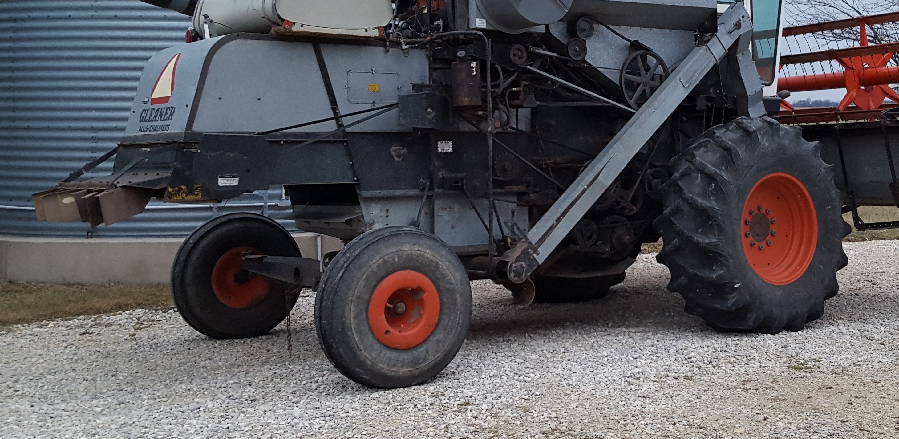

Posted By: DSeries4
Date Posted: 21 Dec 2018 at 9:33am
Dad's old F3 came with factory weights on the back axle if you look closely at the picture below.  When the combine was sold we kept the weights and put them on the 6080.
If you are wondering about the sign, it is at Summerix in Lachine MI.
Posted By: DrAllis
Date Posted: 21 Dec 2018 at 10:35am
Those are "fat back" wheels on that combine. They also had donut weights that bolted right to the original/standard equip steel wheel, but they weren't near as heavy as fat back wheels.

Date Posted: 22 Dec 2018 at 9:09am
The fat backs are the kind that if you have a flat tire, you call the tire man to come to the field.  Those tractor weights on that F-3 are interesting.  I've never seen it done like that and am curious if it was homemade?? by the selling dealership ??
Didn't look homemade.  The weight hanger was welded directly to the axle and looked professionally done.  The paint on it matched the rest of the paint on the axle with no overspray.  We were told it was a factory option.  Of course, people will say lots of things to make a sale!
