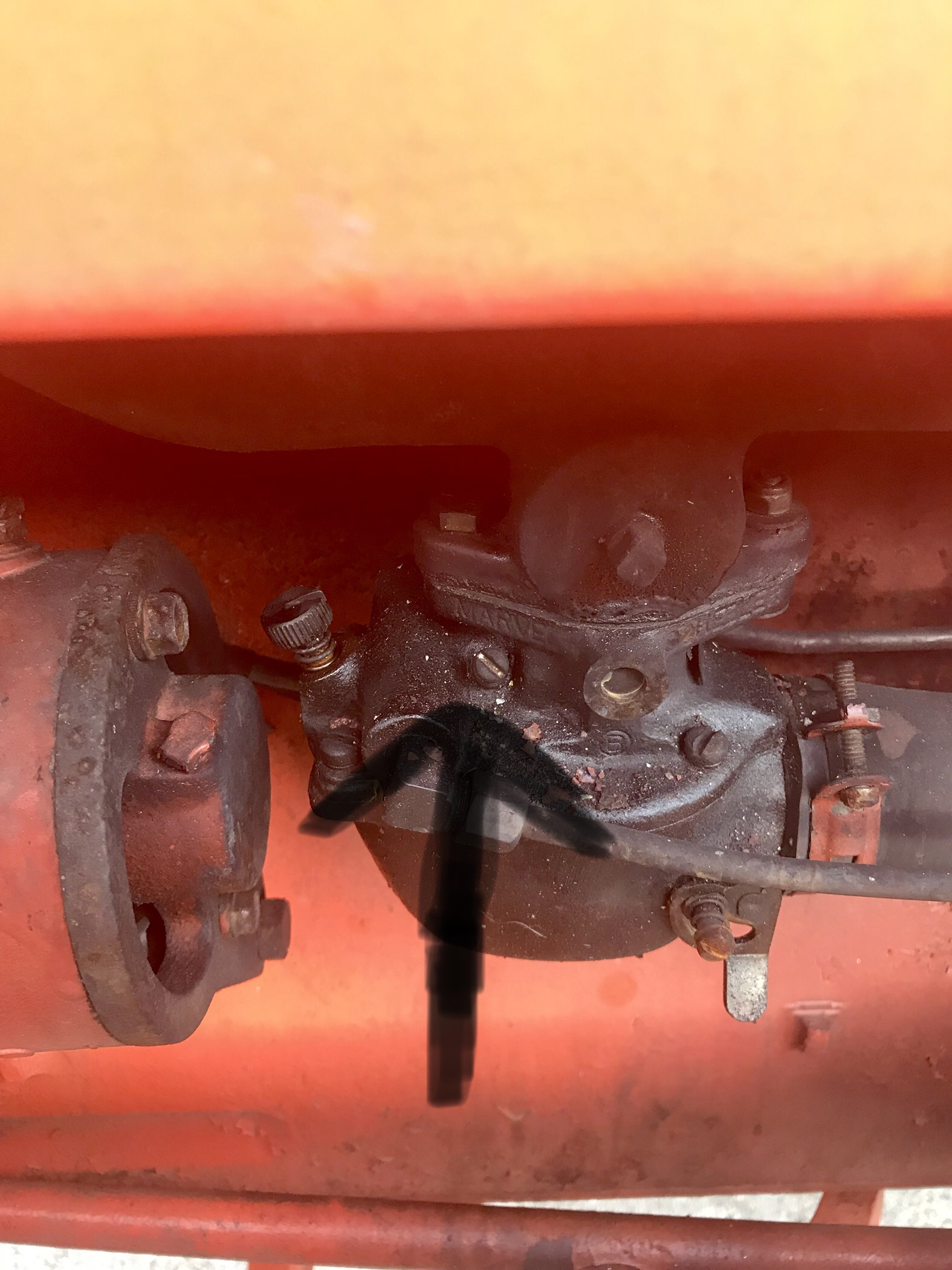

Posted By: NewToMe
Date Posted: 29 Aug 2018 at 7:14pm

Posted By: NewToMe
Date Posted: 29 Aug 2018 at 8:47pm
Thanks for the info AC720Man just seeing if i should pour it in the gas or stall it out through the carb with the spray, i literally just bought this tractor Thursday last week, the owner before said he put premium gas in it, maybe i should empty the tank and put some fresh premium in with the sea foam liquid in the tank?

Posted By: NewToMe
Date Posted: 30 Aug 2018 at 5:18pm
Its not a series II DrAllis but doesnt it have the thumb guard?
Posted By: DSeries4
Date Posted: 30 Aug 2018 at 9:13pm
All D15s have the thumb guard regardless of series.  My 1961 Series I has it, so does my 1966 Series II.  Yes, that is definitely a Series I you have there.  A few less ponies, but still a great tractor.
Posted By: NewToMe
Date Posted: 30 Aug 2018 at 9:43pm
Just wondering how you can tell
Posted By: DrAllis
Date Posted: 31 Aug 2018 at 7:14am
The serial number for one thing.  Series 2 models have an oval muffler and a dry air cleaner. They also have headlites on the fenders. They don't have rivet on emblems on the hood sides.

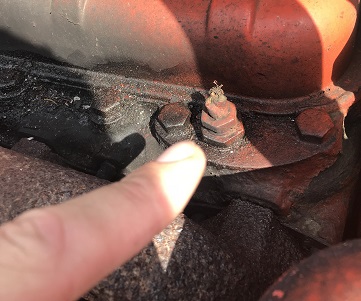

Posted By: NewToMe
Date Posted: 03 Sep 2018 at 10:16pm
im not sure if this is a sensor or what else could it be, maybe some one or one of you could tell what its for or from. its located on the head of the engine right behind the manifold
Posted By: Tracy Martin TN
Date Posted: 03 Sep 2018 at 11:14pm
That is the heat sending unit. Goes to the temp gage. HTH Tracy
Posted By: NewToMe
Date Posted: 04 Sep 2018 at 4:23pm
Temp gauge like water temp?
Posted By: Jim.ME
Date Posted: 04 Sep 2018 at 4:31pm
Yes, the water (engine coolant) temperature gauge.
Posted By: NewToMe
Date Posted: 04 Sep 2018 at 4:57pm
great thanks i was looking for that just got all new gauges can wait to start wiring them.
Posted By: Jim.ME
Date Posted: 04 Sep 2018 at 5:05pm
That was a mechanical gauge, not electric. If your new gauge is mechanical be careful not to kink or otherwise damage the capillary tube as you run it from the dash panel to the engine. Have fun.
