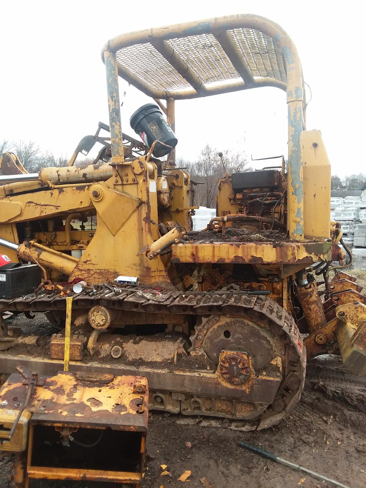

Some good info on pan removal, I usually use a floor Jack. Taking this one off I got the bolts from the sides, A.C. seems to use some fine thread here and there so it was slow going! Uggg!, after the bols were out I had to give it a gentle pry it was stuck on filled with crudd!.
Posted By: Cannoncollector
Date Posted: 02 Mar 2018 at 4:11pm
Not to many treacherous snake problems here, but mice on the hand!, so i started it up to drive off the trailer, and lordy thank God the trans was feeling great and even the steering clutches feeling great!, but I'm looking hydraulic bucket control because the main hard hydraulic tubes were rusted out dues to large mouse colony,

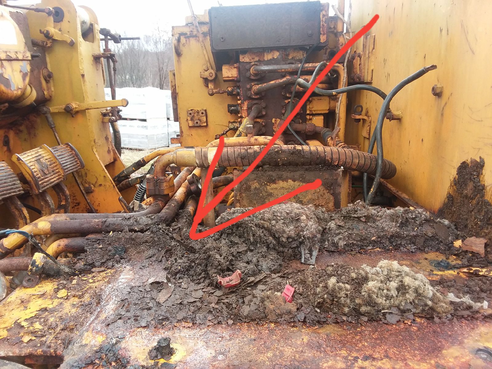

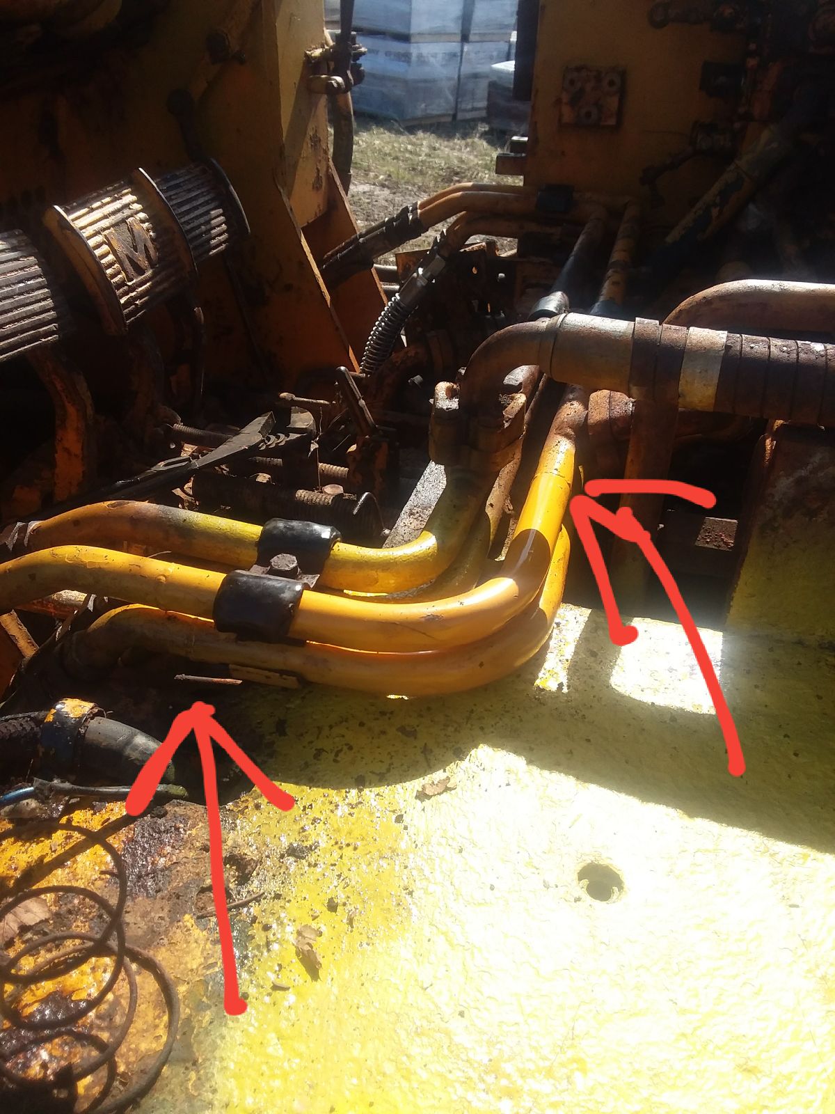

Anybody that has one of these better keep those hydraulic tubes clean where they run into the battery compartment area or saddle tank the other sides of the lines that are exposed in the open are clean as a whistle I bought some tubing pre bent on an angle and my Pro welder is splicing in new corners as we speak
Date Posted: 03 Mar 2018 at 7:27am
All the rust was air hammered and knocked off and being painted.

Update I had the lines repaired and I installed them. You can see the welds where new elbows were installed.

Does anybody have ideas how to keep mice out of those perfect areas for nesting?.. I was thinking about filling in the areas with that insulation in a can that expands or slopping lots of nasty grease in there
Date Posted: 07 Mar 2018 at 2:38pm

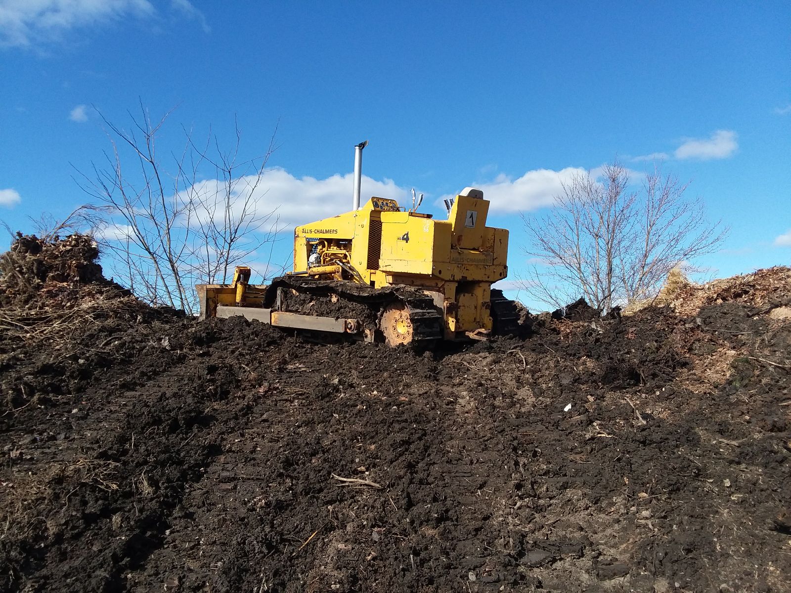

And then I celebrated by taking the hd4 for a spin 😥😂
Posted By: DMiller
Date Posted: 07 Mar 2018 at 2:58pm
Well placed often replaced moth balls
Posted By: DMiller
Date Posted: 07 Mar 2018 at 3:00pm
Segments look pretty solid, rails look pretty well used up as well the shoes on them. Be wary when turning if much slack in them as the old snaky rails like to roll off.
