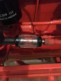

Posted By: HVFDFIREFIGHTER
Date Posted: 16 Dec 2017 at 10:03pm
Looking at a new coil. I see there is an internally resisted coil for about $20. And an hot coil (55000 volts for about $50. I’m assuming i need the internally resisted as I do not see a resister block on the tractor. Is this right?

Posted By: Steve in NJ
Date Posted: 16 Dec 2017 at 11:31pm
If the Tractor is 12V, you need a coil that Ohms out at between 2.7-3.3 Ohms. A 3.0 Ohm coil will put you right in the middle. First thing I would do is change out the Battery, Batteries shouldn't smoke. When they do, there's a problem somewhere. Also, make sure your cables are in good shape and your Grounds are clean and tight. Before you condemn the coil, change out the Battery first and see if it comes to life. Just may be the Battery causing your troubles. Yellow spark is not good. You need a Whitish/Blue spark for good fire power. Change out the points and condenser after a new or different Battery is put in...

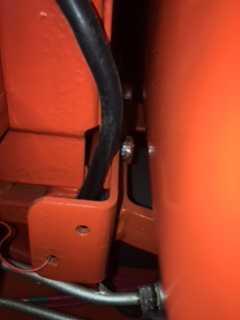

Date Posted: 21 Dec 2017 at 4:53pm
So i got my new parts yesterday.  Put new points (and gapped to .20), condensor, distributor cap, dust cap, and a new internal resisted coil.  Still will not start.  It has spark at the points and spark going to the plugs checked by tester (pictured below). Plugs get wet, so it is getting gas. While working I dropped my work light, and, in the dark found out what was causing the smoke mentioned in earlier posts.  Earlier, I thought it was the battery smoking but it is not.  When the light was off, I noticed a bolt that connects the gas tank support bracket to the side of the battery box glowing orange when I had the starter engaged.  When I let the key off (starter not moving) no glow.  Turned key to engage starter, bolt was glowing again.  Being so close to the gas tank is a little scary. Hopefully the picture I took will show what I am talking about.  The black wire shown is running from the battery to the starter (positive)  In the picture it looks like it is touching the bolt that glows but it is not, it is a few inches away. The silver line on the bottom is the gas line.   Orange metal on left of picture is the battery box.  Orange metal on right of picture is the gas tank.  The flat stock is the gas tank and battery support.
Does it sound like a bad ground (causing the bolt to glow orange)?
Could the voltage regulator be bad?
**How do I start the tractor bypassing all wires, gauges, switches, and other crap?  In other words,  I want to start (and be able to shut off) tractor with just battery, starter, coil, and distributor.  I figure if I can at least get it started without any extra stuff, I can then go back and trace wires and hopefully figure out what is wrong.
Date Posted: 22 Dec 2017 at 6:01am
Plug wires are correct order. I will check timing. But I am still concerned about the glowing bolt. Has to be shorting out somewhere
Date Posted: 22 Dec 2017 at 6:28am
Could the glowing bolt just be a sign of a bad ground? The wire is new from - side of battery to metal on top of the battery box. The battery box sit on the tractor and Gas tank support is attached to battery box at the bottom by two bolts. One of those bolts is the one heating up.
To me, it’s acting like there is a kill switch. But there isnt. I say that because my wd has a kill switch and I have tried to start that a few times with the switch on. Wouldn’t start. Thought about it and then the light bulb went on, duh, shut the switch off. Then it started. But nothing like that in the d14. Unless something is shifting out so where. All wires were replaced after painting last summer.
Posted By: DougS
Date Posted: 22 Dec 2017 at 6:58am
Nothing should be heating up anywhere.  Take the bolt out and use a wire brush all around near where the hole is. The terminal on the cable may be oxidized to the point where you'll need to brush it down to the copper. I'd replace the bolt. You want bright shiny metal at all your connections, before you put the wire on them. Use a drill motor and round wire brush. Once a connection oxidizes it's very difficult to clean.  This may be your problem. There would be a large voltage drop at this point.
Posted By: jaybmiller
Date Posted: 22 Dec 2017 at 7:11am
There's a NICE bolt hole on the left side of the block that I use for GROUND for the battery.Yes...not 'correct' but I've never had hot bolts ! Having all that currnet running through a bad connection will drop the voltage down to 'not enough' to give real sparks in the engine.
I'd replace and rewire the ground wire.
Date Posted: 22 Dec 2017 at 7:18am
I think that is where I need to start. Cleaning that area and new bolt. Although it is clean. I replaced all wires when refurb. Bat terminals are shiny clean. No crud anywhere as I just restored a little more than a year ago. What a pain because to get to the bolt and clean it good, I’ll have to take hood and gas tank off.

Posted By: corbinstein
Date Posted: 22 Dec 2017 at 7:23am
Have you checked to see if the gas may be bad?
I've had that several times. Somehow water kept leaking into my tank(s). After I fenced the place off, that mysteriously stopped.... Hmmmmm.
You can also temporarily bypass the resistor to get a hotter spark, but I'm more apt to think it's the condensor.
With the glowing bolt, that tells me you have a grounding issue, and a poor connection of any kind will draw your battery voltage down while cranking, as P=IV (electrical formula) says that as Voltage (V) goes down (poor connection), Current (I) has to go up in order to provide the same power  (P)

Posted By: Dennis(IA)
Date Posted: 22 Dec 2017 at 9:35am
Sounds like a bad GROUND. I am not familiar with the D14 , but I would like to sèe the ground cable attached to a mounting bolt on the starter.
Posted By: polarbear
Date Posted: 22 Dec 2017 at 10:54am
all my d series are positive ground but having said that in my experience when certain bolts get hot it is diffinetly a ground problem
Posted By: GregLawlerMinn
Date Posted: 22 Dec 2017 at 2:03pm
Disconnect the ground cable from the Bat. Run a jumper cable from the bat Grd to another ground; then try starting. If this works, you need to tidy up the ground. BTW; I once had a solid looking bat wire and was experiencing starting isssues. After lots of effort, finally discovered that the cable was corroded where it went into the terminal (not visible); replaced the cable and problem solved.
What this country needs is more unemployed politicians-and lawyers.
Currently have: 1 D14 and a D15S2.
With new owners: 2Bs,9CAs,1WD,2 D12s,5D14s,3D15S2s, 2D17SIVs,D17D,1D19D;1 Unstyled WC
Date Posted: 22 Dec 2017 at 2:55pm
Definetly a ground problem. Took negative side of battery and ran it to one of the four studs on the valve cover (just because it was therenand it was easy to do). Checked all spark plugs and had spark. Put plugs in, started up. Then quite after a minute as I had the gas tank off to get at the bolt that was causing the problem.   Too cold now so maybe tomorrow I will get it out all back together. Anything wrong with leaving negative wire connected to valve cover stud permanently? The wire I have acted as if it wad made for that. Maybe that will get too hot though.
Date Posted: 22 Dec 2017 at 3:17pm
All my D14s have the grd from the bat going to the bolt that holds the rear of the center tin (the one that the side covers go into)
Posted By: Alberta Phil
Date Posted: 22 Dec 2017 at 4:41pm
My D17 has the ground cable from the battery to the rear valve cover stud. Has been that way for years and no problem with it.  I always thought connecting to the battery box or tray was too indirect a connection and left too many places for poor contact.
Date Posted: 22 Dec 2017 at 6:05pm
I'd rather it NOT be on a valve cover stud, thinking you don't want to 'reef down' the cover mushing the gasket, then oil leaks, and yeah..another job on the todo list.
Left side of engine block, there's 2- 5/16 or 3/8 threaded holes. I use one of them. Clean out the hole(chase with new bolt), use bolt,lock washer,flat washer....
Mine's been there for 5 years... I use a 'Wallmart' combo battery (top and side posts) , use the side posts..made for a nicer instal and no sparkies.
Jay

Posted By: Herb(GA)
Date Posted: 23 Dec 2017 at 10:05am
Secured to bottom rear side edge  of battery case (on our D14) is a 6" x 12" x 3/64" sheet metal that extends approximately 3" above top of battery, with top 1" formed  90 degrees; this 1" flat area holds the "U- shaped" strap iron that holds the 5" wide backbone center piece of the hood.  This 1" flat area also is threaded for the bolt that secures the ground; this threaded hole is first extruded enough to insure three full threads for the ground bolt.  Our ground cable is  less than 10" long. Herb(GA)
Posted By: DougS
Date Posted: 23 Dec 2017 at 10:19am
I don't like the idea of attaching the ground to sheet metal, regardless of if it was designed this way or not. As for side post wiring - only if you can find it with a nice fat cable. Walmart 12 volt cables won't cut it.  Go to a truck repair shop if you must. Steve might be able to fashion up a set for you too.
