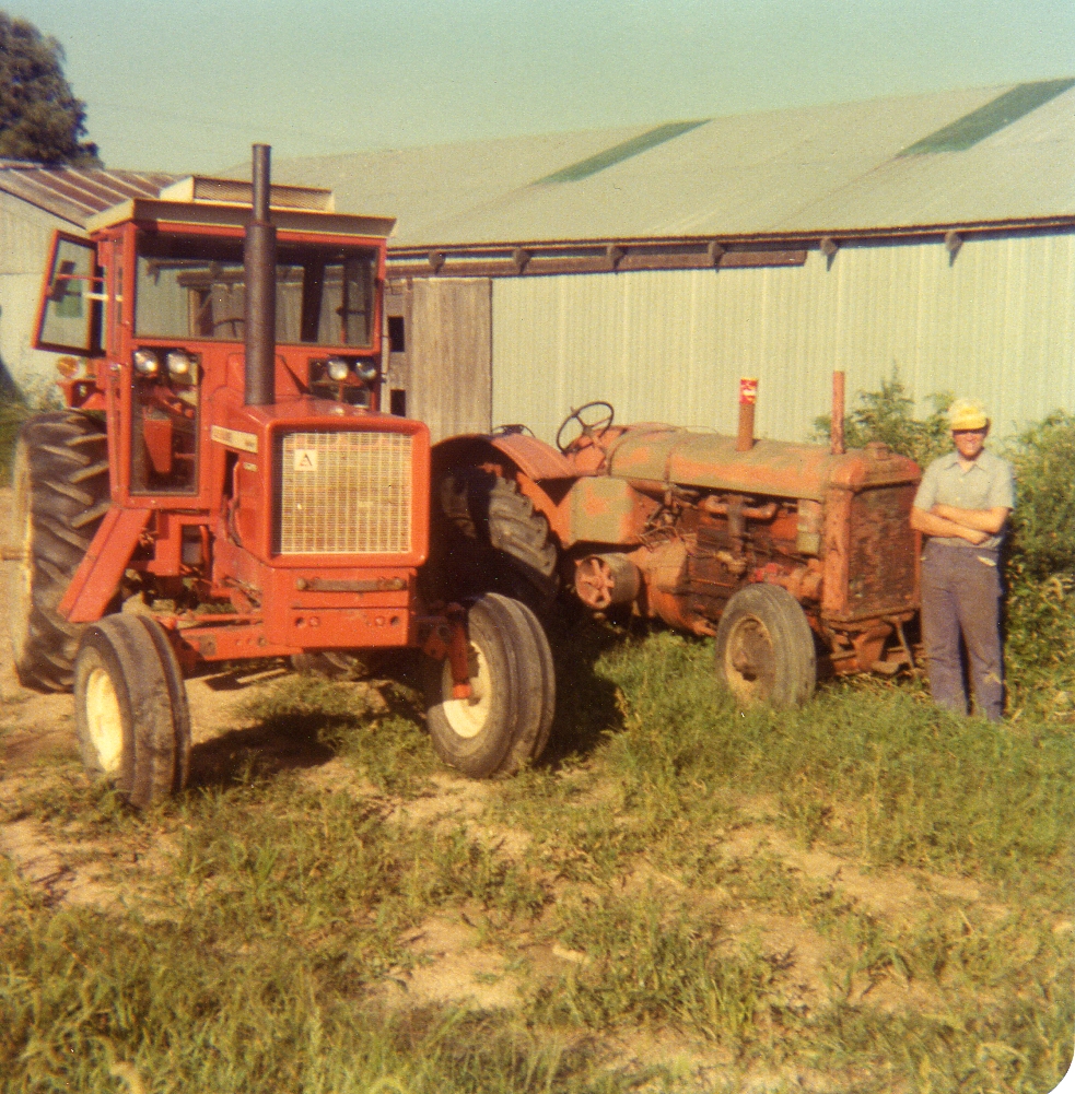

Date Posted: 06 Dec 2017 at 8:48am
when it was a couple years old I installed a 200 muffler on our 190xt and the difference was negligible.
Here is the XT when it was about 5 years old after I added the 220 muff, the ole A when it was 40 years old, and me when I was about 19 years old. Dont know where the xt is today but the ole A looks much better today than then, cant say the same for me, LOL

Date Posted: 06 Dec 2017 at 6:13pm
Butch, that is pretty much EXACTLY what we replaced 4 years ago on our XT. Dad bought this tractor used from a dealer that had sold the unit new to farmer that tore out the rear end and brought it back to dealer to repair. When the total cost of the rebuild was told to original owner after repairs were done,the owner told dealer to "KEEP IT!!". Dad got t5he tractor for what dealer had in it for those repairs. If these turboed XT's did NOT come from factory with a muffler, who put them on ?? Thanks
