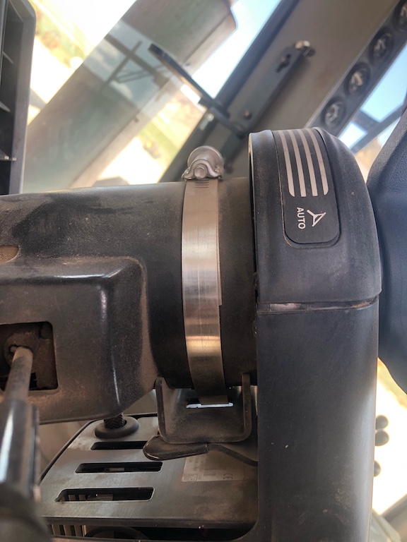

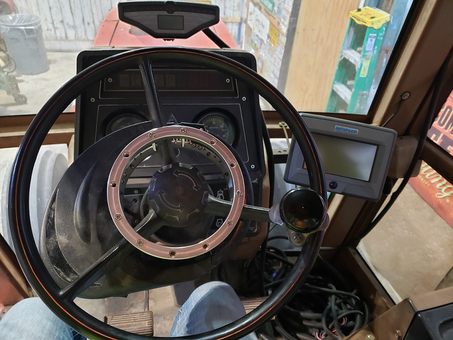

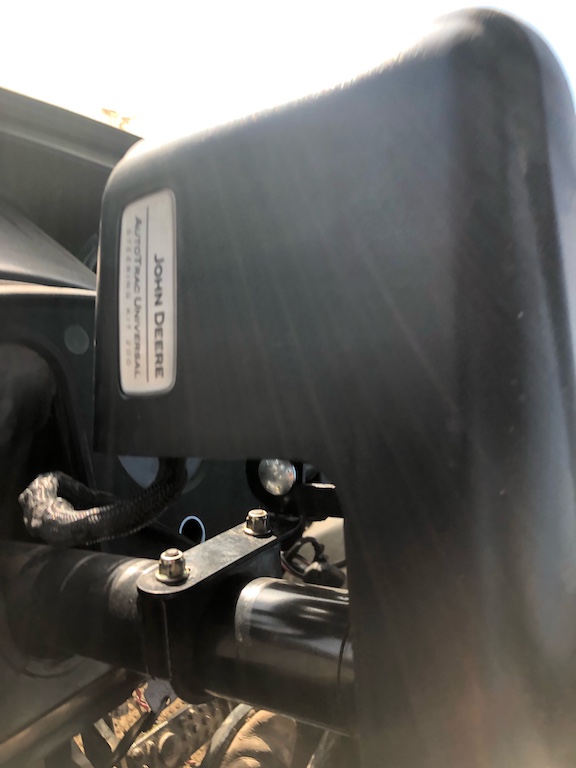

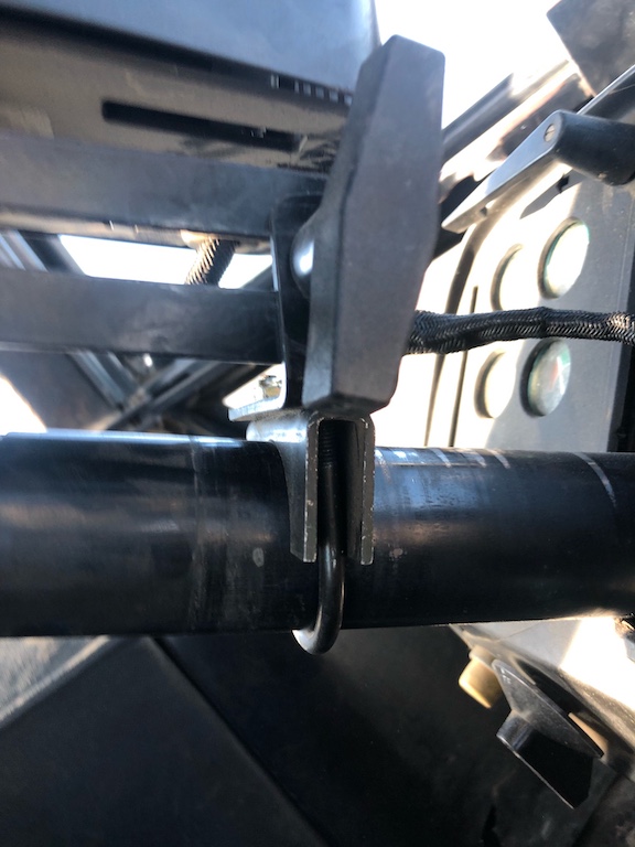

Posted By: AC7060IL
Date Posted: 01 Apr 2021 at 6:41am
I'm just posting these pics for Dswall. He will probably explain about them?
