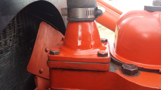

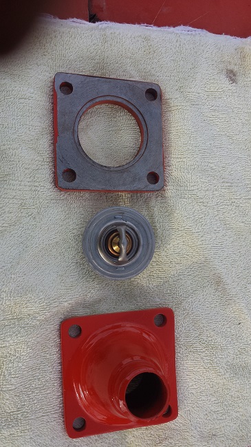

  I had a thread on my D14 Industrial gettin hot on me and popping a freeze plug in the cylinder head, and dumpin water into the oil.  Well,,I finally got part of that problem squared away,,but wound up I had to make a thermostat housing cause I could not find one anywhere, to replace the broken housing.
 I made this little number using 2 pieces of 3/8" plate steel and machined a register for the Chevy V8 180° thermostat. I used a S/40 1" X 2" concentric reducer and welded it  to the top plate. There has to be two plates as the opening in the head is way bigger than the thermostat.
Filled with fresh oil and put a spark in it,,,,and engine started right up and after a bit  thermostat opened up and started circulating water,,,,thas good,,,,,but I noticed the oil pressure gauge was settin on 10# and not movin up as the engine used to carry 28# oil pressure at high idle,,,,?  I loosened the filter and just a little bit of oil was coming out of riser tube,,,,? oil had a little tint of milk but mostly good oil,,,
 I raised the filter to bout halfway up riser tube and got good oil pressure, so screwed filter back down,,,but gauge still at 10#,,,,,,WTH,,,,??????

besides all that other....nice fix on the T-stat

oh....and nice job making that housing!

Joe, you should make more of those. I bet they would sell! Nice work, that is a damn good weld!

     Hey Thanks AJ,,,,,I did the stringer and hot pass with my old Lincoln and Hobart 7013 while rolling the housing on a CS rod. It being S/40 carbon steel,,,it oughta last a hundred years,,at least better than the pot metal one,,,,,Wink
