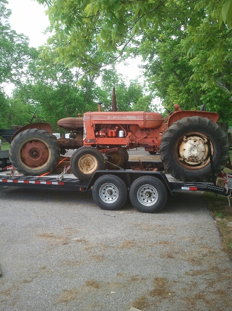

Posted By: AaronSEIA
Date Posted: 01 Nov 2016 at 3:28pm
This is how I did mine.
AaronSEIA
Date Posted: 02 Nov 2016 at 12:09pm
The trailer in my picture is 16'. I'd have had more room if the C didn't have the front cultivator bar on and if the WC had the tires spin narrow. WC with the C parked tight in the garage needs just under 15'.
AaronSEIA
Posted By: DrAllis
Date Posted: 02 Nov 2016 at 12:43pm
I run a bumper hitch, and would have the heavy tractor on the rear to avoid too much tongue weight. Where the trailer axles are placed is very important as to how the load is distributed on the trailers bed. The trailer in the picture has the axles far back and that's why I'd have the WC on the rear for my F150 truck.
