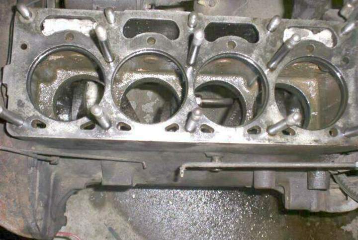

Posted By: steve(ill)
Date Posted: 25 May 2017 at 5:50pm
4 cylinder motor with wet sleeves removed.  What you see inside is the water jacket open to the backside of each sleeve.
