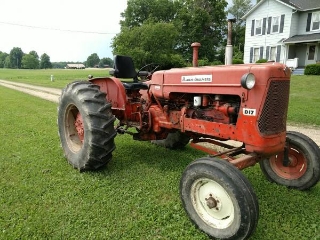

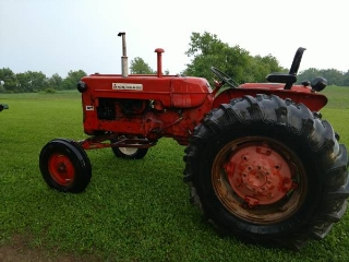

Okay thanks for the info guys to get more back on my original train of thought what is the value on a series 1 d17 that seems to be all original intact and running and driving good?

I would say, $2500 - 3500, depending on condition and how it looks, including oil leaks and modifications. Mods can be done right or wrong, effecting the value.

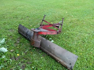

Ok, from what I'm being told this tractor is all original and had no modifications done to it it looks really intact and like it has not been messed with (unlike a lot of the tractors I've been going to look at this one looks so far pretty good) he has it priced at 3000 and it includes a 7-foot rear blade
Thanks Matt

You need to go operate it for 30 minutes to get it warmed up really good. And I don't mean idling it. Take it down the road at full throttle. Many of these old gas tractors may run just fine, but when fully warmed up, you'll see a blue haze out the exhaust pipe. That usually means an overhaul is close to happening. That is $1500 in parts alone, let alone any labor. Four new tires are at least $1,000 bucks.  I just purchased an above average Series 3 with a NF for $1600 ...frt tires 90% rear tires 75 %.

All the tires and rims are in good condition I already looked at them the only thing left for me to do is go there and drive it like you say. Hopefully I get a good feeling from this one...
Thanks Matt

I paid $1500 for mine and the guy drove 700 miles to deliver it to me. BUT, mine was no Cherry!
It had 1 good front and 1 good rear tire, bad steering arms and tie rods and the paint was really bad! So add $200 in parts to that, plus a lot of labor.
I'd try to get him down $200 - 500 and buy it. If the blade is a SC, it's worth about $500, $300 if a heavy 3 point.

The one I'm looking at is serial number d17-20142.
What can you tell me about that one?

D-17 chassis s/n 24,001 was supposedly the FIRST tractor built that has the full-flow oil filtering system on it. The filter is like a Fram PH-8A.

It won't have the updates that I listed, with the possible exception of the later cylinder head but, the engine # will have to be checked to verify that (17293 or higher) or a spark plug pulled.
Still a good tractor but, be sure to bring those things up, when talking to him. The upgraded oil pump, would be worth at least $100 to me.
I went and drove it around and did not notice any blue smoke. What exactly does the blue smoke indicate is happening to the motor parts, as in which ones are failing? You also say that "usually means"?(what else could it indicate?)
I'm very close to buying this as they all looked to be very straight and solid with good rims and tires and started right up every time every year worked and did not jump out of any gears, the brakes seem to work great also...
when the owner started it up and went to take off he had it in 2nd or 3rd gear and revved it up really high and as I looked back at it there was a small amount of smoke came out that I would say could be considered bluish but it was kind of a harsh take off on his part of driving it as far as I'm considered...
The high, nuetral, low shifter works good
All the lights worked on it(which was a bonus compared to all the rest of the larger tractors I've gone to look at lately)
this tractor seems to be in the best shape of any of them that I've looked at in this size range and age and seems to be the most original and complete with nothing bent or a whole lot messed with.
