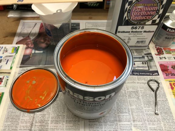

Heard a similar story when I bought my paint last week.  Went with the YS073 code in a Nason single stage urethane instead.  Looks good to my eye... Definitely less red in it than the rattle can stuff I've used.
Ben
Leave things better than you found them.
1941 Model C (restored 2020)

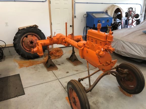

I am using Nason 2K Urethane now. Planning to try color spray tomorrow if the weather holds out.   They matched the battery box to my B pretty close. It was done with Van Sickle PO #1 that I am OK with. I added a pic at bottom. I think the Van Sickle tended toward too red also as it got sun.
Seems like I had seen that YS074 was supposed to be the newer Dupont code for PO #1 but I can't remember where I saw it. The old spray out was below.
Just beware, the hardeners in these paints are very dangerous to lungs, eyes, skin until they cure out. Wear all the PPE you can afford.
Edited by Rick of HopeIN - 22 May 2020 at 9:02pm

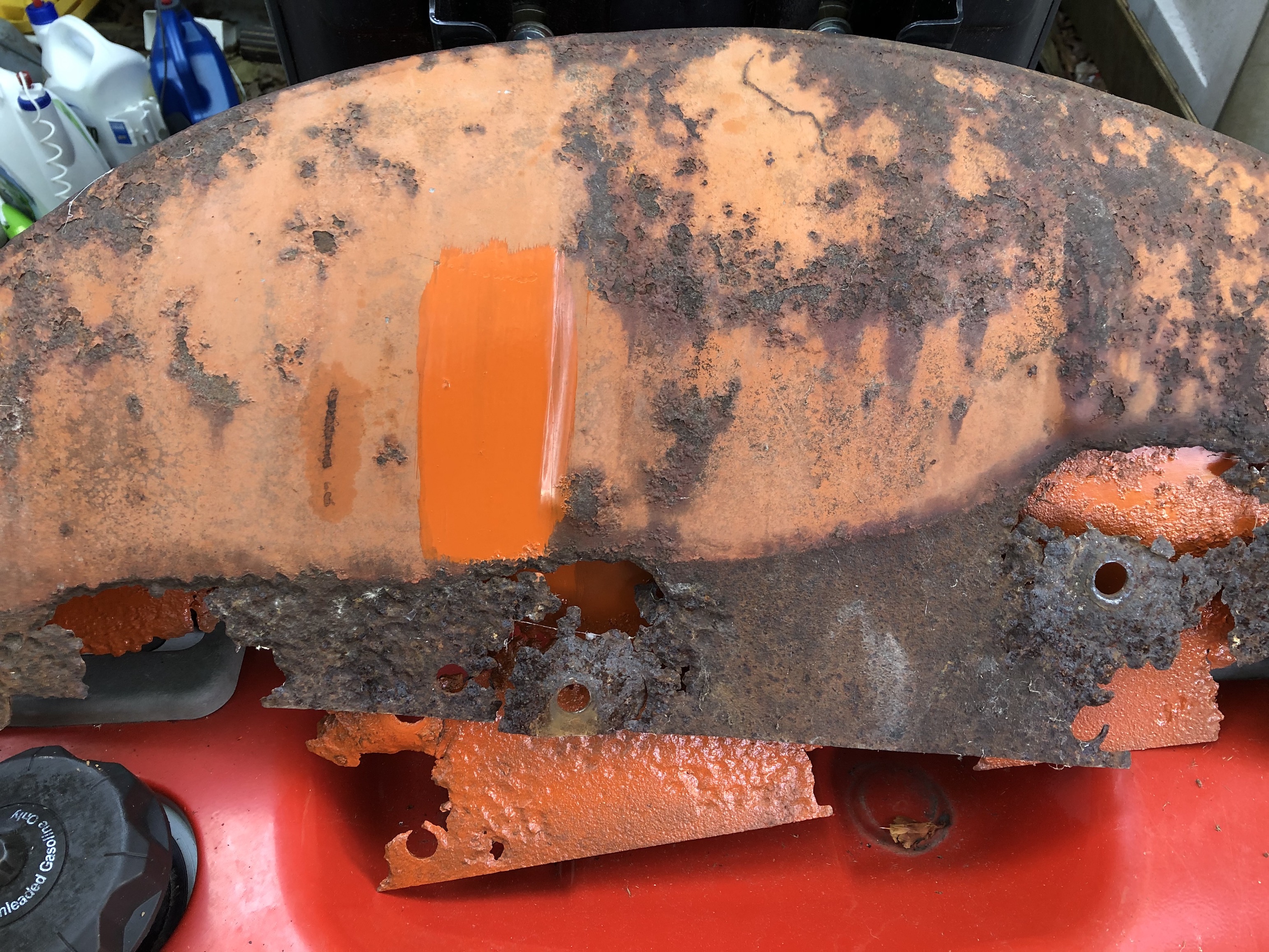

Last winter my PPG jobber told me that the formulary no longer had a mix for acrylic enamel, only for the single stage urethane, and that was based on leaded orange and leaded yellow toner are that are NLA. One of their other locations supposedly had the correct toner available.   They had the paint mixed there and transferred to them. This is what I got:
    the top stick is a mix from a few years back. Naturally I wasn’t happy having just spent $600 for 3 gallons of this stuff. I sprayed a test panel of the old mix and had them fix it. I'm not sure what they did since with this social distancing stuff it was a curb pickup and I didn't get to talk with the tech that fixed it.
Anyway, this is it on the B:

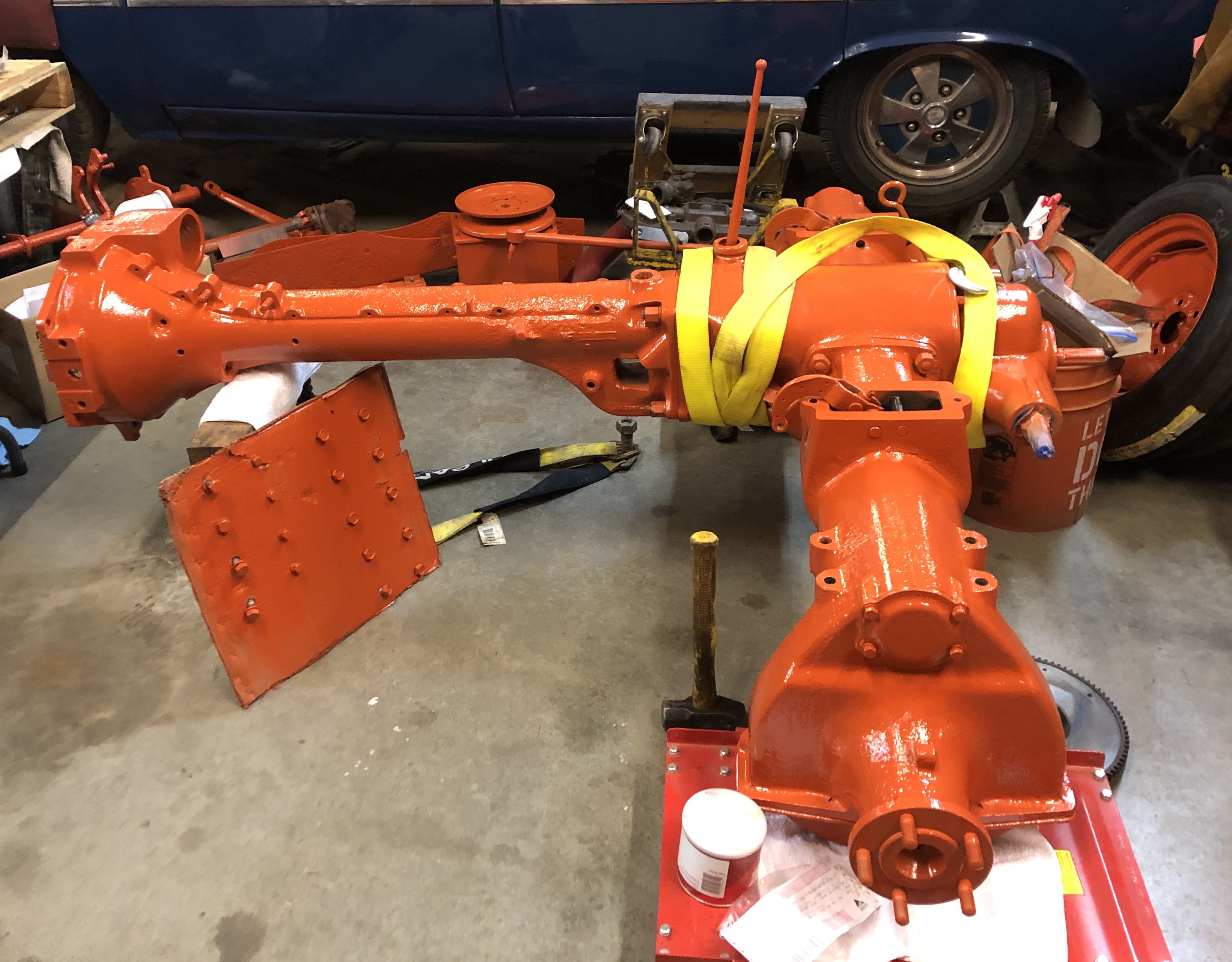

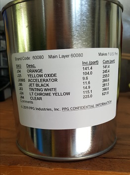

another update on PPG Persian Orange #1 paint #60080.
I was not able to get the remaining PPG toner M130 which is discontinued as expected.
But my local PPG paint guy called the PPG library and was able to get an updated non-leaded MTK 60080 formula that has been created by PPG to replace the leaded 60080 formula. The same PO #1 formula number is used i.e., 60080.
I did not get a copy of the formula but the leaded toners M130 (orange) and M114 (yellow) were dropped and replaced by different toners.
The updated non-leaded 60080 formula is not in the PPG database yet so when a PPG rep looks it up they only find the leaded formula.  Have them call the PPG library and get the non-leaded 60080 formula for your paint.
I got a sample to test out and below is a quick tests.  Let me know what ya'll think of the color.

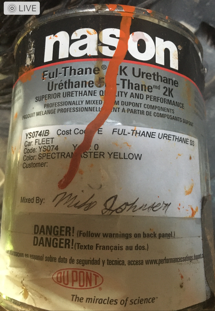

Looks really close. Do they call it spectramaster yellow?
kelso View Drop Down
Joined: 07 Jan 2020
Location: Port Ludlow, WA
Points: 42
Post Options Post Options   Thanks (0) Thanks(0)   Quote kelso Quote  Post ReplyReply Direct Link To This Post Posted: 27 Jul 2020 at 3:45pm
55allis,
I did not see the name spectramaster yellow listed.  There is a yellow toner M115 used.
For PPG paint it still goes by the code 60080.

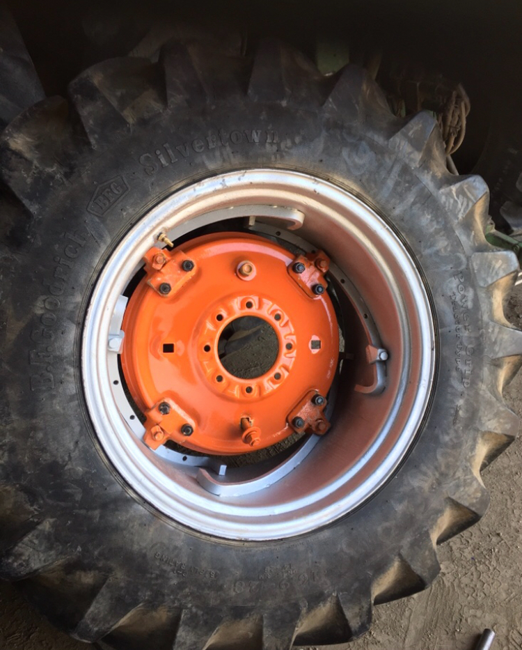

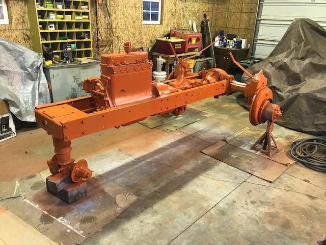

Hi Garden_guy,
Sorry for the delay in giving an update on the PPG paint.
I have been painting a lot since July and below is a photo of my painting tractor parts with the new non-lead PPG 60080.  The lighting does play with the tone color.  This is under fluorescent lighting.
I have most parts painted and will show more pictures as I get the C together.
