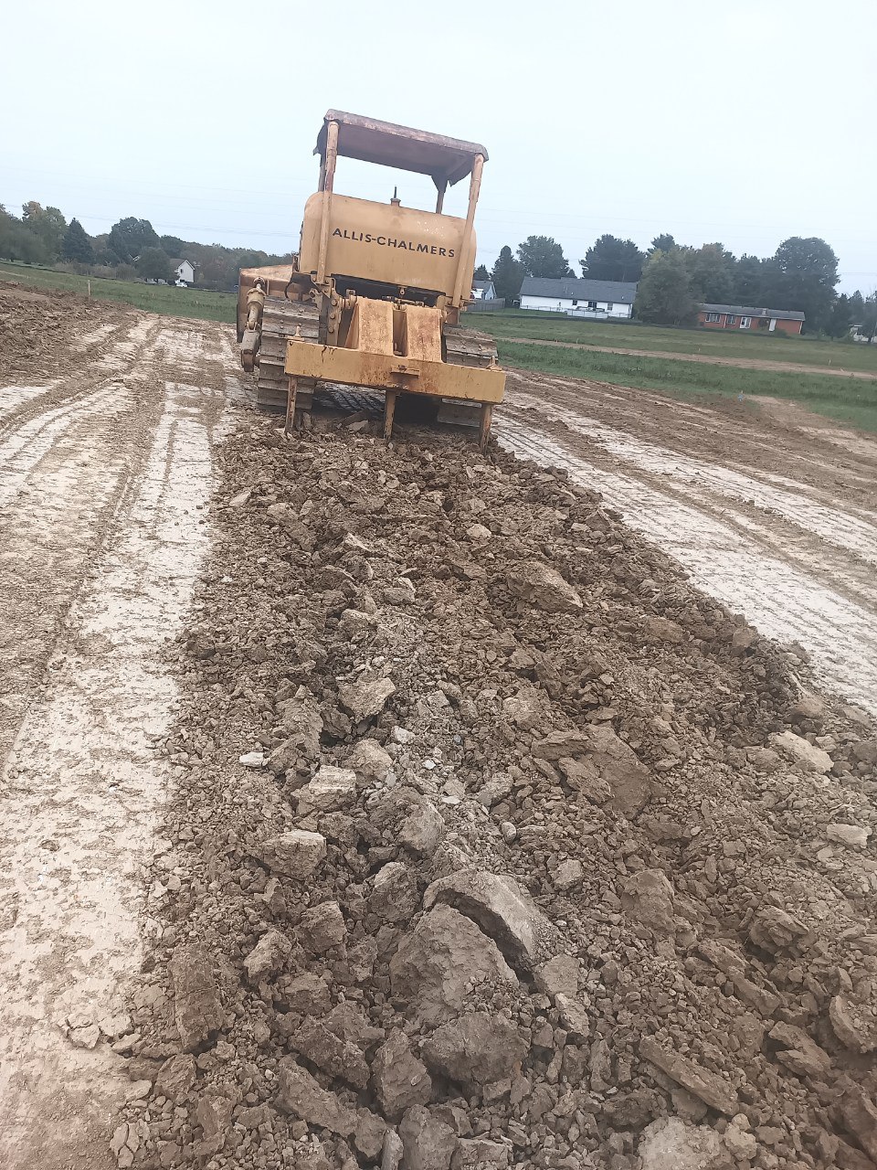

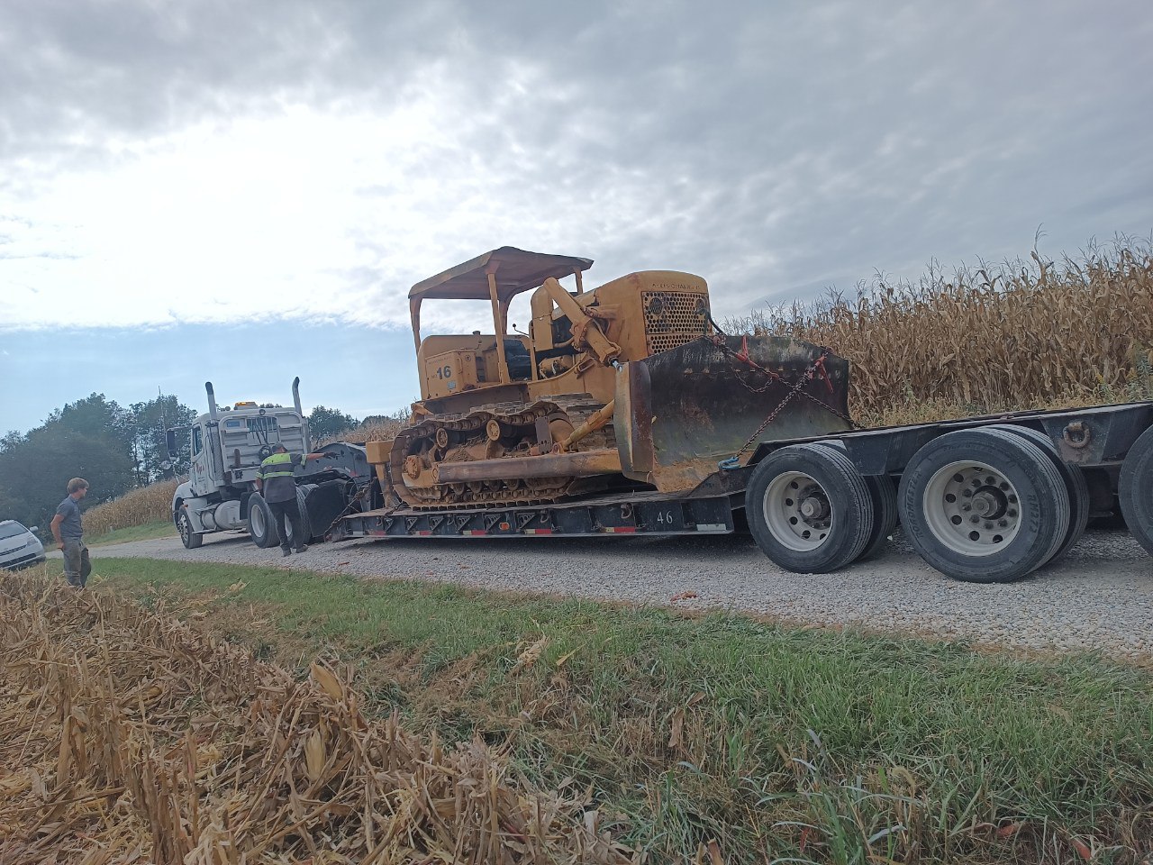

Got it home in one piece this evening and couldn't wait... had to give it a go in the rock hard clay. I love the results!!!

The ripper, while showing three tines, is actually capable of holding 5 tines.  I'm thinking this is just the ticket for a subdivision development we are building where we have decided to use lime mixed into the soil to stabilize the road bed.  I'm thinking this would/should be the first step after grading to prepare the soil for the lime.  Thoughts on where I might look for a couple of matching tines?

It's been suggested that I'd be better off leaving it with 3 tines.  The 'ol girl does have a bit of age on her and it's my understanding that the final drives have a week point in them of potentially stripping the splines.  Placing the additional tines on there may make her work a bit harder than she needs to be at this stage of her life.  Thus far I have found the 3 tines to be doing an excellent job and I have never seen the scraper fill up the bowl so quickly as it is following behind as I rip.  Expecting this to make a tremendous difference in moving all this soil.

Is a company here that adds stabilizing lime to soil on road projects, use a Rome Disc to cut it in as is faster than ripping.
