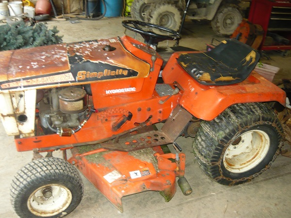

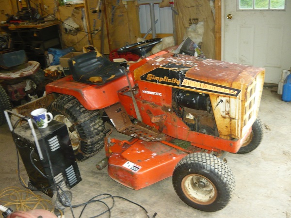

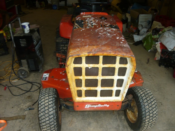

There it is, just as I got it, bird crap and all...
