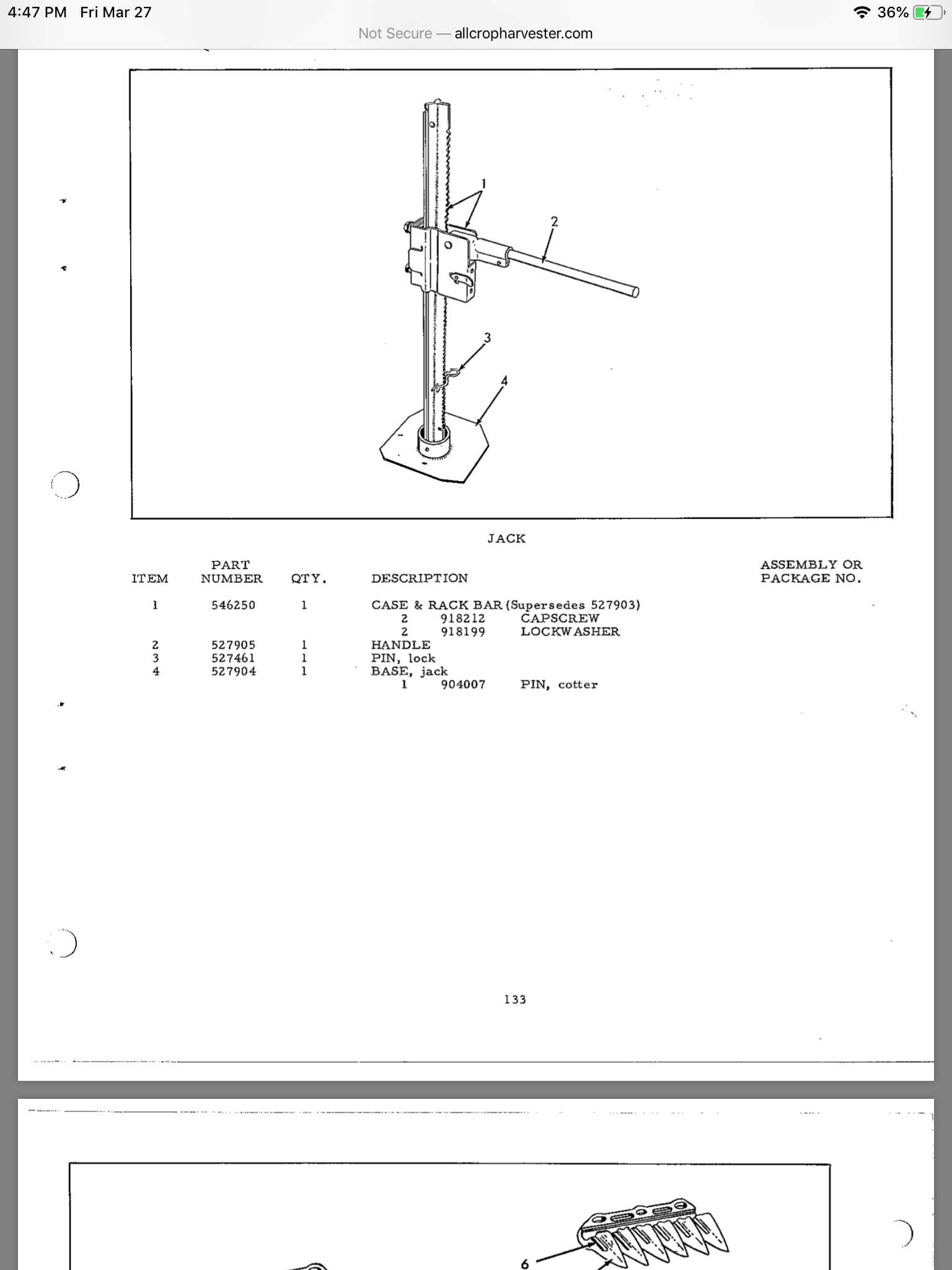

Here's a picture of my T-Post style. It mounts exactly the same as the one Dave posted. Now we just need a picture of the one on the left from Fred's post.

Found this one in the All Crop 90 parts book. Looks like the T-post jack like GreenOrange was describing.

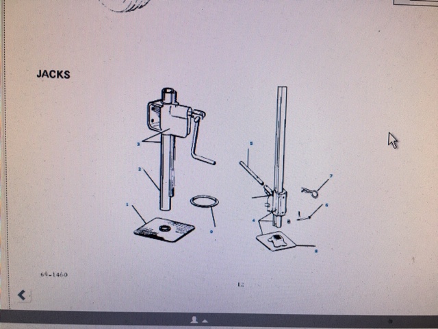

The jack on the left in Fred’s picture is what’s on my roto baler.
You happen to have any photos you could upload of your jack?
Just wondering if it a side wind or top wind jack. The one in the Fred’s picture looks like a side wind.

I'm aware of three types of A-C jacks:
#1 - Early type, very similar to what Dave has pictured, but the column is constructed nearly like a T-Post (steel fence post, depending where you're from)
#2 - The one Dave has pictured, with the column being almost trapezoidal or keystone shaped in profile and hollow
#3 - The one on the left, which has a round tube for the column
There are probably others, I just have not seen them or maybe not verified as A-C. I have the one from my 110 Spreader, which is the #1 variety. I'll try to get a photo and add it.

The 77m rake used the one on the right. Tracy

The 180 spreader used the one on the left in the picture.

This is a 303 baler ,some mowers used ones like on right
