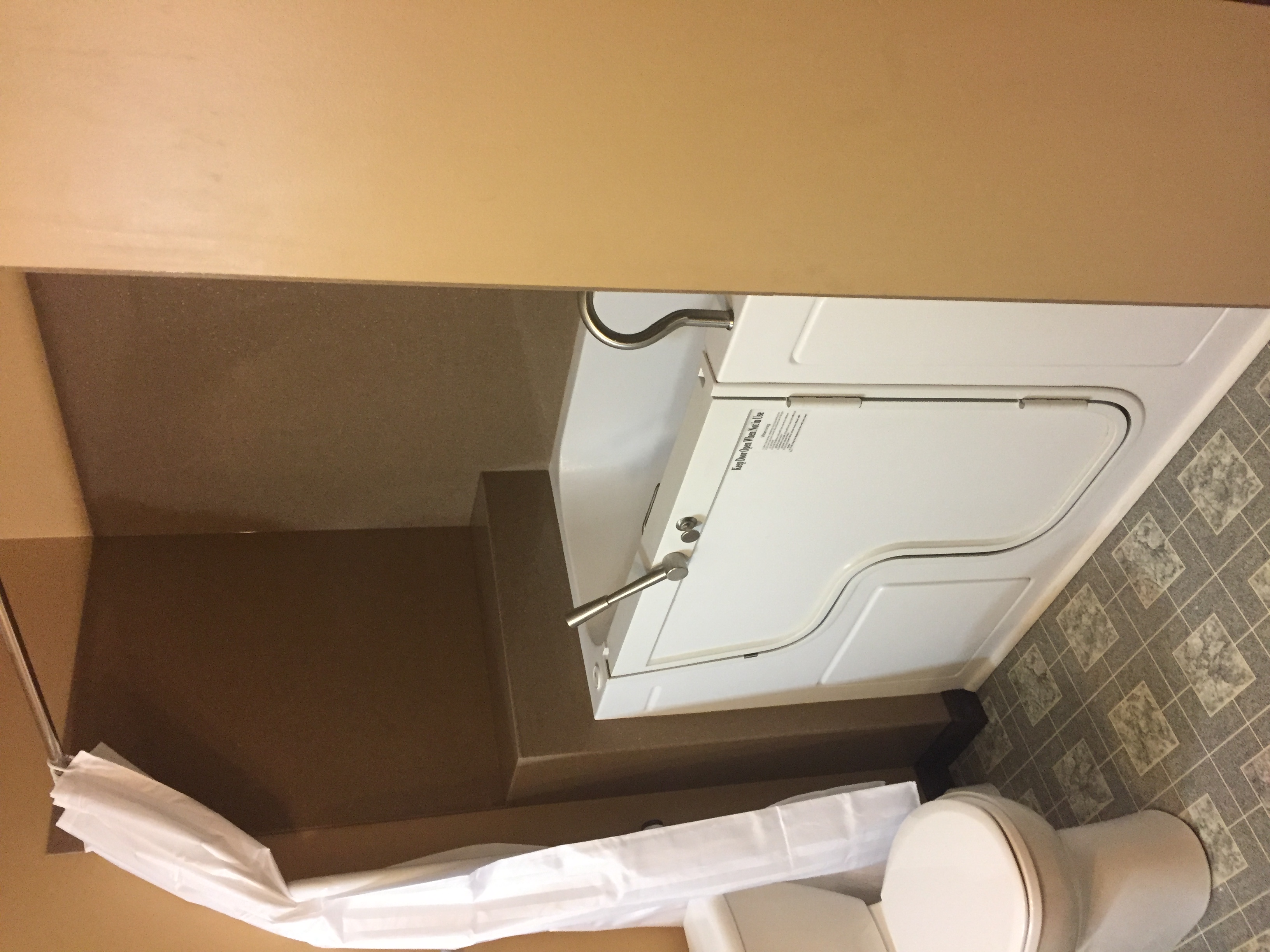

I am a trim carpenter at a pharmacy in Omaha! We call ourselves the ‘mod squad’ because we modify homes so people can live in them better/longer! We install onyx a lot! Only get it from Kansas! Here is one I finished last week!
