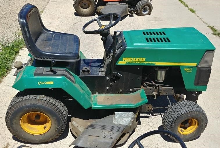

Here's a pulley size calculator I use that has a few different scenarios use can throw at it. Been really helpful, and easy peezy is what I like.

Chaska you have a pic of that 16hp weedeater?

Bruce (Fixer1958) I just covered it up with tarping and all bungeed down for the winter yesterday.  This one is not mine but looks the same.
That's actually the gas tank cap sitting on the console, should be on the tank under the hood.

Didn't know Weedeater tagged a riding lawnmower.
I was waiting to see a 16hp weed wacker.

 Say Chask,,,that has to be the very first Weed Eater brand rider I ever seen,,and I've worked on a whole bunch of them,,, Good lookin machine,,!! Just you wait til ole Shameless sees them yellow wheels,,,he gonna think that is one of them Green tractors he like so much,,,,,ClapLOLLOL

Joe, I'm sure Shammers will understand it's for them citybot weeds of mine. It shows all kinds of respect to my Allis B, so does my 79 Dynamark, 91 Dakota, and 96 Caravan. Allis is 81 yrs old now.
Hey Fixer, I wish I could sling a 16hp hand held weed wacker around, talk about needin some cannons.
