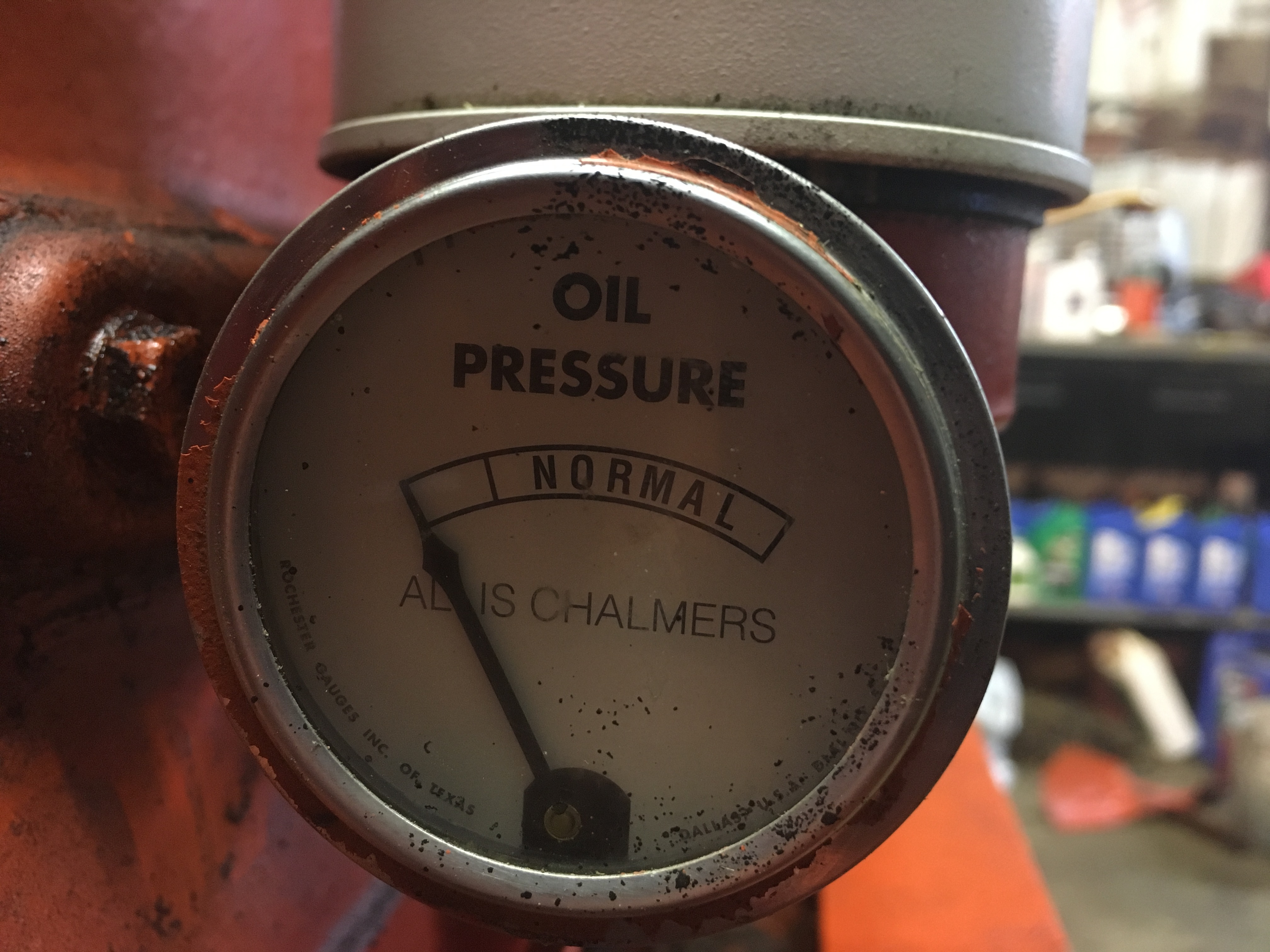

I have a question about my wd45’s oil pressure when I start it up the needle on the gauge reads about N in the word Normal when warmed up it is at the mark right before the N how much pressure is this and is this something to worry about? Thanks

If I remember right, they are 30 psi gauges.
Here's how I tested out my gauge at 10, 15, 20, and 30 psi.

I do believe I have read that before that they are 30 psi guages thanks for the pictures. I think I'd be okay then at 10 psi

Well, if it's on the mark before the N when it's warm, that might be around 5 psi. Which still might be OK, but I think she is worn.

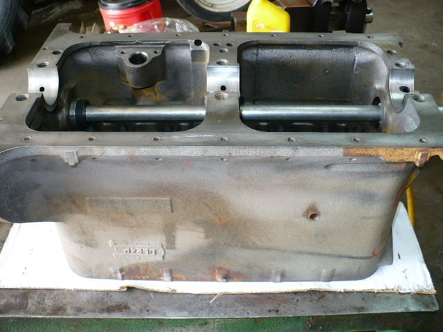

On the WD 45 style engines, if the oil pressure is low usually changing cam bearings will bring it back up.  The oil goes to the cam first and if the bearings are loose, you lose most of your pressure there.  A friend had a similar issue, engine was pretty tight  (very little blow by and made good power), but had very little oil pressure.  We changed the cam bearings and brought the pressure back up.

I was just reading through this post. I currently have the oil pan off the engine to change the pan gasket. How much work is required to replace the cam bearings. I'm not necessarily going to change them just curious of what all needs to be done.

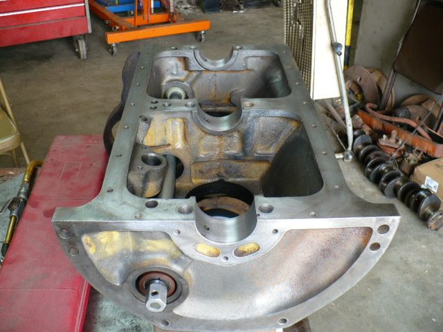

The engine will need to come out to get the cam bearing changed, like this.

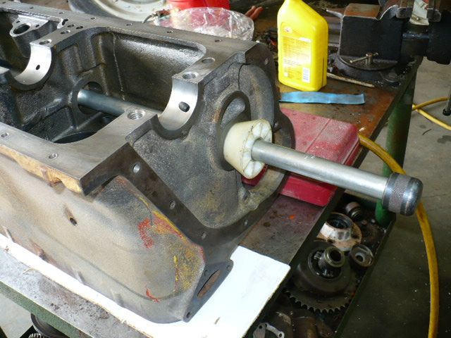

Don, is that a special puller or how tricky is it for an amateur to replace? Ive got a 45 and a D14 on the list that both need that job done.
Adam you can install them with a cam bearing driver like this and you might rent one from the parts store, if you are thinking about trying to do them send me a PM with your phone number and I will walk you through it.

Looking at the pressure guage on my tractor I noticed the box that the letters are in is slightly longer than the pictures posted above. Is mine a 30psi guage or is it different since the face is slightly different?

If someone hasn't already said so, just install a known good quality 30# gauge to see what you really have for pressure.
