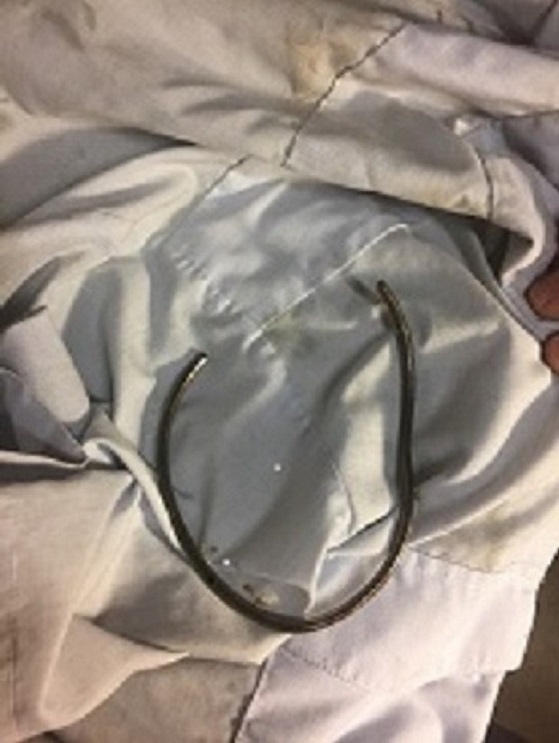

Had a rough day in the shop today. Was making some new gaskets, one was for the clutch cover. As I was lowering the cover and gasket back in place I knocked one of the bolts down inside. Mad and paniced I started reaching in trying to fish it out. Finally managed to fish out the bolt with an extendable magnet the size of a pencil. In the process I knocked loose what I thought was a piece of number nine wire. I didn't think it should have been in there so I set it aside. After replacing the cover I looked over and noticed the piece I had removed. After discussing it with my father-in-law I decided to ask you guys a few questions.
What is it?
Where does it go?
And how bad have I screwed something up by taking it out?
Unfortunately I can't get the picture to upload. It says the file size is too large and I don't know what to do about it. It's a horseshoe shaped piece of metal, looks a lot like number nine wire. Please help.

Is it a piece of safety wire maybe?

Okay, Here goes again. Got it resized in paintbrush, hopefully it's not too small. Guess if nothing else I learned how to do this today.

Doesn't look like anything I ever saw inside as tranny. Think you did good snaking it outta there.

How stiff is it?
Snap ring off the wet clutch??

I'm with the other Gary !
Part of the 'Pressure Washer Retainer' Snap Ring from a previous failure.

Whatever it is, it's been there for a long time and not functioning as a useful part.

It's pretty stiff. That's what led us to start thinking it was an actual part of the clutch. Yes, it has been there a while, no it's not functioning, and no, it shouldn't have been where it was. It was just waiting to get caught in the gears inside there.
My next concern is, what's not working right because of this possibly failed part. I don't have the time, ability, or money to split the tractor and fix it. Here's hoping it turns out to be nothing in the end.

That realt looks like the snap ring that goes on the hand clutch. As long as your hand clutch is working properly I'd just put the cover back on and forget it. We find lots of extra parts in the tractors we've split at the farm. Left overs from previous farmer fixes.

I don't think there was any way you could have dislodged the actual wet clutch snap ring by fishing out a bolt so I would do as Dave suggests.

Do you still have the cover off? You should be able to see the snap ring in place on the clutch. I had a hard time finding it myself until I realized it is quite large in size and diameter. Take a couple pictures of the clutch assembly and post for us. My guess is that like other your going to be fine and its a good thing to get out of there too.

The problem will come if you ever take the hand clutch out, that ring is what holds everything together.

Thanks guys. I'll be honest, that's a big relief for me. Chris, I had already put the cover back on before I remembered the mystery part laying on the bench. I was just glad I got my bolt back at the time and wanted to seal it up before more junk fell inside. Removing the cover again doesn't exactly fill me with warm and fuzzy feelings. The general opinion is that it probably isn't a major issue so I'm gonna just leave it at that. As far as I know the hand clutch is working, although I really haven't tested it to any degree.

I had that snap ring come off on my 45s live power clutch once. My boy wanted to do some bush hogging I told him to use the WF because that spring I was plowing with the 45 and I heard a noise in the torque housing and I hadn't had time to look at it but of course he put the 45 on the bush hog. I went to move the 45 one day after he used it let the clutch out even in neutral it would kill the engine the snap ring had got down in the pto gears and smashed them I to take the torch and cut the rest of the cogs off the upper gear so I could drive it. So the it was time to fix.
