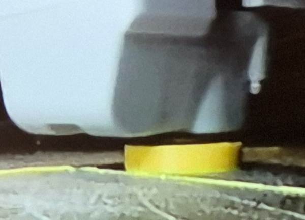

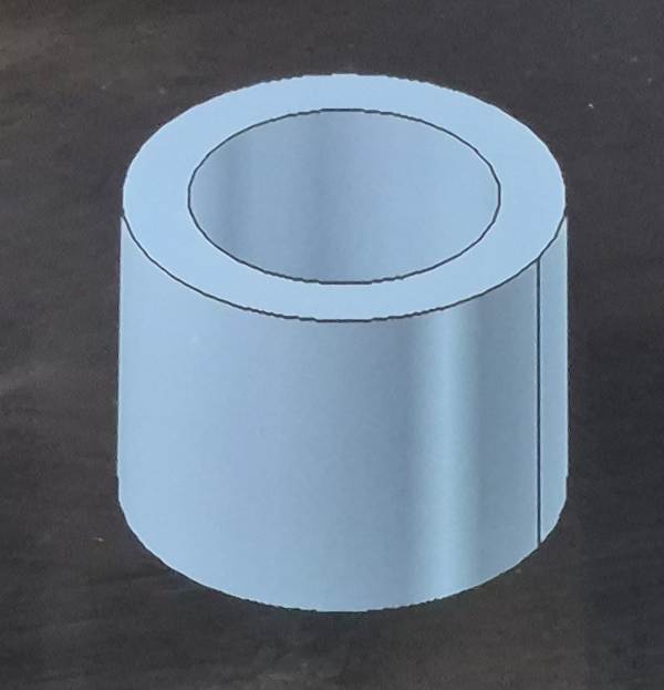

I got tired of looking for just the right plastic bushings, and making bushings from plastic on my lathe... I bought a 3D printer, loaded it with PET-G filament, and never looked back...
1 1/4 inch outside diameter and a 7/8 inside diameter...  HOW LONG?
I can draw that bushing in 4 minutes, and print it in probably 10.  PM me your address, and tell me length, and how many you need!

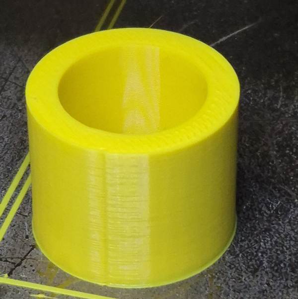

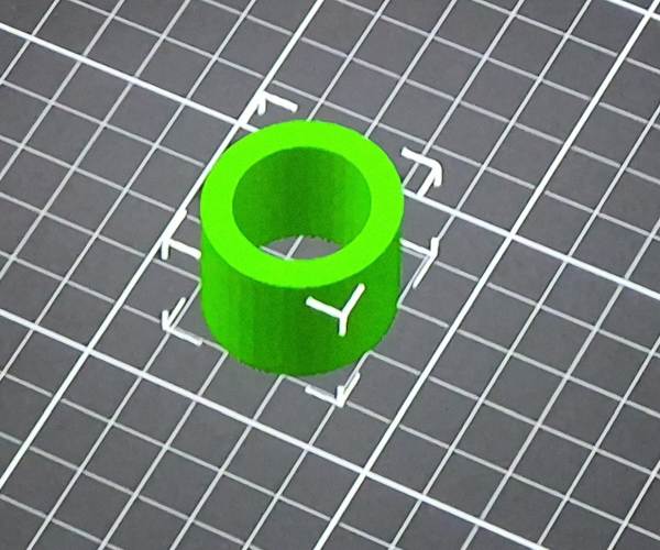

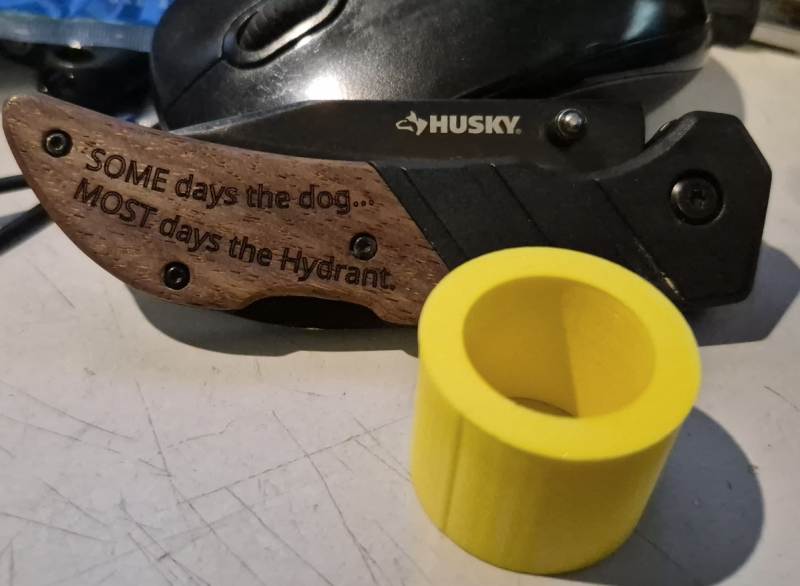

Post Options Post Options   Thanks (0) Thanks(0)   Quote DaveKamp Quote  Post ReplyReply Direct Link To This Post Posted: 31 minutes ago at 12:00am
Correction... I drew it in 3... and going full solid (100% infill) it takes 18 minutes, plus the 4 minutes it does for self-test/calibration before a run...  this one is only an inch long, but it's running now.
I drew these to exact dimension... the printer nozzle is usually pretty accurate, but when going full-solid sometimes the IDs are a smidgen tight, and the ODs are a smidgen fat... so if either are really critical (meaning, it won't work with any variation), then either it gets hand-dressed to size (sandpaper on a dowel) or I make a little adjustment to the drawing to compensate, and re-run it.
