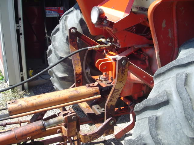

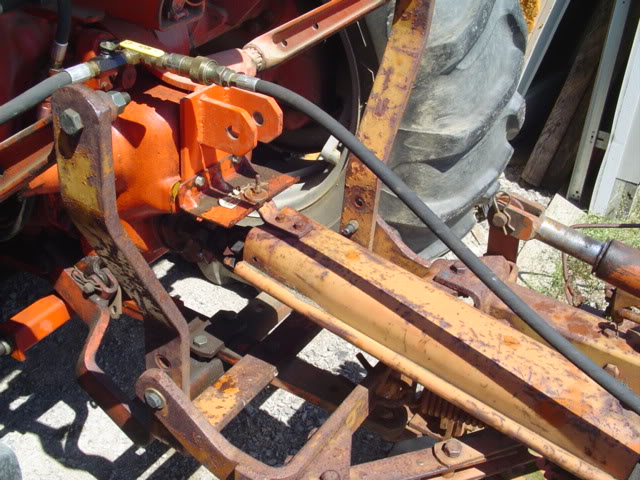

I tried mounting it on the WD-45 today, think i got it figured out, but not sure, look at the pics and see if its right, also, what i the procedure on operating the mower, where to put the lift arms on tractor, the cylinder on the mower, and so on. and how do you get the lift arms to stop lifting, even in the off position they lift slowly, i've played with the linkage too, any help appreciated.
Thanks, Carl

With the old style hitch for the WD and #3 mower, I bolted it to the drawbar. That kept the mower at the right hight and the lift arms stayed put.

Carl...That is one good looking #3.  I am thinking that you need the drawbar on.  Also might there be two straps that go from the hitch bail to the rams to act as a stop?  Others may be more familiar.....Dale

You need to put the draw bar back on Pin the Bail in the lowest hole.One bolt goes throught the bottom of the U in to the drawbar. the lift arms will then be fixed full up. a lift cylinder is used to raise and lower the cutting bar.

 All above are correct. bolt mount to drawbar & add cylinder to lift cutter bar. Had a mower just like that for 10 yrs or so...Harvey

ok, so do i even need them other arms? The way it looks, you have to manualy lift the sickle, is there a way to fix that?

Yes the other arms serve to stiffen the whole hitch assy.    You need to put a remote cylinder on the mower to lift it hydralicly.  The cylinder goes on where you have the come a long hooked  and to the other bracket at the front of the frame,  look at BopH's picture-it shows the front of the cylinder. They are kind of a shaker but do work fine, dont run it much over 1/2 throttle.   Good luck.

I never used the other brackets,just bolted 3 points,drawbar and 2 lift arms.

I got it mounted, took me for ever, i ended up unbolting the U from the frame, put that on first, then backed up and bolted the rest together, what a pain.. I'm going to get a cylinder from fleet farm. but i was wondering if i could make something to lift the sickle up, rather then getting off the tractor to lift it up everytime.
