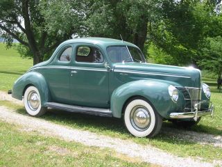

I let dad's ole 40 sit to long without running it.
Now that brand new flat head V-8 is locked up. Can't spin it by hand anyway. I pulled the plugs and gave each hole 5 quirts of mystery oil.
Last started it in 2008. Prolly had 200 miles on thet brand new motor.
I still gots my A/C but it's clear out in the barn now.

Les I bought a 41 Ford that engine was rebuilt and then sat outside for 10 years I pulled the plugs filled cylinders with marvel mystery oil
Let it soak for two weeks then pulled it with tractor and popped the clutch. Motor freed up and put plugs back in and got it running. I would only do that as a last resort because when you pop the clutch it can really do some damage.
