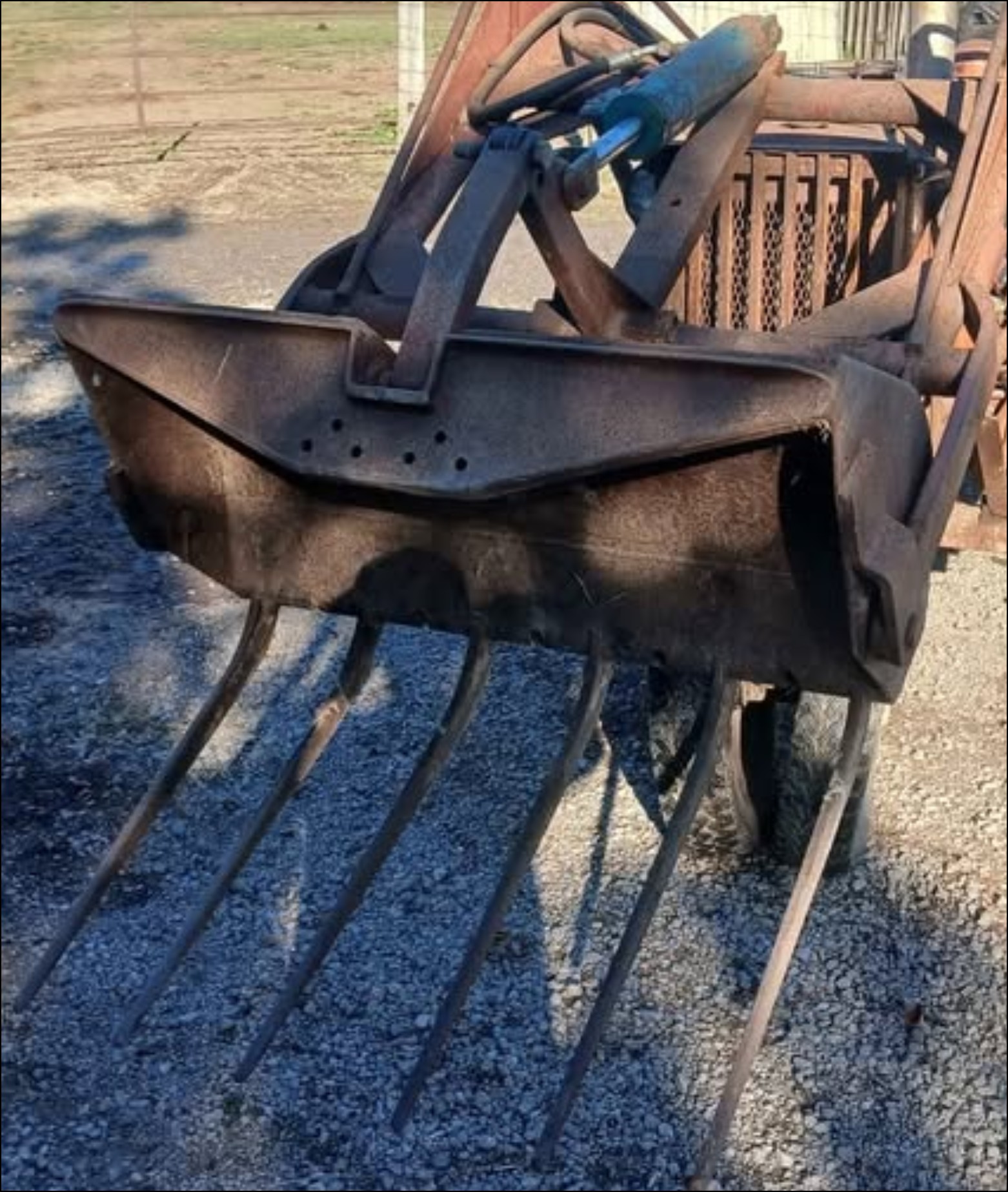

Hi.  I am looking a purchasing a CA with loader.  The loader has long manure forks attached to the bucket.  However, I am more likely to use the tractor for moving dirt and gravel.
I've tried searching for a plate or adapter to cover the forks somehow and allow the bucket to be used for materials, but I can't seem to find such a thing.  It looks like there is something similar to what I need in the third image on this page, https://forums.yesterdaystractors.com/threads/what-loader-are-these-for.1755672/ but the poster provided no info, or even the name of such a device!
Is there a decent solution for this problem, or should I look elsewhere for a loader with a different bucket.
Many thanks.
Points: 54315
Post Options Post Options   Thanks (0) Thanks(0)   Quote DiyDave Quote  Post ReplyReply Direct Link To This Post Posted: 13 Oct 2025 at 7:05pm
Post a picture of your loader bucket, will make things a lot clearer.  1 solution us to just get a proper dirt bucket for your loader.  Another would be to leave the forks on and have a welder fab up a removable plate that covers most of the tines, leaving just a few inches of the tips exposed at teeth.

Post Options Post Options   Thanks (0) Thanks(0)   Quote dark_knight Quote  Post ReplyReply Direct Link To This Post Posted: 13 Oct 2025 at 7:24pm
Good idea!  Thanks for the reply!  Here is the image.

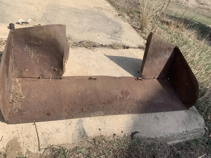

That bucket is not an original Allis CA loader bucket, a Model 8.
Allis had a 'Dirt Plate' available that slid over the Tines to create a Dirt Bucket.
There was also a Snow Bucket available that included a longer bottom Plate and also Plate Sides.

i would not bother trying to make it removable.. Just get the local weld shop to lay a 3/16 inch steel plate on the forks and weld in place... probable a wing on each end.. Not difficult at all.

find an old bucket of choice and run the forks thru the back and secure per your preference for permanent or removal...if you lived in the neighborhood, I'd give you one...

The mounting of loader on a CA is less than ideal. I have seen many photos of CA's that were broken at the bell housing because of too much strain put on the loader. I have a CA with a Model 8 loader and they are fine if you take into account the limitations of the equipment. That being said, from the picture you posted the loader has been modified to give hydraulic tilt. The bucket could have a plate made to slip over the forks. Can't tell from the picture but it appears to be a modified Model 100 loader. I wouldn't try to dig with it but for light jobs it would be fine.
