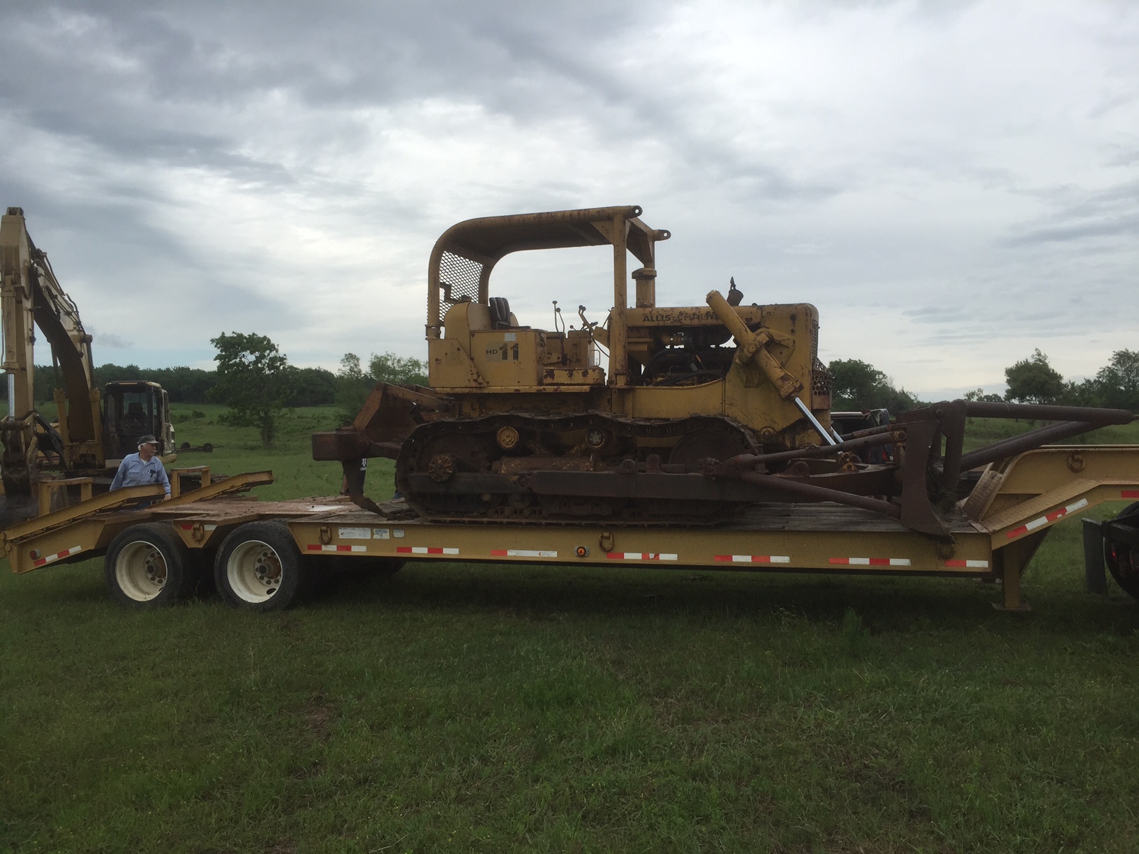

Hi first post, i just purchased my first Allis Chalmers a HD-11 ep. and thought this would be a good place to start. have some manuals ordered, but i wanted to ask what should i look for as far as maintenance/problem areas? any advice would be appreciated.

That looks like the dozer that was on Craigslist near Holdenville, OK. Did you purchase that machine from a Mr. Boyd?

It just so happens, it is the same dozer

That's great it started easily for you. I considered buying it but, figured I would have to camp out for days trying to get it running so I could drive it on a trailer.
Shipping costs were a show stopper for me. I'd be interested to know details of who you got to transport it, any troubles or hassle, and cost (if you don't mind).
Anyway, keep us posted on this. I'm really interested to see how this machine turns out.

thanks! I had a local farmer move it for me i only had about 50miles to go....small world lol

there are 2 series of HD11ep; early and late. early has twin disc torque converter, later is Rockford torque converter. changeover s/n is 13367. Also later ones have dash mounted air cleaner, yours looks the later air cleaner but check the chassis serial number to get the right books. last of the 11ep series have a 46Y prefix.

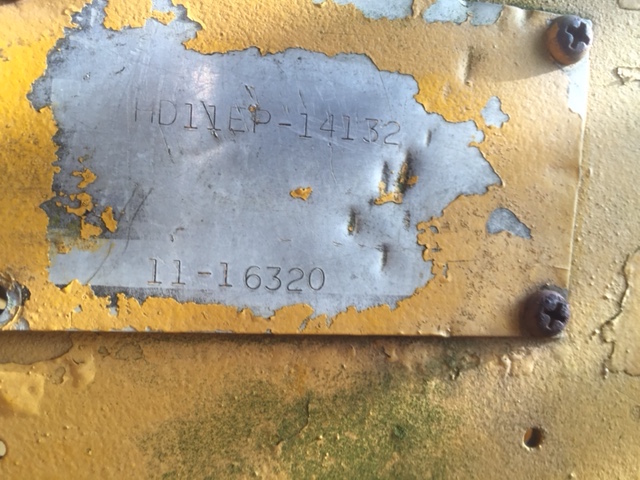

Heres a pic of the Chassis Serial #

Het Merv  , I think you are correct its a later model ,changes were  torque convertor , air cleaner, bonnet , upper radiator , solid  front Idlers , bolt on sprocket segments ,spin on fuel filters , larger fuel tank filler was moved to the right hand of the tank , gauges moved to the left of the steering levers , power brakes were replaced with double wrap type , there maybe a few more changes ? Also with the later torque convertor the hydraulic pump from a series B can be fitted to speed up the blade action

Should be a hard number stamped directly into the finals case at the rear.  Top right side but may be covered by the ripper tool head.
Still a nice looking machine save the custom exhaust lack of stack.

Nice looking machine baremetal. Your serial number makes it a 69 model.I have a 68 model with the serial number 13204. I don't know what happened but my machine has the Rockford torque but according to the parts book and hd6 mere should have the twin disc. I'm looking to sell the machine and all my spare parts plus a heavy duty root rake made for the c frame. My 16b does all the work Around the farm now. 252 916 2927

Boy I'd love to have those rippers...

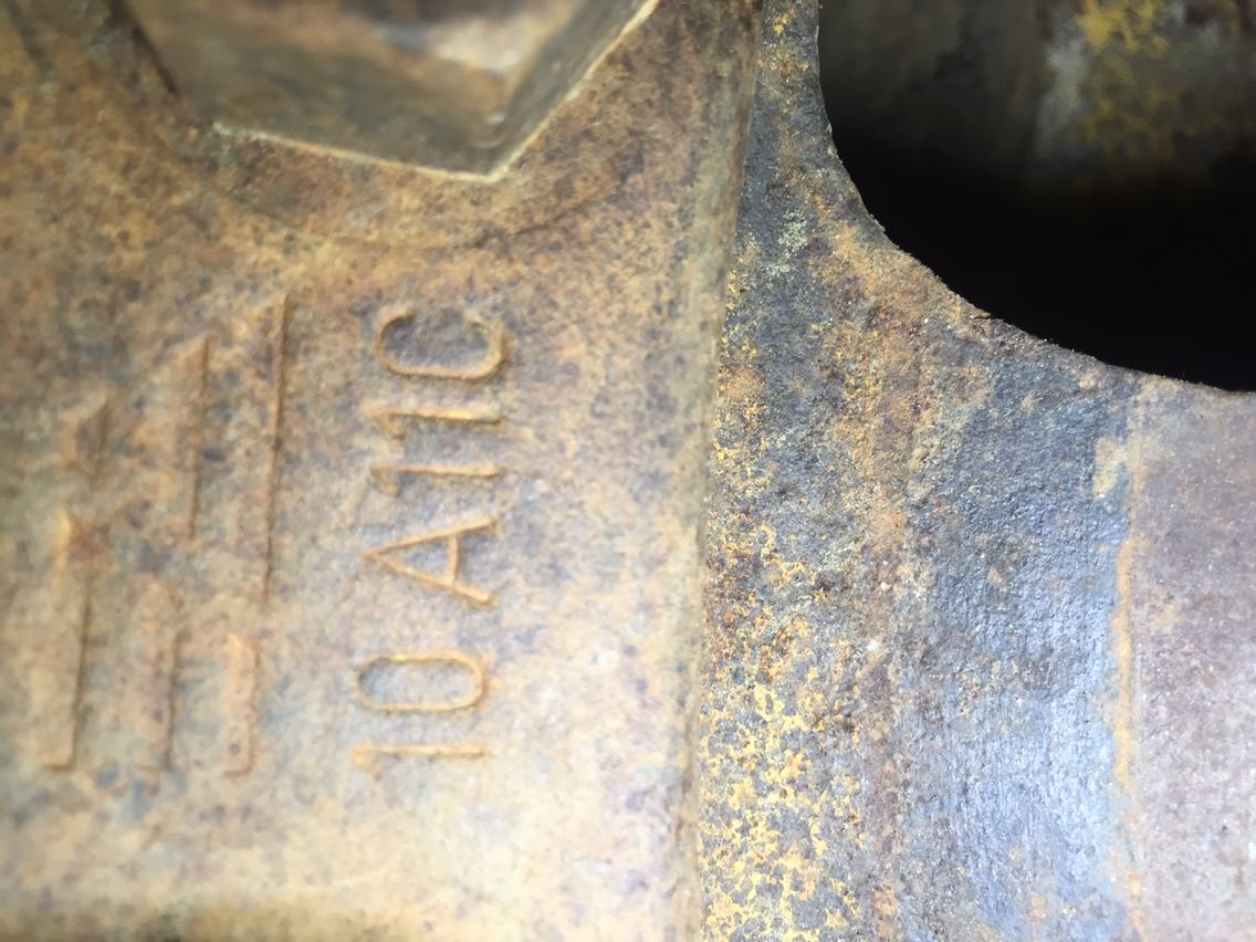

Finally got home from vacation and caught up on work enough to get some dozer time in. Got two leaky hydraulic hoses changed and fluids drained and topped off. Pleased to report every thing at least seems to be working as it's supposed too. Two issues ive found:
1. the hydraulic track tensioner seal on the left side is completely blown out. I have two on order from minn par, Does anyone know if you can change this seal without splitting the track? seems like ive read you can?
2. the rear sprockets have apparently been updated to removable sections at some point and are getting a bit sharp the sections have FA and 10A11C stamped on them. can anyone help identify the origin of these? and are they still available? or does anyone have or know of any for sale? I would be interested in buying some if anyone know of any.

Hi Cal, thanks for the reply, I will keep these in mind in case I cannot find the bolt on sections needed.

Are your sprocket segments in two halves or smaller sections?
The ones for FA 10's are two section and pretty close to HD 11 pitch

Hi Ian, they are smaller segments three or four bolt on each segment I believe

If it has been modified (i.e not Allis original) might they be Cat then?

Looks Like it has standard late EP same as series B sprockets

Ok thanks Steve so they are off a series b then, that helps, does anyone have a good source for these or are they only available used?

Rebuilders of South Carolina- 1 843 693 1558, talk to George- still has a bunch of NOS HD11 parts including track adjuster seals, sprockets and rollers.  Tell him Trevor sent you.
