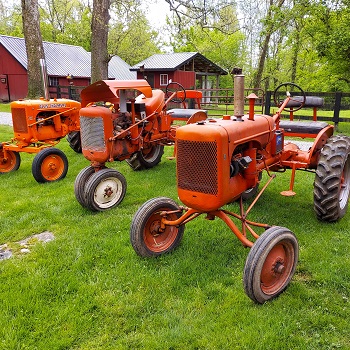

Brought home two new projects from auction on Saturday.  A 1949 B and 1944 C, to go along with my 1951 CA.  Both the B and C are non-runners - wish me luck.

Looks like good starting points. Good luck and keep us posted
Points: 88482
Post Options Post Options   Thanks (0) Thanks(0)   Quote steve(ill) Quote  Post ReplyReply Direct Link To This Post Posted: 03 May 2023 at 8:13am
YEP... as NON RUNNERS go... those are GEMS !

Got the Allis C running today with pull start after sorting out minor electrical connection issues.  Gears, clutch and brakes seem okay.  Didn't see any leakage from hairline crack in block.
