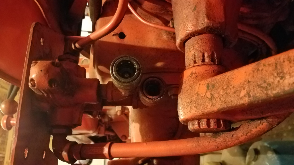

The control lever on the real left (next to seat) has 2 quick connect ports - The top looks used, the bottom unused for a long time.
I connected the 1 hose to the top port - Nothing. Tried adjusting the knob behingd the seat and still nothing.
There is fluid that will seep from the ports if i push in the center - Only tried it with tractor powered off.

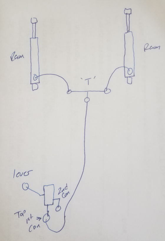

Here is a pic/drawing of the Hydraulic system that i currently have set up:

It does not show how the valve is connected to the tractors hydraulics. I suspect the lift arm need to tied down or fully raised before the loader will operate.

that was an option for running a double acting cylinder. Your normal output line, which I am assuming is now working your loader hydraulics would go to the in port of this valve.  There should be another line going back to the torque tube. This would be your out line. Then the double acting cylinder would hook to the ports in the picture. You would raise the lever under the steering wheel sending oil to the valve next to the seat. Then you would work the valve next to the seat to work your double acting cylinder.

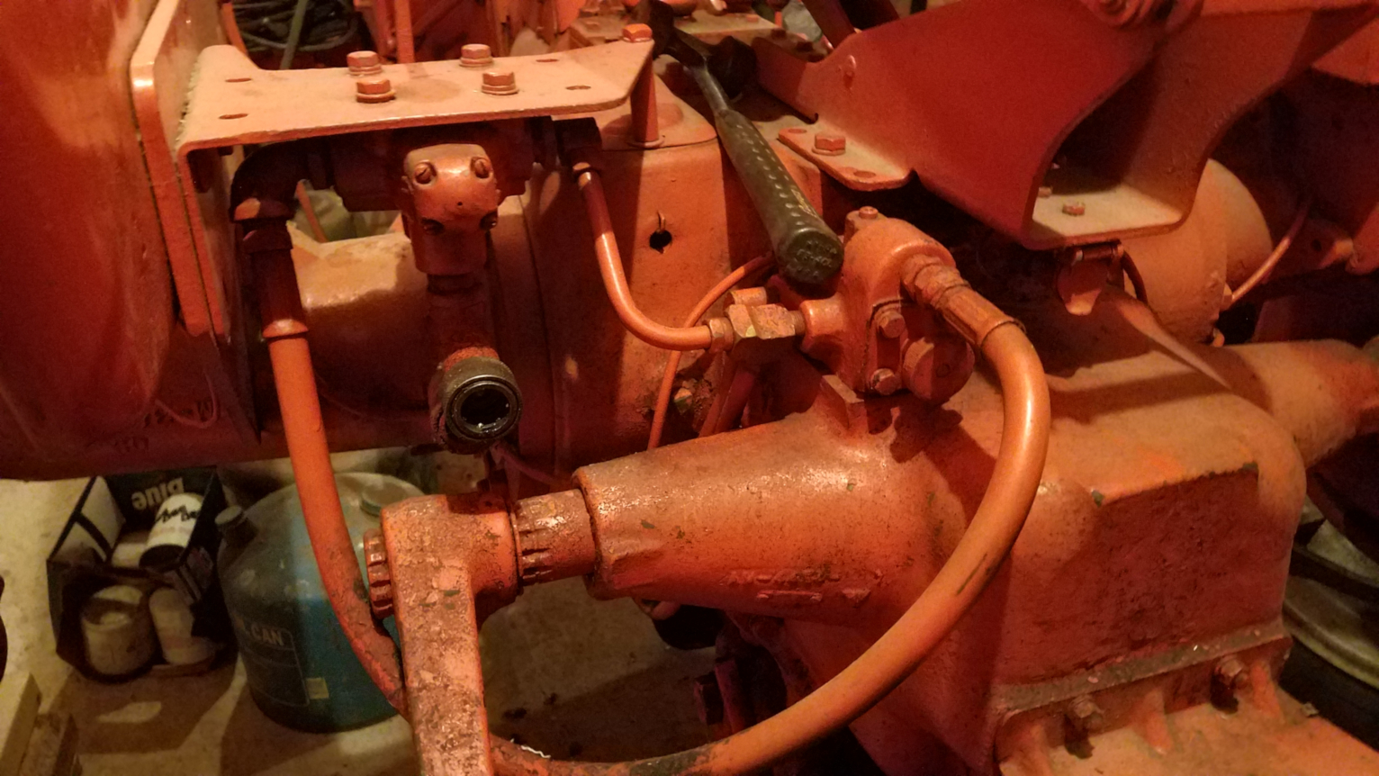

Here is another pic of the valve handle if it helps:

Post Options Post Options   Thanks (0) Thanks(0)   Quote DonDittmar Quote  Post ReplyReply Direct Link To This Post Posted: 12 Jul 2020 at 7:02pm
The valve with the knob is the transport valve. It’s is used for traction booster implements that hook to the snap coupler under the tractor. You could take the hose coming out of this valve going to the lever next to the seat off and put the house going to your loader lift rams here and use the lever under the steering wheel to work your loader. May be a bit more convenient.
The valve next to the seat was an add on for double acting rams.
