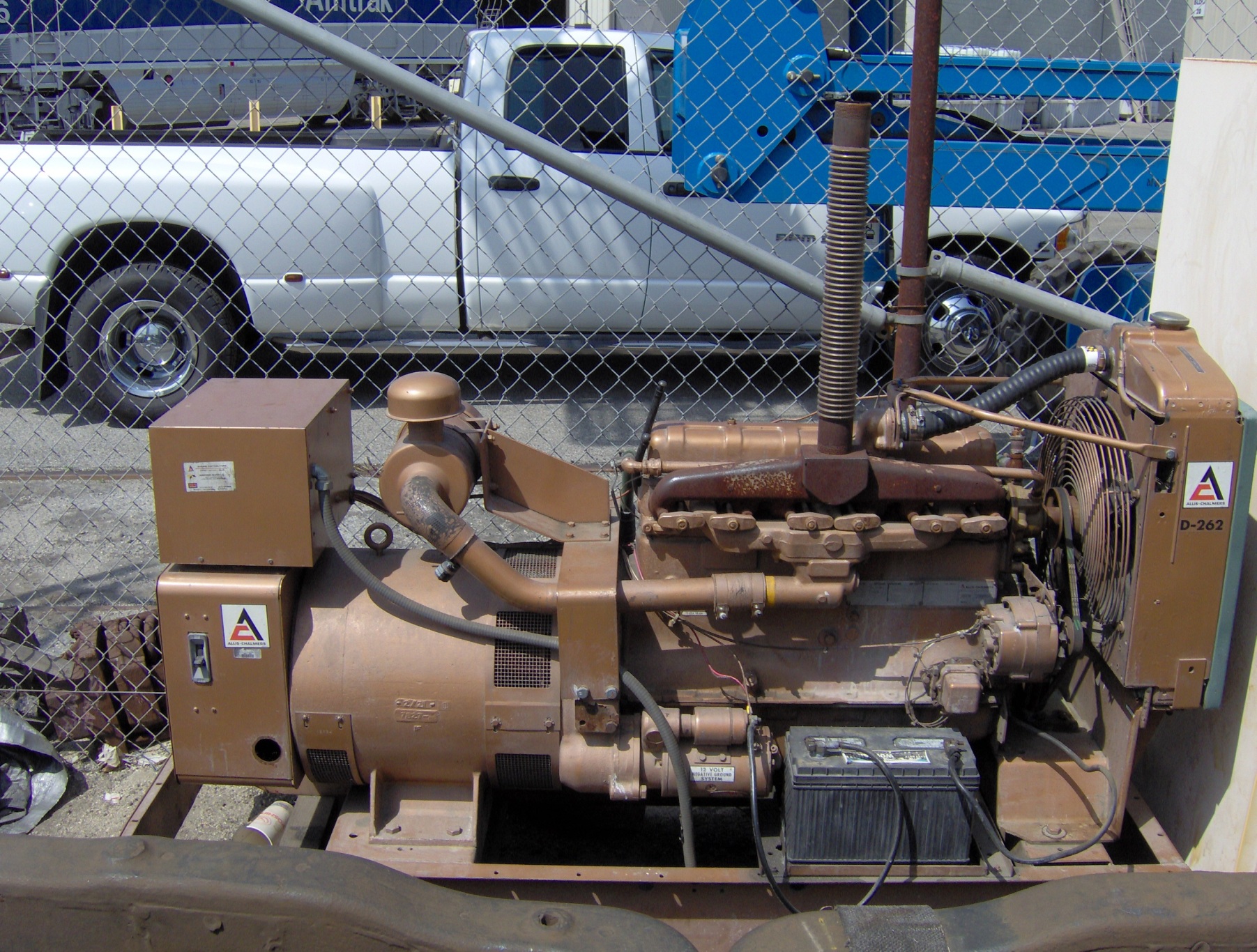

I should have posted this photo with my original posting.
ACjack View Drop Down
Joined: 13 Sep 2014
Location: Peoria, Arizona
Points: 277
Post Options Post Options   Thanks (1) Thanks(1)   Quote ACjack Quote  Post ReplyReply Direct Link To This Post Posted: 06 Aug 2017 at 7:55pm
Look at the data plate that's on the engine in this picture. It will list all of the option groups that made up this particular build. A outfit or person with the AC parts listings should be able to look up the individual option groups which in turn will list each individual part numbers for every nut and bolt that went into this generator set build.

The data plate shows a part number of, "4514744, 17” Fan, Blower".  I've been using this number when contacting parts suppliers but evidently it's old enough that they no longer have a cross for it.  At least the folks I have talked to so far including AGCO.
[/QUOTE] [/QUOTE]
The number 4514744 17' FAN, BLOWER  that's on the data plate isn't the P/N for the fan but, is the group number. The group number breaks down into each individual P/N for each part that is used to make up the group. "IE" quantity and part number of mounting bolts, washers, spacer if used and the part number of the fan its self.

Ok.  Now I'm onboard.  I remember seeing those groups in some of the engine manuals I've been able to get my hands on.  I'll retrace my steps and start looking for the group.
