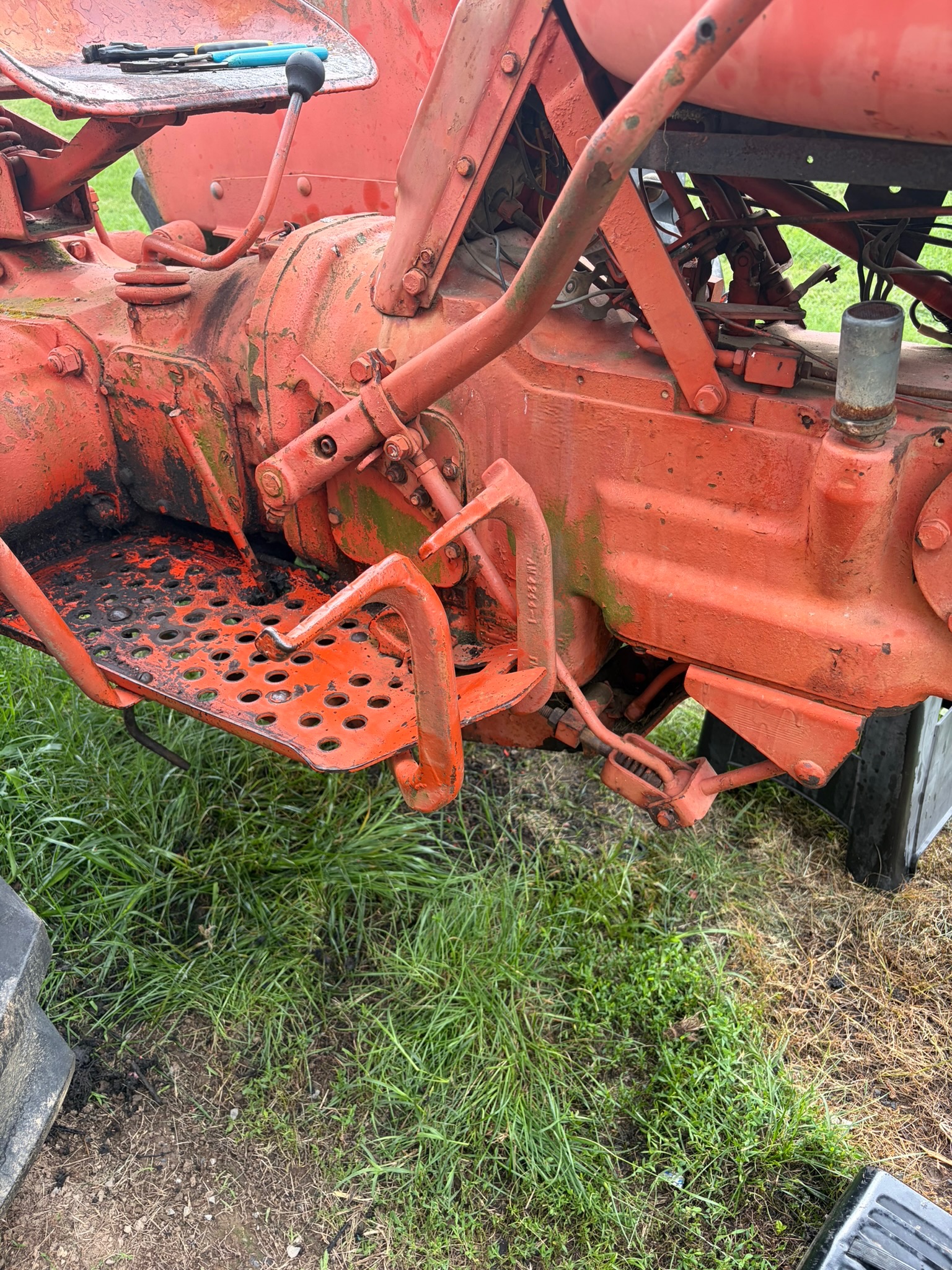

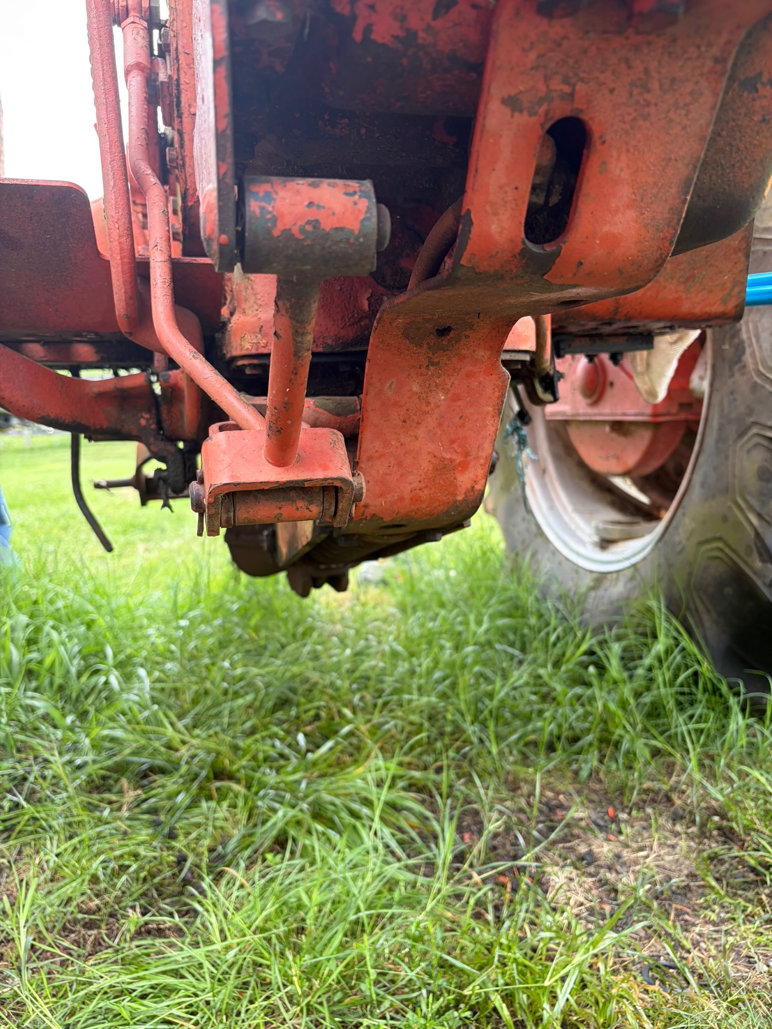

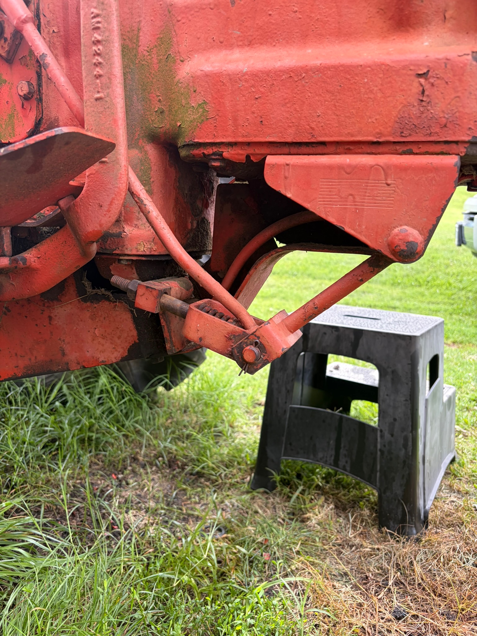

Went by a fellas place to help him on his D14 and it had this hand clutch kicker on it. I’m sorry, I don’t know the correct name but I do know what it does. Heard about them but I have never seen one before. Pretty cool to see one finally.

After creating the "rock throw-out" for the WD-series, they almost had to retain the same optional feature on the Dynamic new D-series !! The engineer had to really think outside the box with the two-speeds on the same lever.

1960 Sales book     Catalog number 283729 for the D-17 and 283728 for the D-14.   $13.30 list price      13 lbs       Field/Dealer installed only.

What's it do? Kick the power director in neutral? Thanks

Post Options Post Options   Thanks (0) Thanks(0)   Quote AC720Man Quote  Post ReplyReply Direct Link To This Post Posted: 22 Jul 2026 at 8:37am
Yes, if you run a moldboard plow it would be good to have one. If he decides to part out the tractor I may try to purchase it since I have 2 SC plows. Engine is locked up tight from sitting outside for many years.

Old Fordsons had a clutch kick-out on the three-points. All three of my Majors have it. They had a heavy 'U' cast bar that you swung up over the top link when hooking up, such that when a rock lifted the plow it would lift the 'U' disengage the clutch. Then had a lever you pulled up to re-engage the clutch and get off it. They also were availabe with custom top links with an internal hydraulic reservoir and hefty die spring, that would disengage the clutch hydraulically via a cylinder on the tractor if equipped. Supposedly a little more responsive. Have one of those top links in a shed somewhere.
In both cases they never saw much use around here. By the time they disengaged the clutch, you were already on top of the rock and had done any damage you were going to do. Most were never used. I suspect that was the same case on the Allis's. I've heard of them several times and know a couple guys who had taken theirs off, but never heard of one being practically used.
