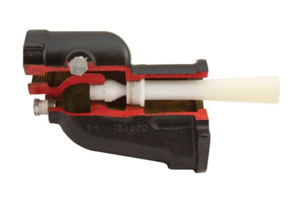

if your PUMP is good, then normally the venturi is worn out, or the NOZZLE is broke / gone.

the little white NOZZLE shoots into the lONG VENTURI... If you big pipe broke off, it might have broke the VENTURI off ?
