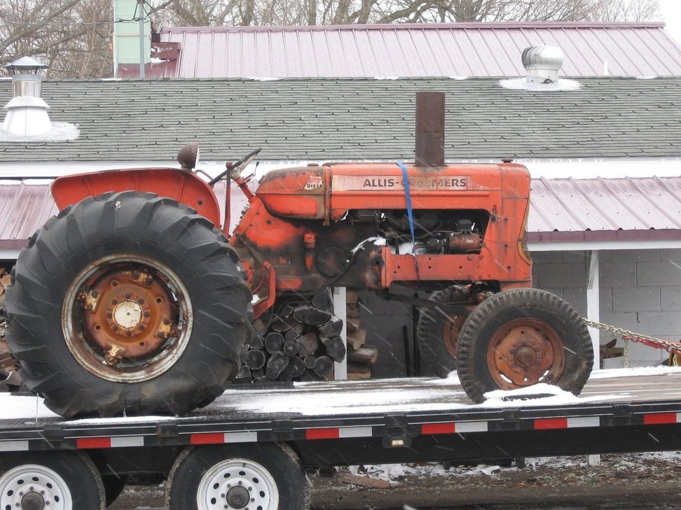

Eddie(IL) wasnt the only one working on a D15. Here is mine.....1968 D15D Series 2 diesel with factory 3 point. Next to the last D15 built with a serial number of D15D-25418
When I brought it home at the end of last April:

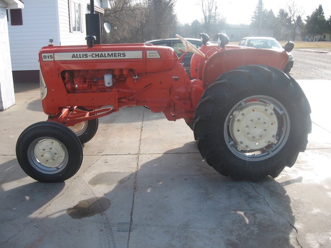

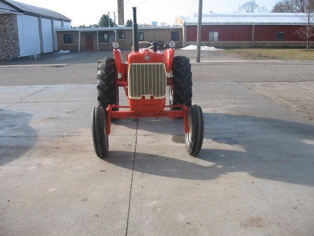

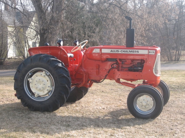

The "after" shots:

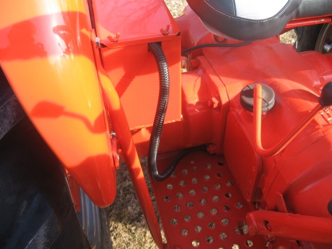

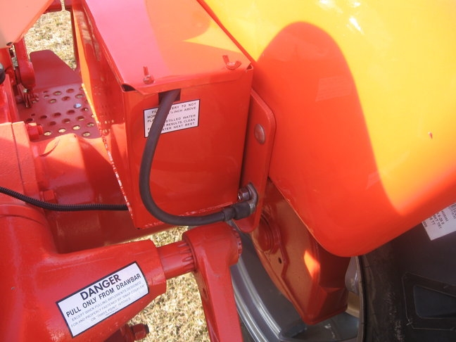

Fender mounted battery box built from scratch. Helps when your buddies dad has a metal brake

Looks great!  I've never even driven a D15 gas, not to mention a diesel.  I was just wondering if all the diesels had the battery box there on the fender.  I assume that's a second battery?  Did D15 diesels have 2 twelve volt batteries in a parallel circuit, or two big six volt batteries in series?

Yes, all D15D used 2 batteries with the second one on the fender, both were 12 volt. The one the fender is called a starting battery. It is a group 29NF, which is actually now a classic car battery.
