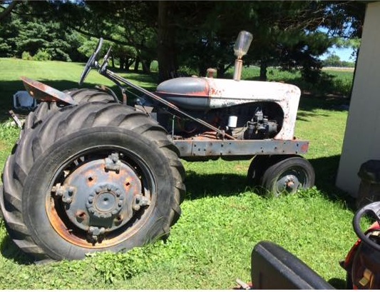

Hello everyone. I just got home with my first WD45...... It's been sitting for 18 months.
Stan IL&TN View Drop Down
Location: Elvis Land
Points: 6730
Post Options Post Options   Thanks (0) Thanks(0)   Quote Stan IL&TN Quote  Post ReplyReply Direct Link To This Post Posted: 23 May 2018 at 1:13pm
Welcome!!  She looks complete except for the fenders.  If you have any questions you have come to the right place.Thumbs Up

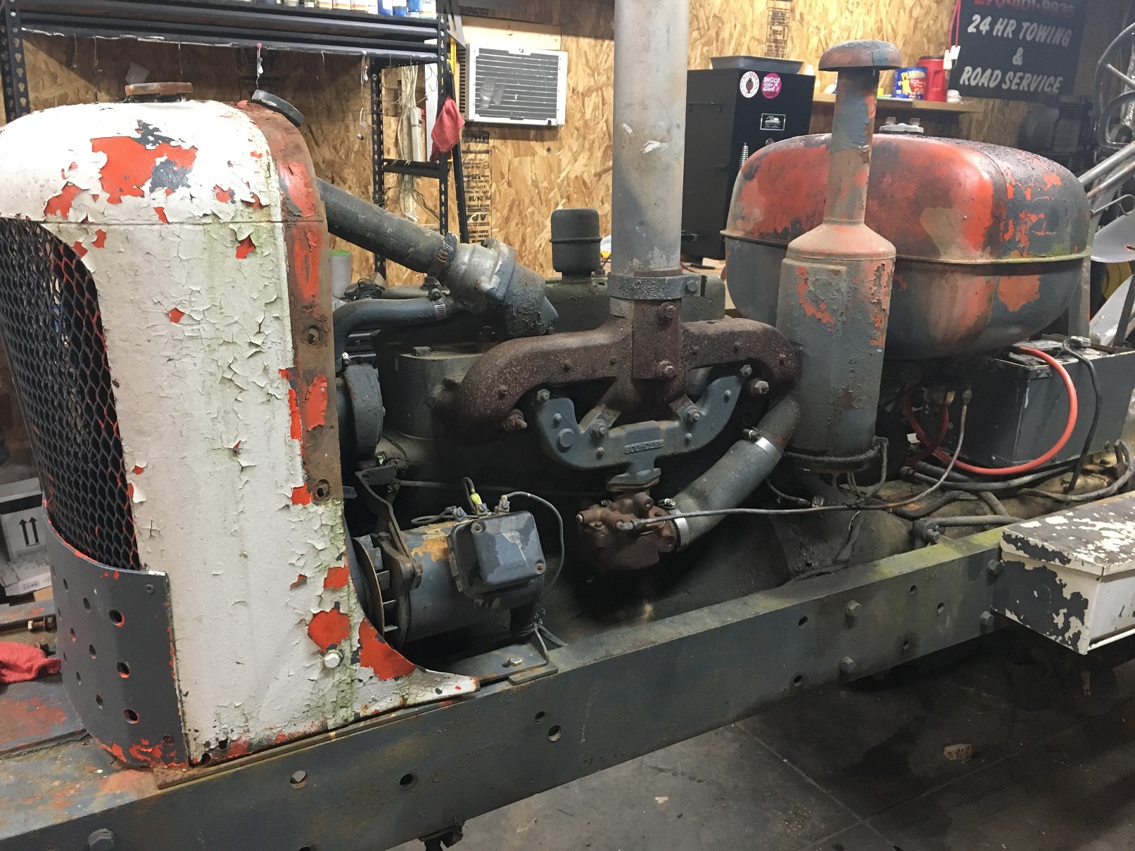

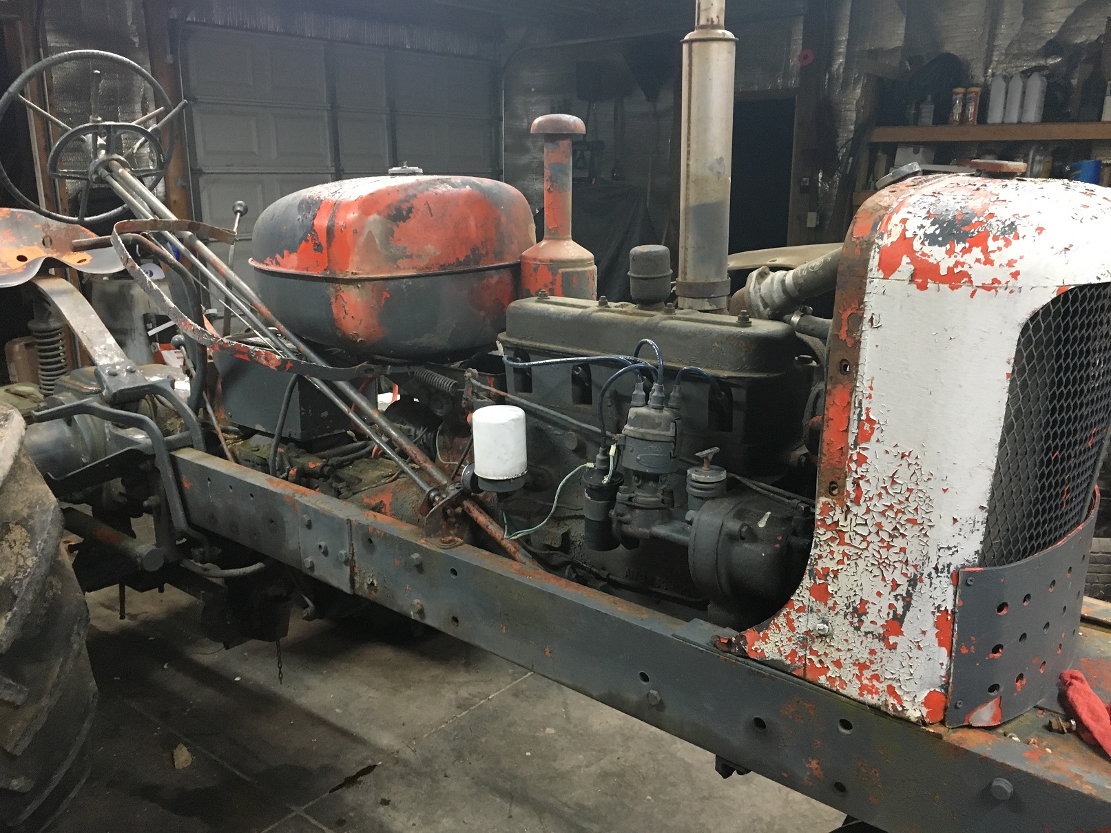

Thanks guys..... not my first old tractor, but it is my first bigger AC, I did have a 720 and still have a 712S. Even though I'm a fairly young guy, I love old iron.
Right now I'm working through checking it over to see what's broken, not working right, missing, etc on it. I got it running in less than an hour after dragging it home. The tank had water and other nasty in it..... flushed that out, put in some fresh gas and a hot battery.... I bet it didn't turn over 3 times until it was running.
It does have a slight pop/miss/puff sound from the exhaust while it's running. All 4 plugs look fine, are gapped correctly, and are similar in color. The plug wires are all connected good at the cap and plugs, and are in the correct firing order. The points look good and are gapped at .020. The valves are all set correctly and the tractor has 130 psi compression on each cylinder. The previous owner was told that it was rebuilt not long before he bought it 10 years ago. I took the carb apart and it was fairly clean inside to start with.... I cleaned it and put it back together, and adjusted it with no change in the miss/puff situation.

I've had a couple 45's they are a good tractor in that size range.   If it were me I would find a light to moderate load and just use it for a while, it may come out of it.  Looks like a recent new manifold.

Good Find. When I started my rebuilt WD engine it had a slight miss at slow speed. I moved the timing just a tiny bit and it smoothed right out. My D-17 would miss once in a while at idle. I put a hotter coil on it and that fixed the problem.

The link rod from the governor arm to the carburetor is on bass-ackwards.  This can make the governor linkage stick and bind.
