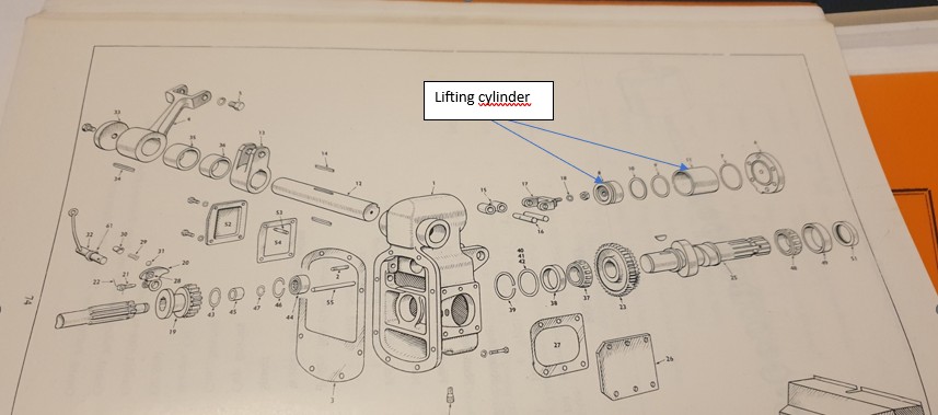

I have just completed my collection of small Allis Chalmers with a D272 model built in England.

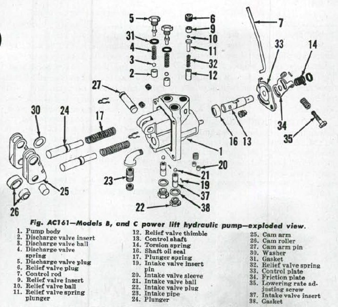

When restarting, the hydraulic system is very weak. I only lift 300kg. After dismantling the hydraulic pump, the relief spring is broken. After changing it, I measure a pressure of 220 bars.
This pump is the same as on the C model. Same part number and spring. But I have no information on the hydraulic pressure of the D272 model. I do not have a service manual, only the parts manual.

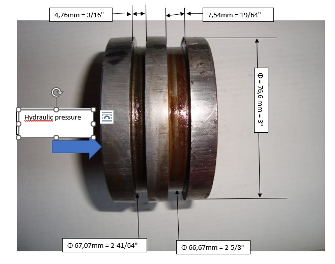

What surprises me is that the integrated cylinder of the D272 measures 76mm in diameter, or 46 cm², which with 220 bars would gives a force of 9.6 tons and provide a lifting capacity of 1.7 tons.
This effort of 9.6 Tons seems very high for this small tractor and for the frame which is the stop for the cylinder. Isn't there a risk of breaking the lifting frame?
Any information or experiences on this subject?

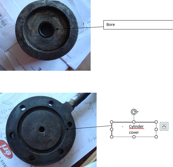

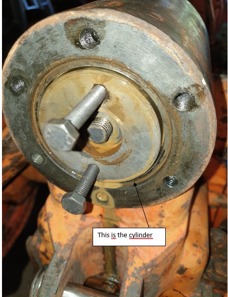

Are you measuring the bore diameter or the rod diameter of the lift cylinder? I don’t think there is piston packing like on most hydraulic cylinders, so it’s the rod area that counts.
John426 View Drop Down
Joined: 14 Aug 2012
Location: France
Points: 310
Post Options Post Options   Thanks (0) Thanks(0)   Quote John426 Quote  Post ReplyReply Direct Link To This Post Posted: 08 Jan 2025 at 10:06am
It is the bore diameter 3" . There is no rod , it is not a standard cylinder.

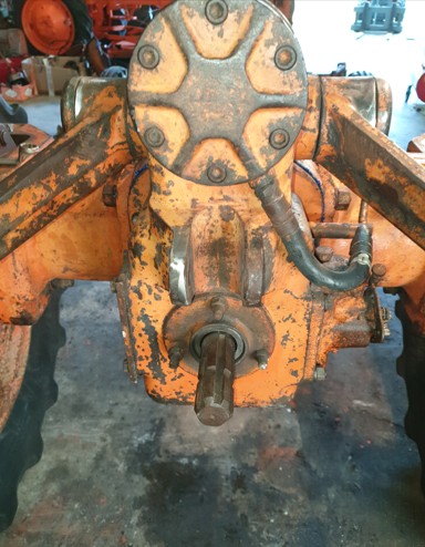

For reference only, here is a Link to a picture of the Rear of a D272:
G
https://www.tamarvintagetractors.co.uk/product-page/allis-chalmers-d-272

220 bars converts to 3190 PSI, if I remember right, CA pump was 3500 PSI max, 4gpm flow rate.  Have you checked the flow rate of the pump?
