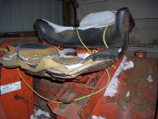

Post Options Post Options   Thanks (0) Thanks(0)   Quote captaindana Quote  Post ReplyReply Direct Link To This Post Posted: 22 Feb 2011 at 11:16am
Hey do y'all think she needs a new seat?

Post Options Post Options   Thanks (0) Thanks(0)   Quote Andrew(southernIL) Quote  Post ReplyReply Direct Link To This Post Posted: 22 Feb 2011 at 11:28am
Just put a old pillow in a burlap or seed corn sack for the cushion sause the back rest is still good so I would finish wearing it out before replacng....lol

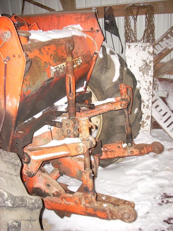

Post Options Post Options   Thanks (0) Thanks(0)   Quote captaindana Quote  Post ReplyReply Direct Link To This Post Posted: 22 Feb 2011 at 6:34pm
Hey y'all here's a shot of the backside! Dana
