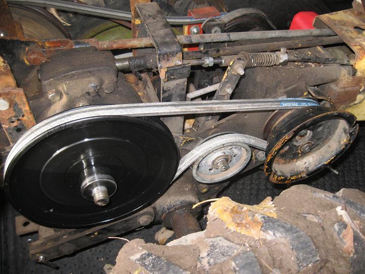

I took the 6 1/2" pulley off the trans and installed a 9" one and a new belt. There is room to put a 10" one on if you like. It doesn't take long to switch back and forth between the stock pulley/belt and the bigger one. A bigger pulley slows down the tractor quite a bit and may be just what you need. Sure slowed down my B-10 for tilling.

With that big pulley on the trans upping the torque, and the tiller hanging off the back, you can't ease off the clutch enough to get rolling without the front end coming off the ground. Kind of funny to see.

There are Simplicity Mfr. numbers for the larger diameter pulley/belt combinations.
The parts are in stock at your local TSC. You can also buy an arbor and separate pulley to sreate your own and weld the two pieces together.
The larger pulleys help a great deal when running the tiller.
