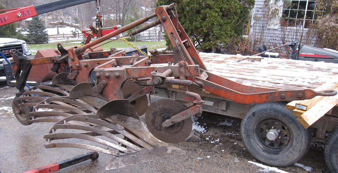

Aaron--I've got a excellent specimen of a field-ready snap coupler  80-series adjustable-width 3-bottom slat plow with spring-trip shanks, fresh coulters and coverboards and hydraulically-controlled transport wheel that I was going to restore but don't have time.

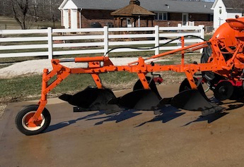

To get an idea what it looks like behind a WD/WD45, the unit's similar to the one Ron Albart sold hereabout this time last year  https://www.allischalmers.com/forum/a-c-w-d-45-3-bottom-plow_topic148806.html -- except that mine has the 80-series frame with spring-trip shanks and slat-board bottoms.
I also have an extra matching bottom plow for spare parts or that could be used to make it into a 4-bottom with the addition of a few additional frame parts.
Here's a pic.  Also has the hydraulic cylinder and hose--just not mounted in the pic.
It's a fairly rare combination as far as I can tell and you could put it to work immediately or get it show-ready fairly easily.
