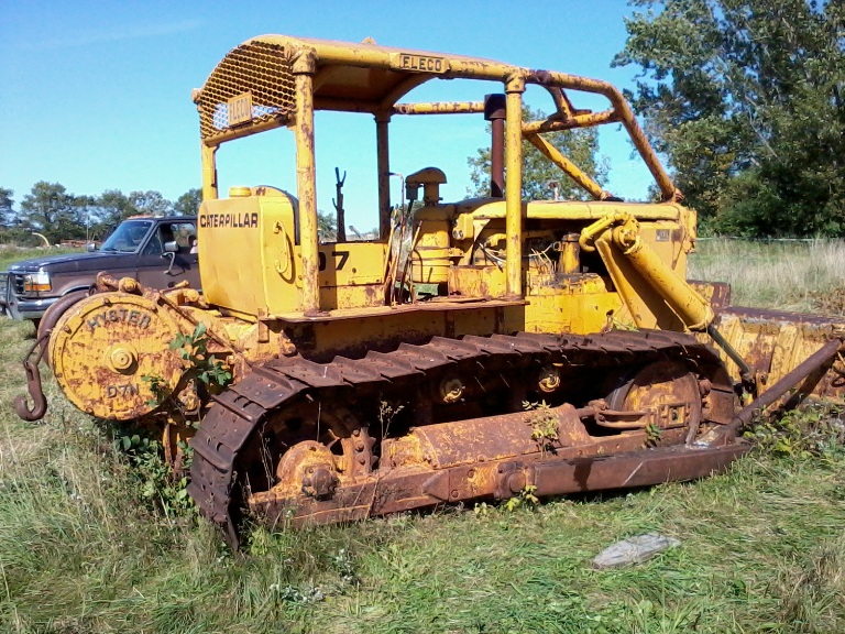

Your looking for something like these...
This one is for a TD18 IH.  might have to fabricate the drive for it... and possibly the mounts. $1400 bucks...
http://www.ebay.com/itm/TD18-INTERNATIONAL-HARVESTER-IH-TD-18-CARCO-WINCH-SHAFT-CONTROLS-MODEL-G-/291787517704
another ad says "
Carco G-80PS Dozer Skidded Winch With Log Arch G-Caterpillar TD20, D7F, D7G HD16 "
This one is a might spendy, 7500 bucks
http://www.ebay.com/itm/Vintage-Carco-Winch-Model-G-80-PS-for-Tractors-TD20-D7F-D7G-HD16-Used-/262268301286?hash=item3d1068afe6:g:cBgAAOSw5dNWrVBW
 The winches are out there, but anything construction is spendy...
Here was a 7 with a Hyster D7N winch...  very stout.
