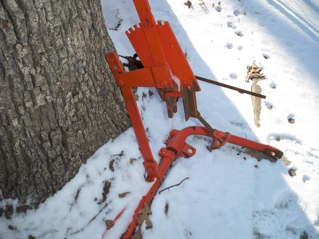

Is this the drawbar and depth adjustment for that plow?
morton(pa) View Drop Down
Location: Lancaster, PA
Points: 1234
Post Options Post Options   Thanks (0) Thanks(0)   Quote morton(pa) Quote  Post ReplyReply Direct Link To This Post Posted: 12 Jan 2011 at 7:21pm
Yes. You need plates that bolt onto the final drives to attach the draw bar though. The drawbar then mounts on those plates with 2 pins.

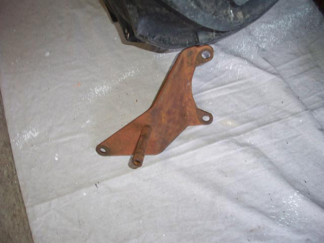

Thanks. I actually do have a couple of plates/mounting brackets that I could not identify, and curious about what they were and how they mounted. One reason that this is so confusing to me is that the guy that I bought the plow and cultivator from bought a Model B, a sickle bar, plow, cultivator and a bunch of miscellaneous parts from an old farmer that made him take everything. We gathered up everything we believed could have gone to the plow and cultivator and loaded it all so I may have some parts that don't go to any equipment that I have. Trying to sort it all out is pretty confusing. I'm starting to believe, though, that I pretty much have everything if these brackets below are the mounting brackets for this plow....

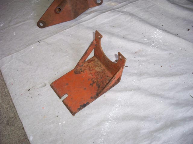

Here's the photo of those two brackets. The top bracket is partially cut off in the photo.

Post Options Post Options   Thanks (0) Thanks(0)   Quote rickwsomd Quote  Post ReplyReply Direct Link To This Post Posted: 12 Jan 2011 at 9:20pm
The bracket in the center is the shield for the PTO. Take Care, Rick W.

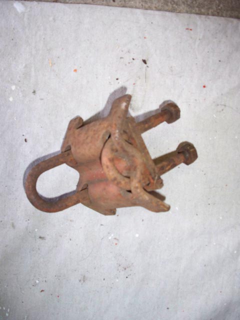

I believe I found the bracket if anyone can verify this is it. The only problem is there is only one of them....
GlenninPA View Drop Down
Location: Ashley, PA
Points: 5054
Post Options Post Options   Thanks (0) Thanks(0)   Quote GlenninPA Quote  Post ReplyReply Direct Link To This Post Posted: 12 Jan 2011 at 10:29pm
That is the bracket to mount the coulter to the beam.

That last bracket looks like a cultivator part, shank to bar.

Dusty, the last bracket is for mounting the coulter shank to the beam on the plow.
 The bracket that is cut off in the first picture kinda looks like the drawbar mounting bracket, can't tell and I don't have pictures of mine.

It would be interesting to compare part numbers. I've got several clamps that look just that for the cultivators for the G.
Now I'm trying to remember how the colter is fastened to the G plow.

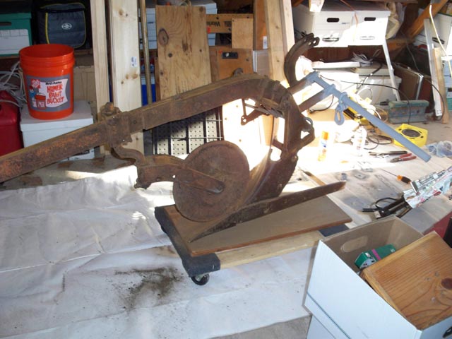

Here's a picture of my plow for reference. Overall it is in pretty good shape. Just a few bolts that I have been unable to break loose so far. I am working from the back knocking rust off and starting to prime sections as I go...

Post Options Post Options   Thanks (0) Thanks(0)   Quote GlenninPA Quote  Post ReplyReply Direct Link To This Post Posted: 13 Jan 2011 at 7:41pm
That is an earlier plow for the B. Not the most common one. The brackets for the round plow drawbar are different than the brackets for the later one, which is made of rectangular stock and a round bar.
I have the brackets for the same plow you have, but they are snowed under, and I will probably not see them until spring..... Sorry that I did not take pictures when it was warmer out...  :<(

Post Options Post Options   Thanks (0) Thanks(0)   Quote Chalmersbob Quote  Post ReplyReply Direct Link To This Post Posted: 13 Jan 2011 at 8:58pm
