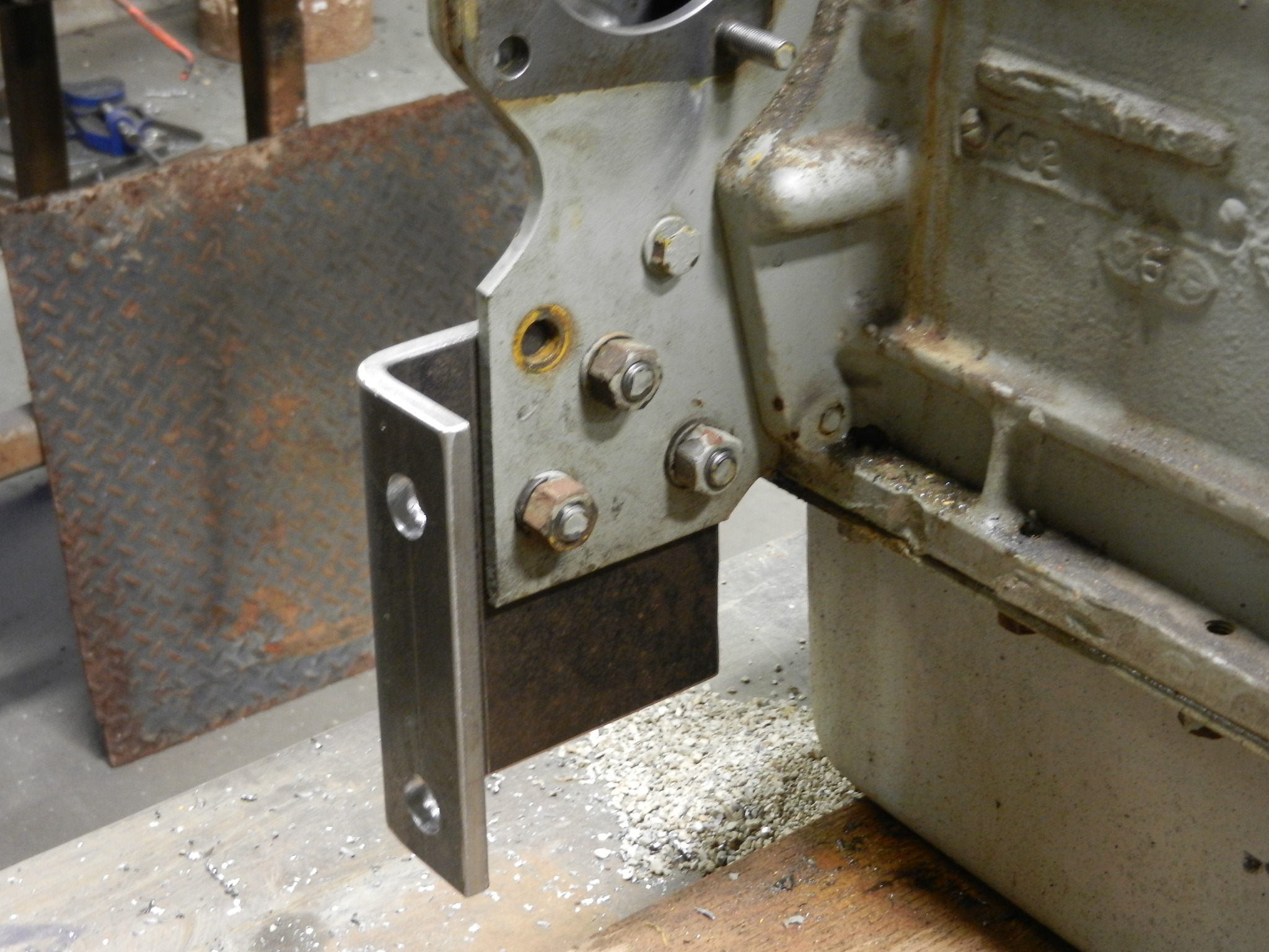

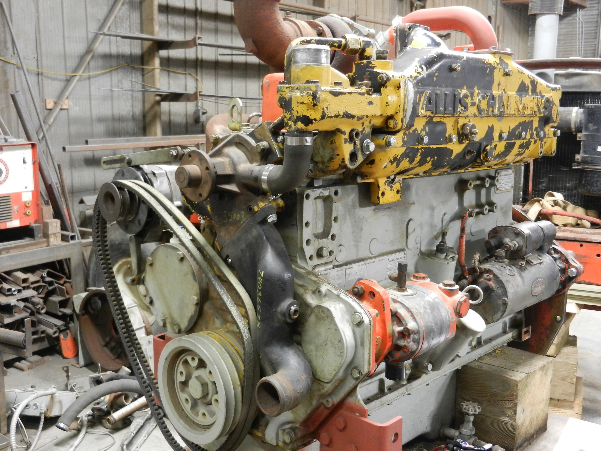

A few pictures that might help. 3500 MK II On Highway spec engine going into a 220.
I added the intercooler so had to move the lower rad inlet and swap sides with alternator.
This engine also had the cover plate and the hydraulic will bolt up.

So looking at Calvin's project I'm kind of beginning to think maybe this is an 3500 instead of a 3700 since my motor has the tag in the same place,not sure if that means anything,lower radiator and alternator bracket too,so like I said not an over night project but very doable.

Then this motor I bought is a 3700.It has the cooler on it like the
one on Calvin's.
Might ask Calvin what pump that is on his,I LIKE IT!!!!!.

My 3500 MK II was on a standby waterpump. It showed 82 hrs total. This injection pump has been great so far but I've heard lots of negative comments with it on combine engines.  Starts good. .048 injector tips. It came with the small water pump and no intercooler. I added the intercooler and big water pump. Stock injector pump setting and dynos 190 hp.
