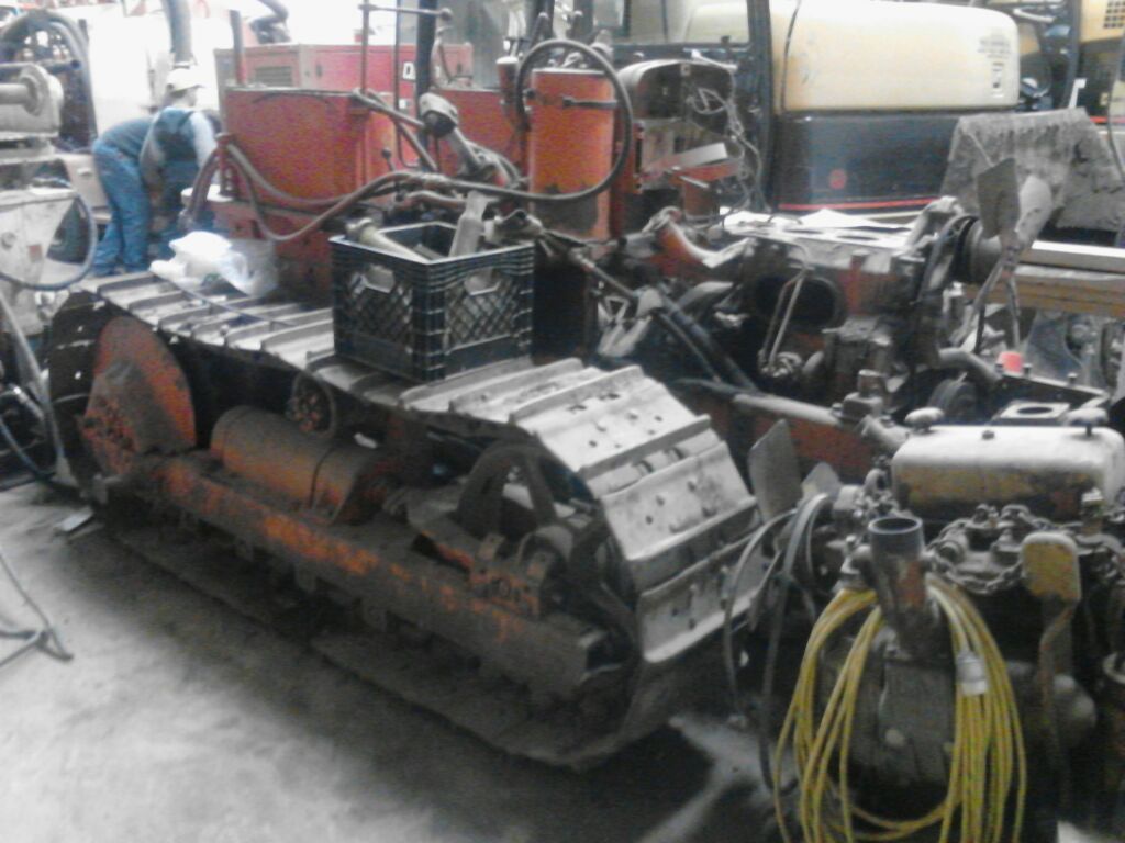

Well I bought it. It is the 253 (figure 8 on the sleeves) so low horsepower. He's even gonna help me swap engines and get it running, plus deliver it. Can't beat a deal like that. Helps that wife's dad and couple of brother in laws worked for them over the years.
Couple pics I snapped tonight.

Post Options Post Options   Thanks (0) Thanks(0)   Quote JohnCO Quote  Post ReplyReply Direct Link To This Post Posted: 24 Dec 2015 at 1:49am
Looks like a nice project - Some assembly required.

Post Options Post Options   Thanks (0) Thanks(0)   Quote truckerfarmer Quote  Post ReplyReply Direct Link To This Post Posted: 24 Dec 2015 at 6:34am
Yeah, John, you could say that. It's in a LOT of pieces right now.
