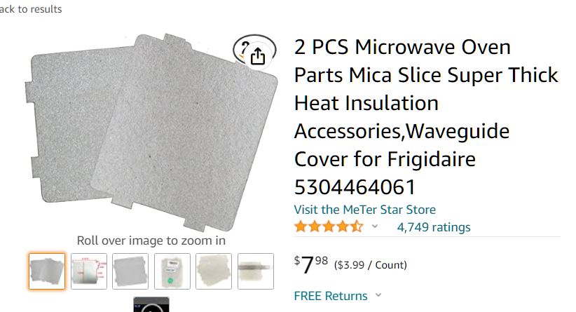

open the door and look inside.. You will see a "mica" plate about 4 x 4 inches... The MAGIC is behind that and the "mica" lets the "microwaves" into the box... If the MICA gets a thin layer of grease on it, it will not work as good, or at all...
You will NOT SEE the grease on the mica... For a test, take the mica plate off and then try to cook a cup of water.. If it works GREAT, you need a new mica plate... if it still does not work, then its INTERNAL as the guys said and time for a  new microwave.
You can buy the mica plates on AMAZON for a few bucks.. Sometimes they are generic and you cut to size with  snips.
Points: 90811
Post Options Post Options   Thanks (0) Thanks(0)   Quote steve(ill) Quote  Post ReplyReply Direct Link To This Post Posted: 02 Mar 2023 at 9:57am
you can also scrub the mica plate with dish wash soap and clean... but i would buy NEW.

  IT WORKS!! STEVE,,,,IT WORKS!!!!!!!!!ClapClap
  UMMmmm,,,do you have charge accounts,,,,,!!
 Many Thanks, Steve, I left that little plate out and it works like new, will boil a cup of water again in 45 seconds. Cleaned the plate good but am gonna order new ones as it had a spot in center where it looked like it got mighty HOT,,,!! THANKS!!

Post Options Post Options   Thanks (0) Thanks(0)   Quote Les Kerf Quote  Post ReplyReply Direct Link To This Post Posted: 03 Mar 2023 at 5:37am
I had no idea that those mica plates were so readily available, thank you Steve!  Cool
