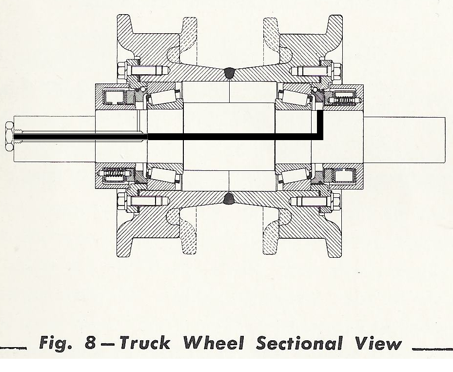

Some used a plug at the end of shaft and put a tube in that screwed inside the shaft and pumped oil in until it flowed clean around the tube...

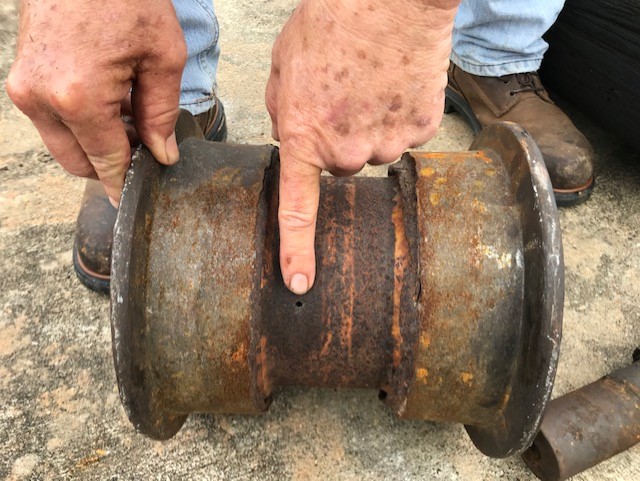

First picture shows the space between the bearing races of a dismantled roller

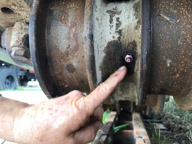

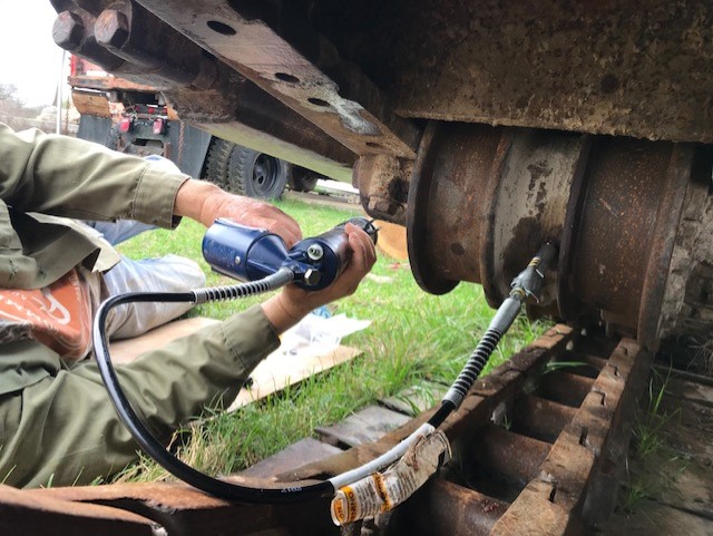

Post Options Post Options   Thanks (0) Thanks(0)   Quote scooper Quote  Post ReplyReply Direct Link To This Post Posted: 18 Jan 2020 at 9:41pm
I will try to post sequential pictures
first picture shows area between bearing races on a dismantled roller

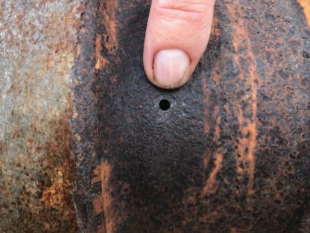

second picture shows where I drilled hole for grease fitting this can be done with roller still on machine

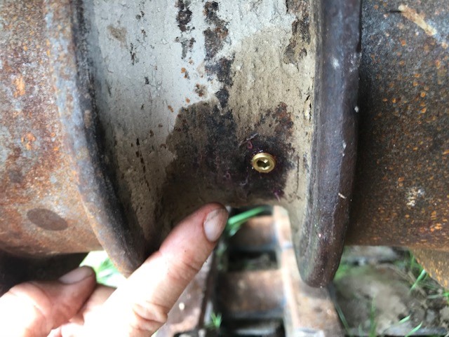

I drilled and tapped for a grease fitting on a non contact portion of the roller

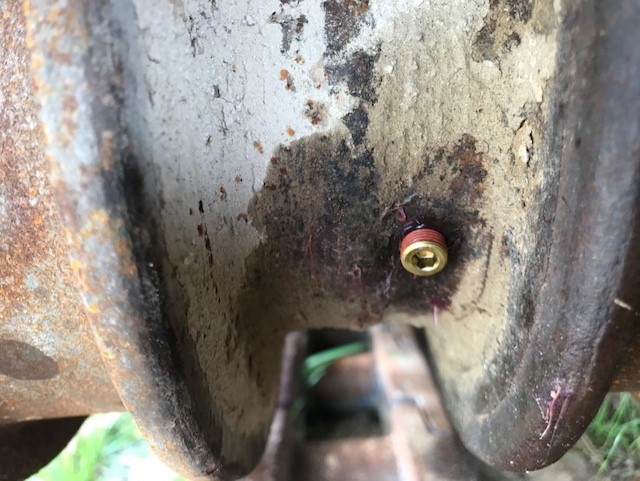

Used pneumatic grease gun 1 and 1/2 tubes of grease

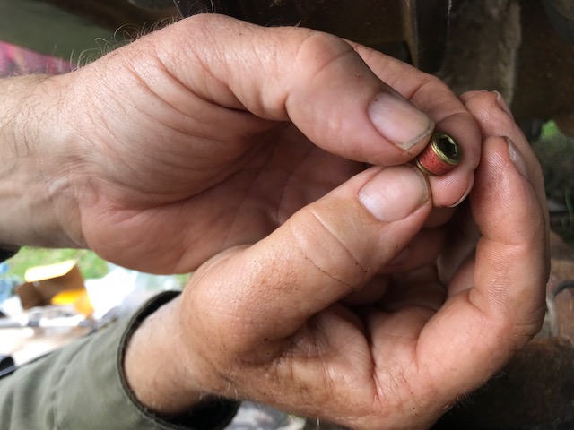

Removed grease fitting
Sealed with socket type pipe plug
