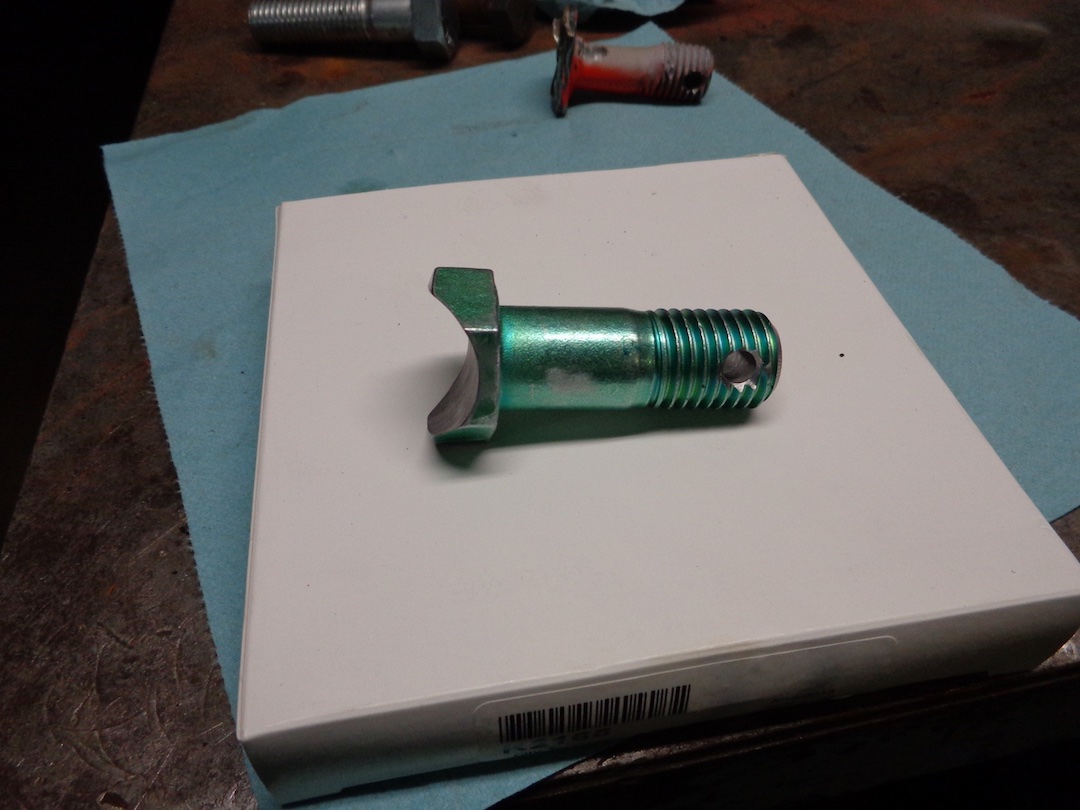

Nothing more than a 7/8" square head bolt with a hole drilled through it. Just measure the length of the worn out bolt you now have a replace it.

While Paul is correct, if you want it to fit you need to machine a radius into the head of the bolt. I did this on my Wide Front 45. I'll ;look and see if I can find the thread and if the pictures are still there.
Edit; No luck finding that picture, found the thread it would have been in but many pictures missing due to the file manager. Can't even find it on the computer???
Found it!
