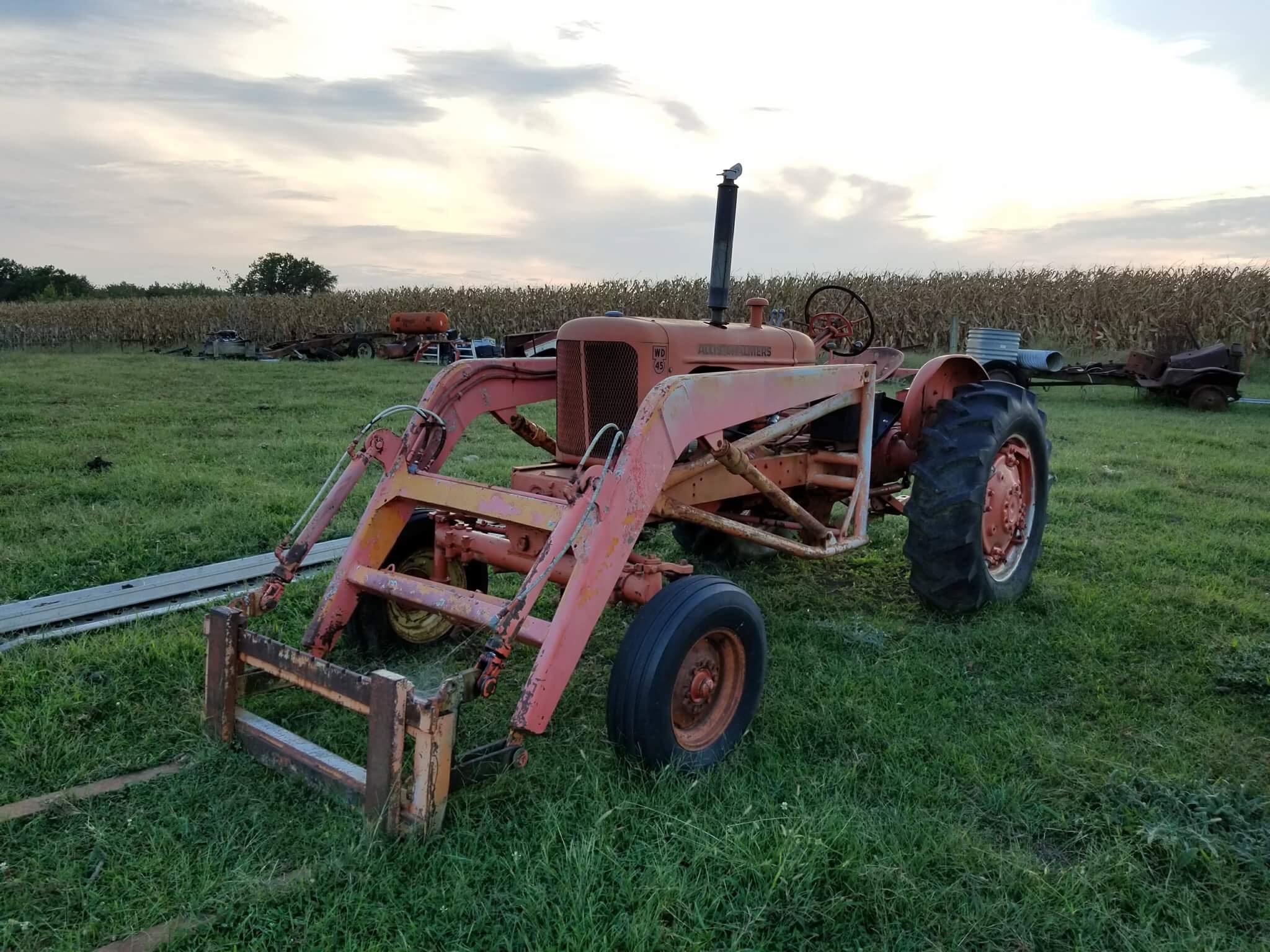

I’ll post this image and see if it is viewable for everyone.
I have agreed to purchase this tractor and loader. Aparantly the loader hydraulics also operate the power steering for the tractor. The previous owner said it was parked because the priority valve to the power steering was not working. It set for five years and the motor is locked.
I’m buying the loader and the tractor is extra to me. Anyone have an idea if this loader is an Allis? Model?
Thanks!
If the pic works out I’ll post more.

Here are more pictures. Hopefully someone can ID it better with these.

Appears to be a modified modle 109 loader.

It is the depth stop attachment for the WD rear scraper blade. I'll buy it if you want to sell it. Look on the left side bottom of the loader mount in front of the bottom of the reservoir and see if the aluminum tag is still there. Loader looks like a Model 90. I have one on my WD45. Yours has been modified from stock to have the front cylinders and controls. It also has an aftermarket wide front end under it, a Schwartz perhaps.

I agree with rusty.
Loader started its life as a Model 90 - a box frame Boom and Tube Frame on the tractor.
You can see the remains of the trip bucket latch lever.
Some one has added the 2 hydraulic bucket cylinders.

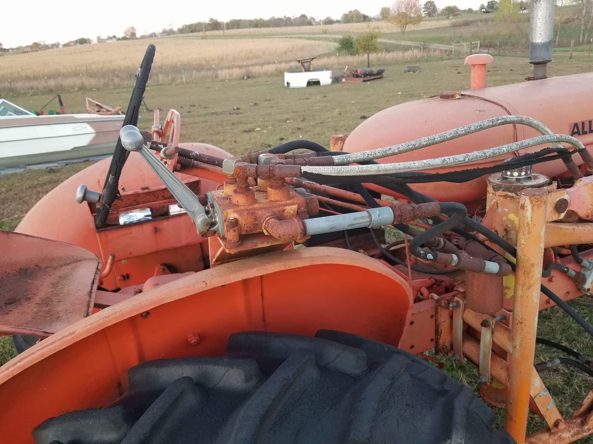

So the power steering is home made? Or the hydraulics are adapted to the loader hydraulics instead of the set up that came with the WD45 power steering? After posting and looking again at the pictures, I also cant see where the pump for the loader is.
My plan is to install the loader on a working WD45 with power steering. Is it possible this loader is using the power steering pump to power the loader also?

I cannot tell from the pictures where the pump is, but the power steering  looks to be aftermarket.

They may have installed a 'diverter valve' in the hyd. pressure line going to the rear lift cylinders.
One line would go to the rear cylinders.
The other would go to the 2 loader valves on the R/H fender.
That way you use either just the loader, or just the rear lift.
Need to leave the original 'lift lever' in the Up position.
