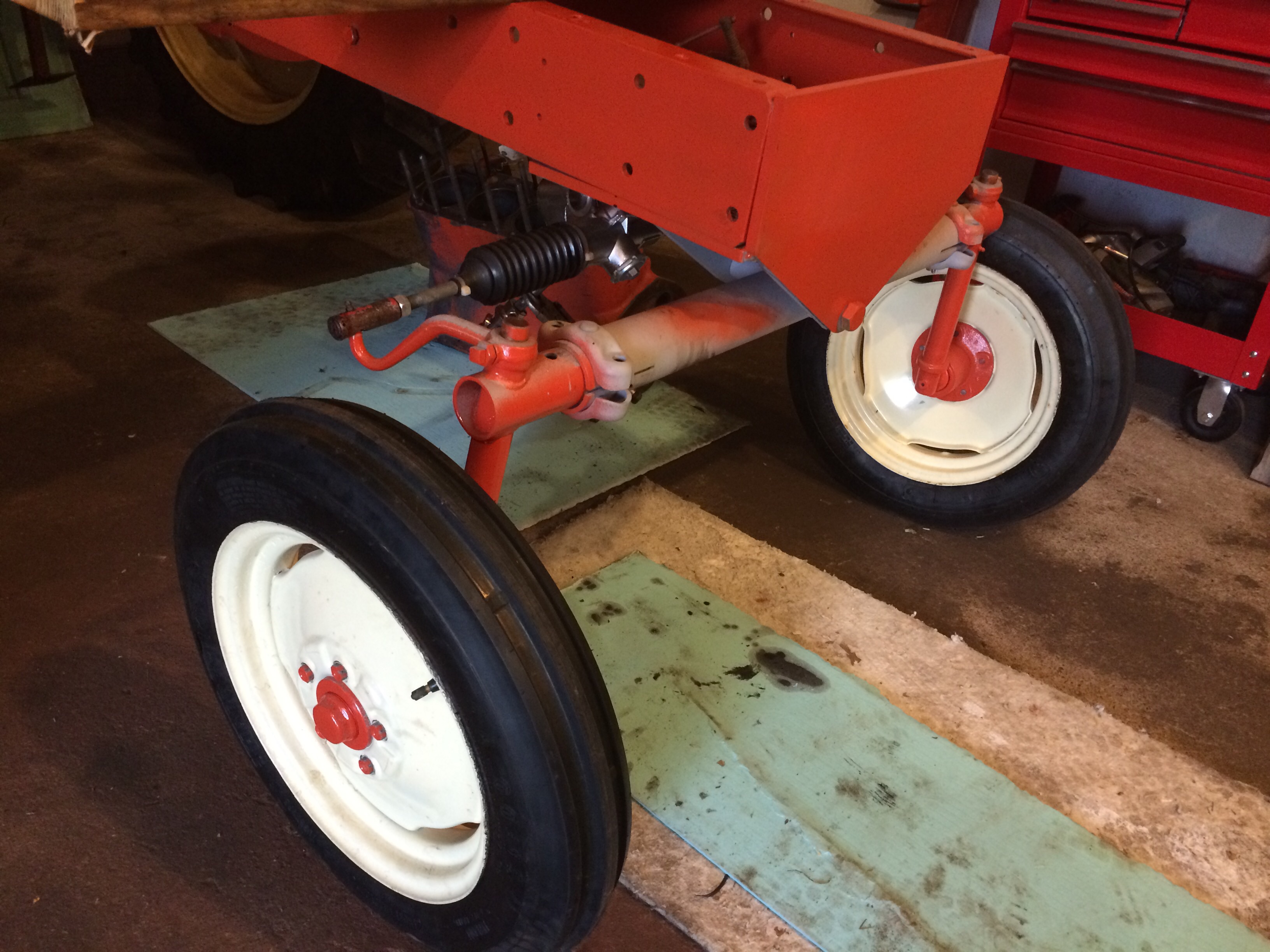

Does some have plans for a light weight wide front end for a ac wd puller

In the process of putting a farmall cub front end on with a pinto rack and pinion.

I put a B front end under my WD45D. I used a gearbox from a 63 Corvair

I need pictures or plans for a lightweight wide front for wd.I am going to use a rack & pinion steering

I have more pics but it won't let me upload more, I can text you more pics if u needed them

What year pinto did you use

It was one off eBay, the chrome 74-78 manual steering, it was $79
