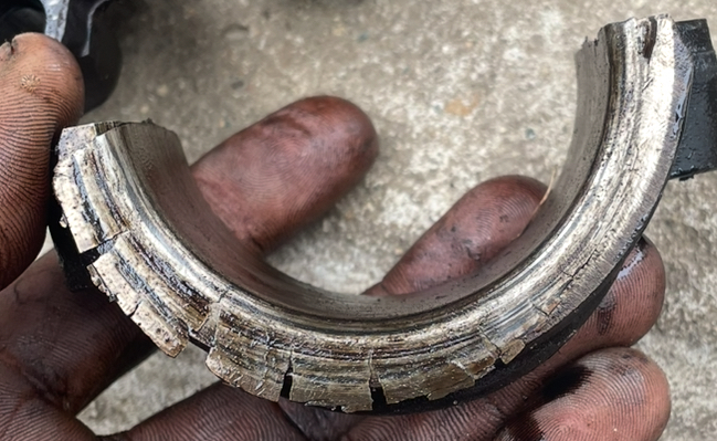

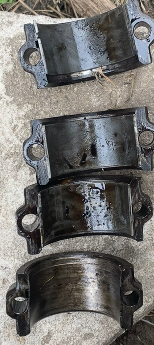

Post Options Post Options   Thanks (0) Thanks(0)   Quote 55allis Quote  Post ReplyReply Direct Link To This Post Posted: 31 minutes ago at 12:02pm
Got the oil pan off today and figured out why it was parked, it had spun a rod bearing…
