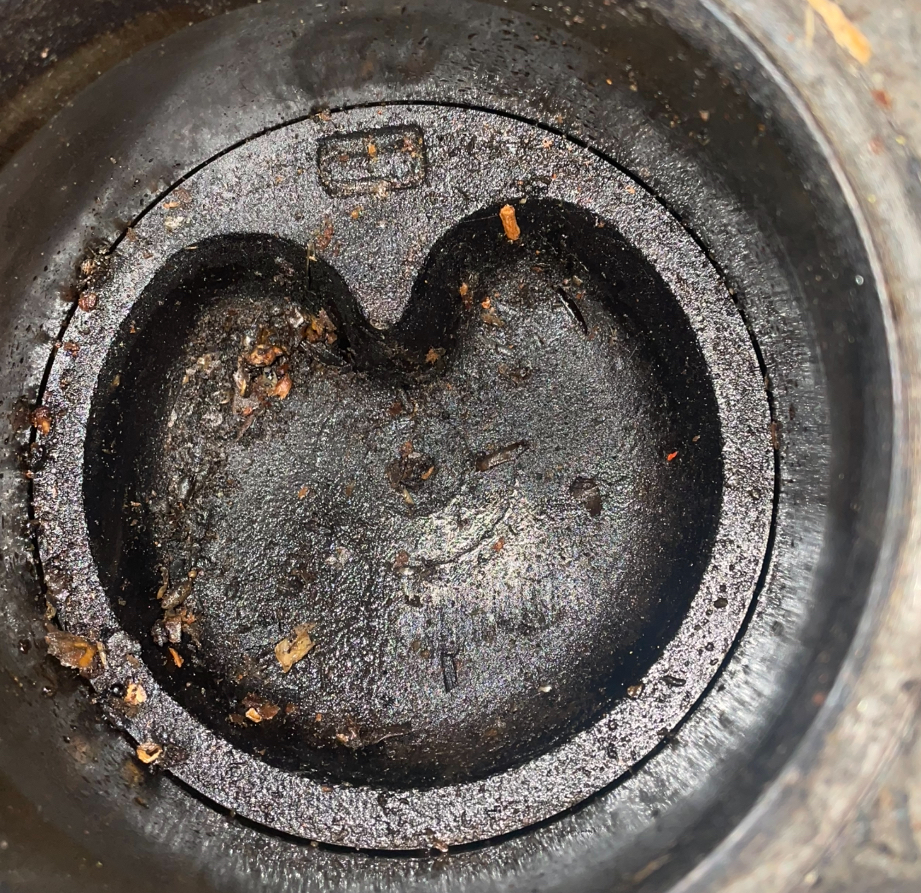

Here’s a picture of the piston in it.

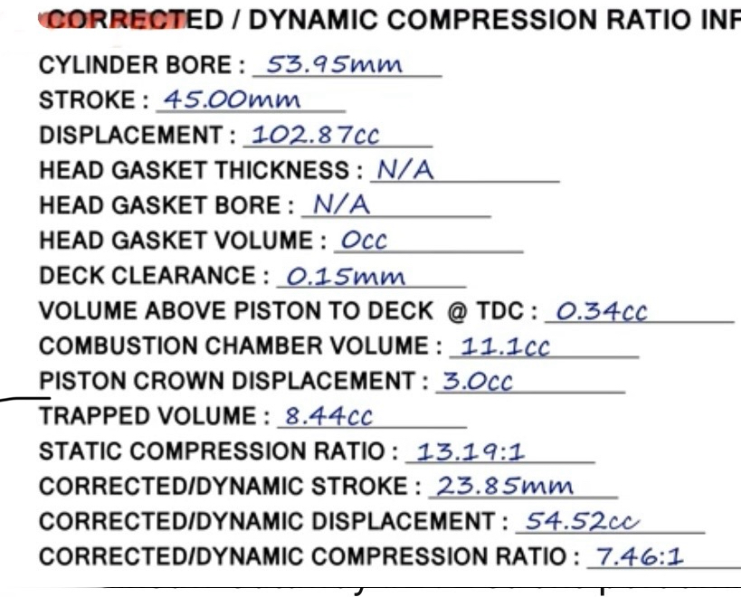

Also surfed the web and found this chart for a single cylinder.

That piston looks just like the hoof on my Norwegian Fjord Horse's foot! LOL
Head gasket thickness and bore N/A? (Not Applicable/Not Available?) It is a pretty important factor there methinks Confused

It’s just an example, not for this engine.
I was going to erase what is written on it and change it to the 226 engine.

That is an M & W piston.  SP-48 was the kit p/n. Compression ratio was 7.5 to 1, just a little more than a std D-17 at 7.25 to 1. They were a 4 HP gain in a D-17 tractor.    My research on the SK156 flat top kit makes me call it maybe almost 10 to 1 compression. A call to someone who sells them could give you the correct compression ratio number. 10 to 1 (210 psi cranking compression) will require 93 octane gas at a minimum and you wouldn't farm with it.
